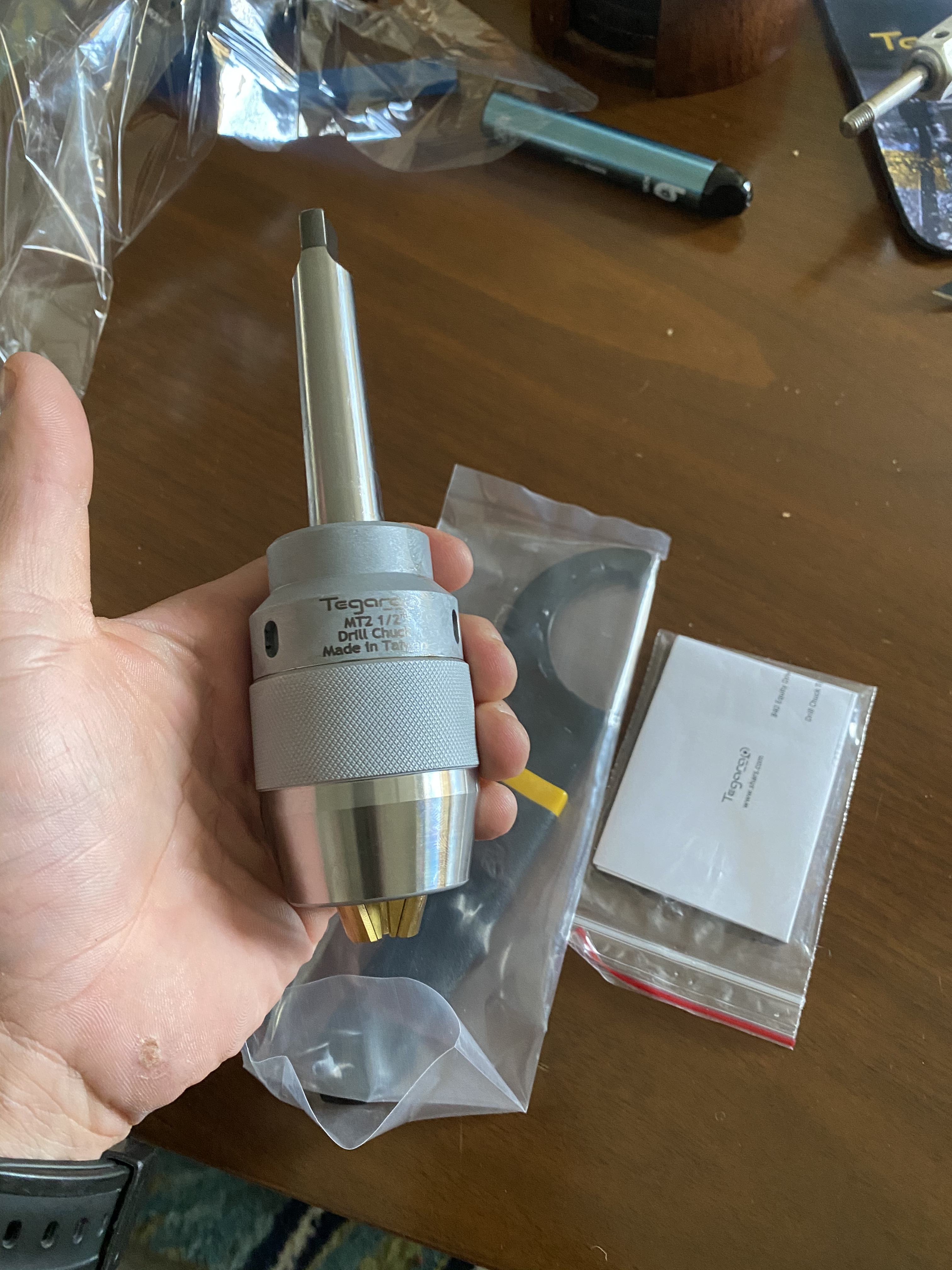

Machinists! I know I should not attempt milling operations on my drill press.
But what if I have a chuck with an integrated Morse taper?
Which connection makes lateral loads on a drill press dangerous? The Jacobs or the Morse?
Mine has no Jacobs.

Both, but morse is much less bad than jacobs due to the shallower taper and larger engagement area.
Some milling machines even use morse taper tooling, but almost always with a drawbar to prevent tools from pulling out.
Cool. I suspected as much.
I’m not an engineer, but Jacobs taper just looks stupid. No?
