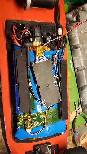

Something else to consider is two of these will take up a bunch of room dude…
I wish I had some better images. But if you are right in space these may make it harder.
Looks huge, I guess I was a little too optimistic when I saw the measurements on flipsky website! Thanks for the pics, helps a ton to get a better idea of scale!
