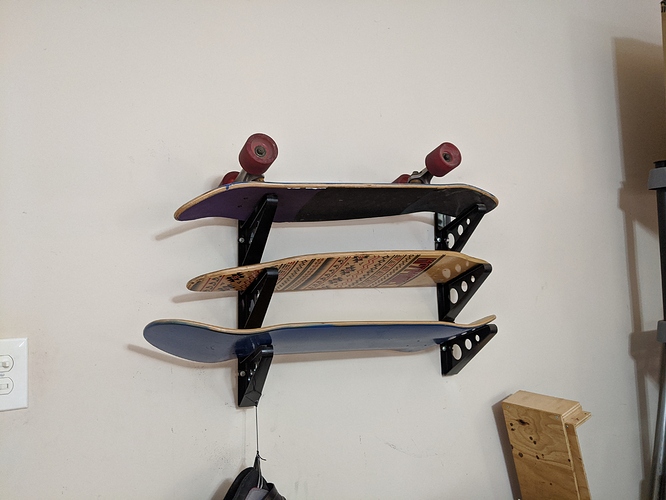

Any ideas to make a vertical stand for e-mtb (trampa) for storage?
Could make a little 3d printed thing to hold the wheels and kingpin on the trucks, but have also heard of others using guitar holder/hook to hang them from the wall. Personally just lean mine up against the wall and accept that I have to clean that wall every few months to keep it from looking really bad.
Could also get one of these skate rack things but looks a little jank (probably won’t put this up at new place or will be in basement, but it’s an option)
