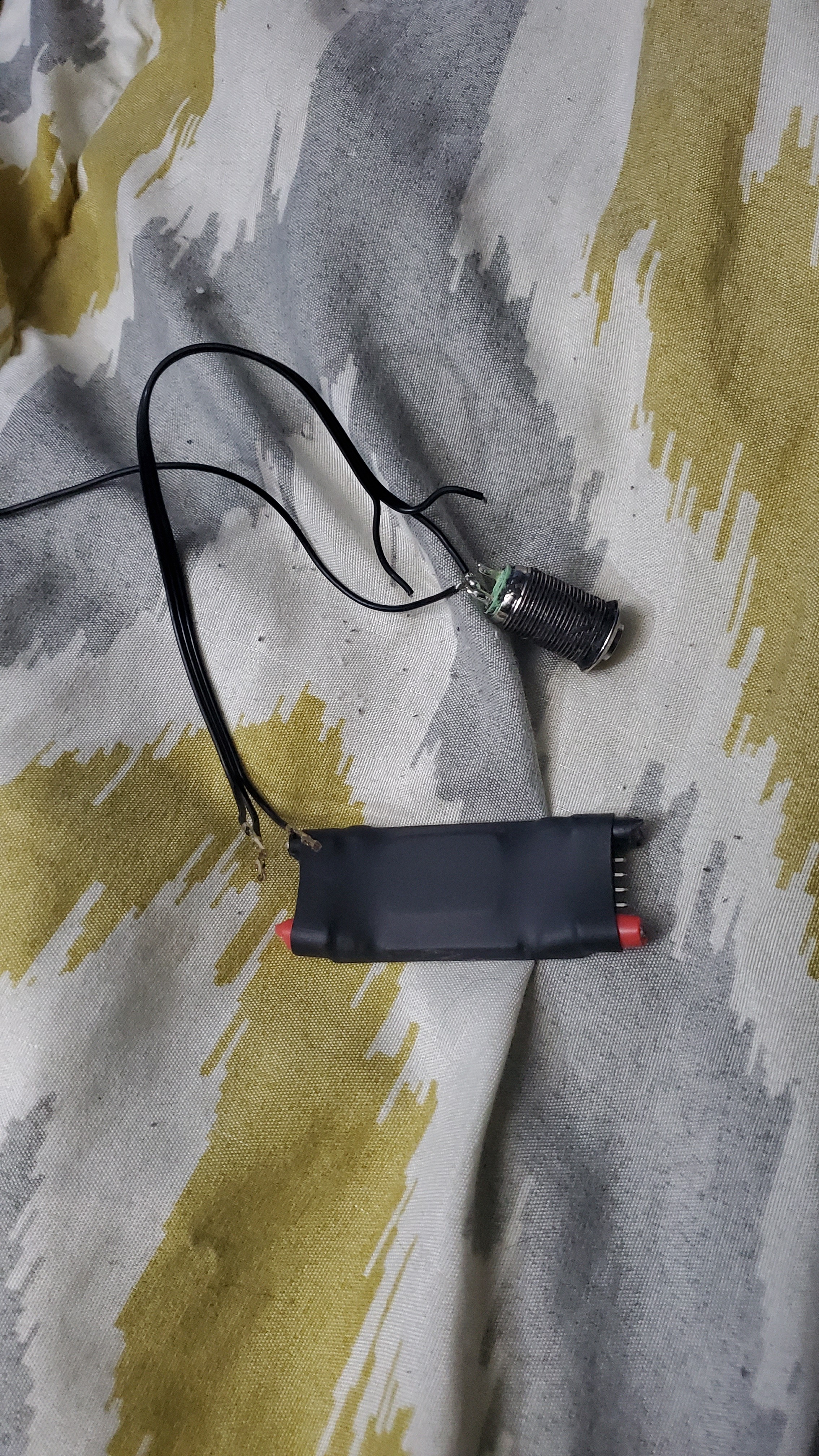

Looks like I’m joining the Anti spark XT 90s club.
My skateboard is so compact, it broke the switch itself.
Dude what the hell did you do :joy:
