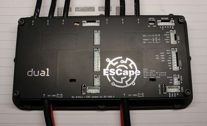

What ever happened the ESCape ESC’s they were the the ducks nuts v6s where did they go. Are the Gerber files around?
