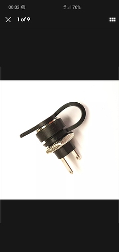

I’m looking for the female part of a dc jack that i can panel mount, but with one twist: i need it as flush as possible on the inside.
Basically i fucced up, my trampa vescs finally got back from repairs, i’m upgrading the maker-x esc to them, but the charging port sticking out doesn’t let one of the vescs fit in.
I don’t want to drill another hole if i can spare it.
Any ideas? It can stick out on the exterior
Make a 3d printed extender of sorts? Basically mount the jack to it, then glue it to the enclosure, over the existing hole?
Personally I’d just fill in the existing hole and drill a new one in a better location, but that’s just me.
No 3d printer :confused:
I was thinking to drill it in the deck, but that’s just asking for water to get inside. Or just fukkit and glue an xt30, seal up the hole with the wires through
3d printing services are a thing, and for small simple parts they’re pretty reasonable.
Hell, I’ll even offer the use of my printer, for the cost of shipping and filament used.
Last time i tried a printing service, same city based too, it took 2 months to deliver and took £65 for what i can only call terrible.
I appreciate your offer. I may call for it if easier alternatives fail
Epoxy is the answer you are looking for
See this for inspiration
Just make an external charge jack, maybe turn it 90 degrees so it’s next to the enclosure but on the outside, buried in a tiny mountain of epoxy
I might end up making a “cone” out of jb-weld if this port doesn’t work:
Description claims 13mm clearance needed. With bent pins it might juuuust work
Don’t push your luck, heavy vibration rearranges stuff
But hopefully you get it to work :+1:
And don’t forget the fuse
what’s the amp rating on that plastic jack port?
3 amps. I’ll run it at 4 and see what happens
then I’d for sure add a fuse like @b264 suggested !!!
