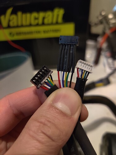

Is it just me or are the green and yellow not supposed to be flipped? Or maybe it doesnt matter?
The left two are a sensor adapter from TB, the right connector is from a TB motor.
Anyone used both Flipsky TFT V2 and Davega X who can tell me whether it’s worth shelling out the extra $$$s?
The usual layout (red: +5v black:gnd wht:temp blu/grn/ylw:halls) doesn’t care about the order of the hall sensors really at all, at least with VESC and derivatives. Some ebike controllers do want a specific phase/hall order though.
Oh good to know I was worried these would cause trouble with my vesc but it detects the correct layout itself? (how does it do that?!)
Or do I have to know the pinout of the motor and configure/set up the pins accordingly in the vesc software manually?

The power, ground and temperature sensor have to be in the right place, but the halls can be in any order.
During motor detection, the vesc drives the motor in sensorless mode, and while the motor is spinning it reads the signals from the hall sensors, then does some math to basically figure out the relationship between the motor rotation and the hall sensor signals, and saves that information.
