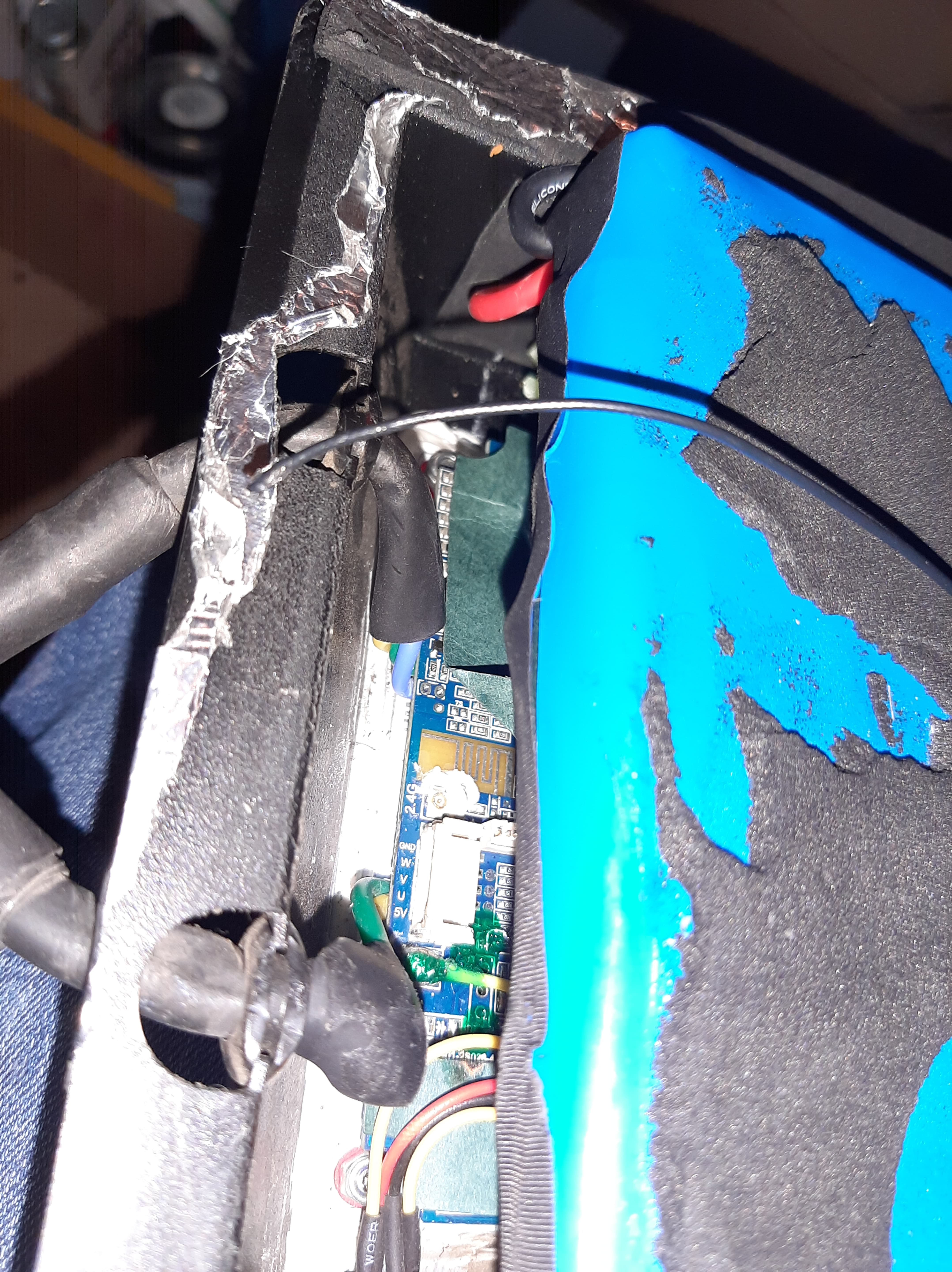

@MysticalDork , Can i solder this antenna back to it’s connection point? I have no idea what esc/board this is, guessing old lingy
Pics?
Sorry, was editing

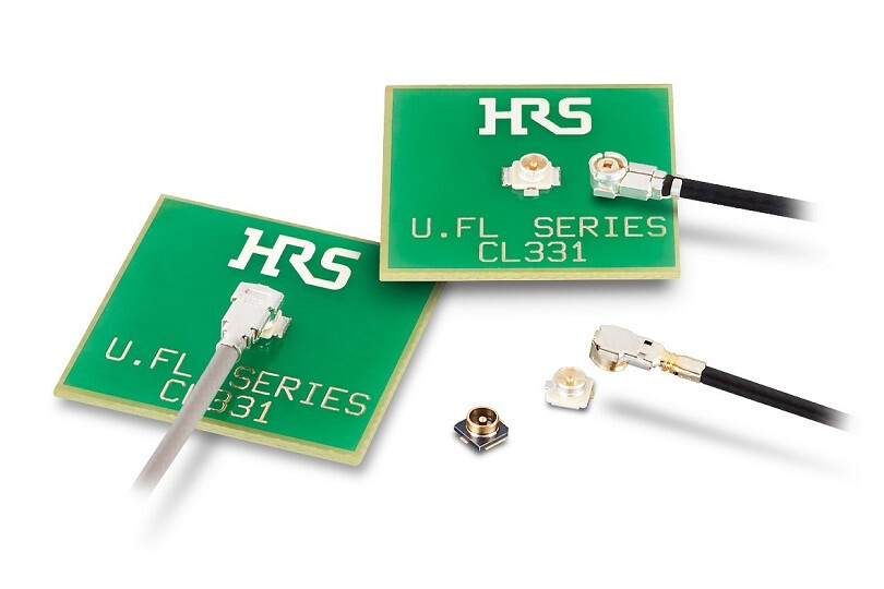

No worries. It looks like the connector on the PCB is still intact, so if possible I’d recommend trying to reconnect that. If not, you may be able to desolder the connector and solder the antenna coax to the pads directly - just keep in mind that it’s a coaxial cable with two conductors, and they must stay electrically separated. The middle conductor carries the actual signal, and the outer sheath is ground.
Hmmm, good to know, thank you!
Keeping them separate while soldering seems above my pay scale. Ill inspect the connection tomorrow, just got a quick glance tonight.
I assume its a presfit connector whut adhesives for strain relief?
As soon as my buddy showed it to me, i knew who i had to ask :slightly_smiling_face:
Yeah, probably. Those little micro-coax connectors are almost always just a snap fit, like a little lego.
Awesome, thank you. With how they have the end attached to the battery, I assume many get ripped out
Yeah, I’d recommend moving the active end (the actual antenna bit) away from the metal battery if possible, to improve the signal.
If the connector on the cable isn’t intact, you can get replacement connectors cheaply online, or salvage one from a dead laptop.
