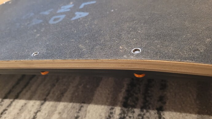

My flex deck has through bolts though. I only use #2 on a stiff deck, but I’m sure they’d be perfectly fine on a flexy one.

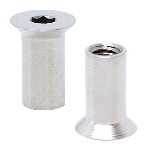

I use the m4’s of these when i skin a deck. Sand the barrel to give epoxy a bit more grab. Im sure it’d be fine with griptape too. Spendy, but nice and no worries of pulling out

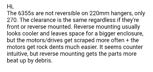

i was emailing boardnamics about mounting their gear drives in reverse. he said reverse mount is more likely to get hit by rocks :exploding_head:. not in my experience. any thoughts?
I have mine mounted out the rear and the bottoms have had all of the paint beaten off by rocks
after about 1500km mind you

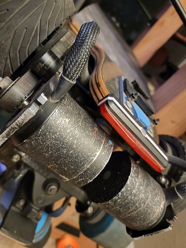

Reverse mounted motors get destroyed at least twice as much as forwards in my experience.
In fact, forwards mounted motors, in my experience stay mostly untouched, while reverse, end up looking like this:
It’s weird, but it’s just how it goes. Of course, if they’re on a mountainboard they’re very far from the ground so that doesn’t count.
If you want your motors to stay pretty, forwards mount them like he says. In addition, yes, more likely to have baseplate issues if you try to reverse mount those street drives
Forward mount is shielded by the enclosure. Backward mount is directly lined up with where the wheels will kick debris. But which is better entirely depends on the build. For shorter boards, backward mount is superior as it leaves you more enclosure room. For longer boards, it makes more sense to forward mount, since you aren’t shopping for space. But that isn’t the only balance you’re playing with. Forward mount generally offers less height clearance than backward. And backward offers more available mount length, which is easier to deal with.
So, with all that accounted for, forward mount is generally safer, besides clearance height, but backward leaves you a lot more to work with otherwise. If space constraints are for any reason a concern, backward is better. Otherwise, forward is generally better.
Oh, and if you cage your motors, backward is immediately the absolute winner. That covers all the problems.
BNM1 really needs a cage
It’d need a bit of a rework, or a pressfit cage. I don’t trust the idea of a pressfit cage, and I don’t mind some shredded cans anyways, I consider them an inevitability.
Know what? When I finish this build I’ll nano ceramic coat the living hell out of these motors, as much as I can manage without opening a new bottle. It shouldn’t affect thermals enough to do any damage… hopefully. And it might provide the equivalent of a nano coated motor cage.
Wait, duhh, this one’s going forward mount lmfao nevermind I’ll make the next shortboard the test rig for that idea xD
