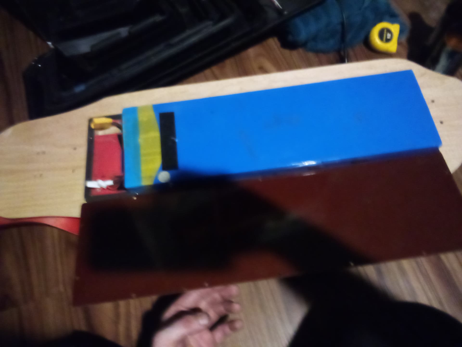

what is the smallest available dual vesc that doesnt suck?
Elaboration now that I charged my phone. Here’s what I’m trying to make happen.
And here are the problems: compartment is 1.5mm~ too narrow for this battery. I can fix that. It’s also 1.5mm~ to shallow. Solvable problems. It’s also 3-4mm~ too short to fit the batt+xenith. I could fix that, but I’d have to make a new lid, and… Meh. So I’m looking for options for a reliable dual//double single vesc, that take up a fair amount less space than this xenith. I understand that it’d be simpler and maybe even cheaper to just get a slightly smaller battery, but frankly, fuck that noise.
Id like to add that I will not be taking questions on the battery, I need to slap a new xt90 on and some new shrink wrap, and I already know that xD

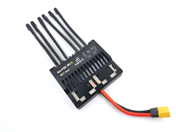

I think the consensus is makerx, it’s VESC 4 but seems like a reasonable option
Thanks, but that takes up more room than a xenith in the direction I need to save space no matter how I rotate it. I’m pretty sure the only way is to make a new lid… little foccer is my last hope. Edit: Yeah little foccer don’t even measure where I need it to. Now to choose a material and supplier for a new lid…
Which honestly is probably the cheapest and easiest option but I don’t like wasting material.
You can also use 2x mini foc from maker X, they are the smallest vescs I’ve seen to date.
that might work actually. ill have to measure more, but its the only one that is less than the 67mm i need to cut down. id rather go that route, i have many other uses for my xeniths.
