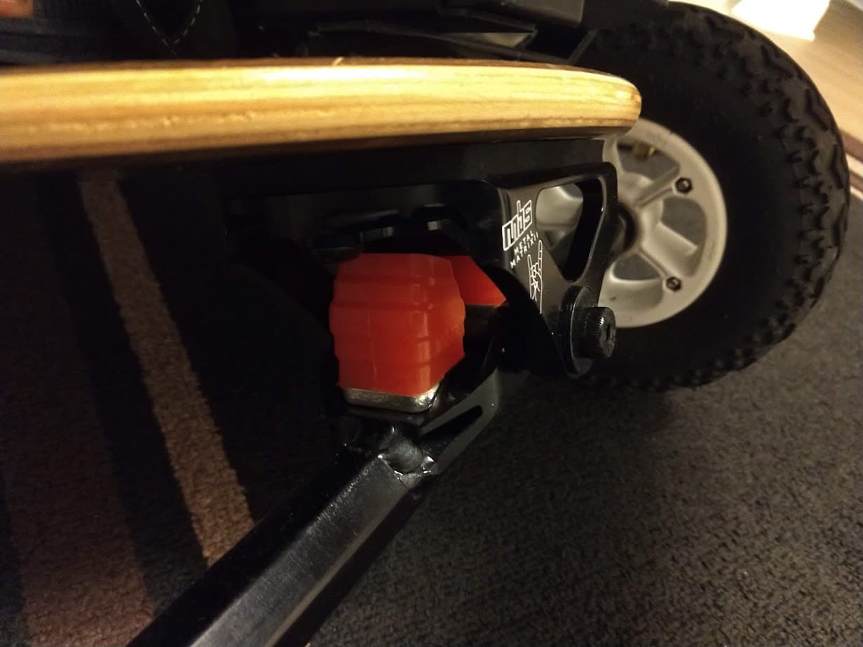

I just had a orange shockblock on my matrix ii rear truck fall out when I went over a big bump is it just held in by a short screw. Does this ever happen or I did something wrong? I don’t have to take the truck off to put it back on right?

Not the first time I’ve heard of this. When I turn all the way the only thing holding the outside bushing in is the tuning peg, and there’s no contact on the top at all. While it hasn’t happened to me yet, it shouldn’t take much for it to come out all the way, and I’ve heard others complain about it.
I put it back on. I just noticed the non top contact too. I put removable blue 242 threadlock on the threads and the little pin part (which goes into the shockblock) above the threads for the shock block screw I’m hoping that it holds it to the screw so it never wants to come out. This was the biggest road #$&@ I’ve ever seen. Basically a small block the size of two hands worth of road was essentially removed from the ground and it was a 2-3 incch deep hole. Ive pretty much never seen anything like that.

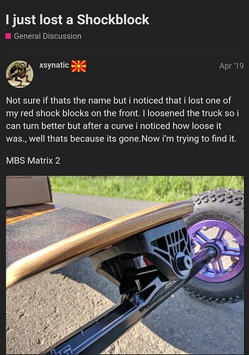

I’ve heard of the hypertruck bushings falling out, but never the og shock blocks :thinking: maybe you just didn’t have the retaining screw in tight enough?

I tightened all 4 shock block till before the shock block base starts rising up from where it sits. Added a lot of removable threadlock 242 as well. I went on a 5km ride after that and it was good :crossed_fingers:

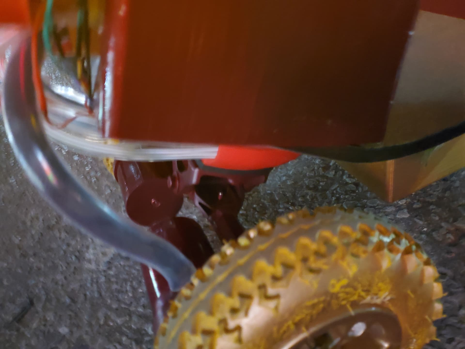

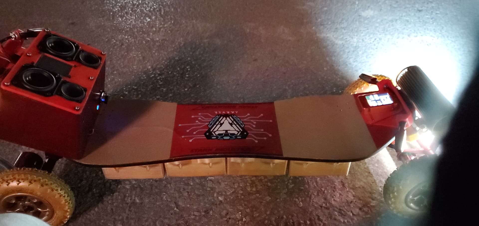

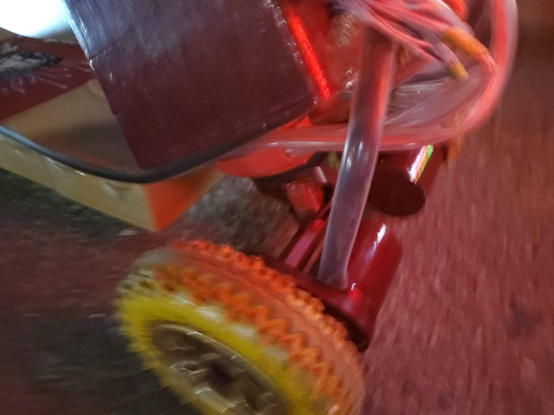

Did my first Footbreaks today and cut a few clips together. Not the best to judge but anything i might do wrong/could be improved?
One thing that was kinda sketch is that my foot was near my rear tire and it hit several times.
You can see the where my foot hit the tire and rubbed on the shoe.
I found it quite difficult to keep my right foot near the the front with the created drag.
