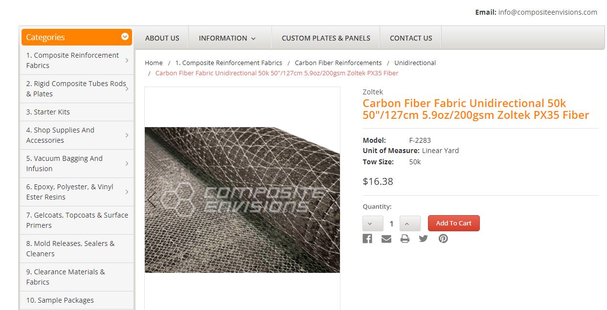

Would this be enough?
Looks pretty good…? Dunno what zoltek p35 means? 50k is pretty intense. The stuff I used was 12k… That place sells good stuff but not cheap for me with shipping
I buy my fabric pretty well only from AliExpress, cos it’s cheap. Just need to order 4-5 weeks in advance
