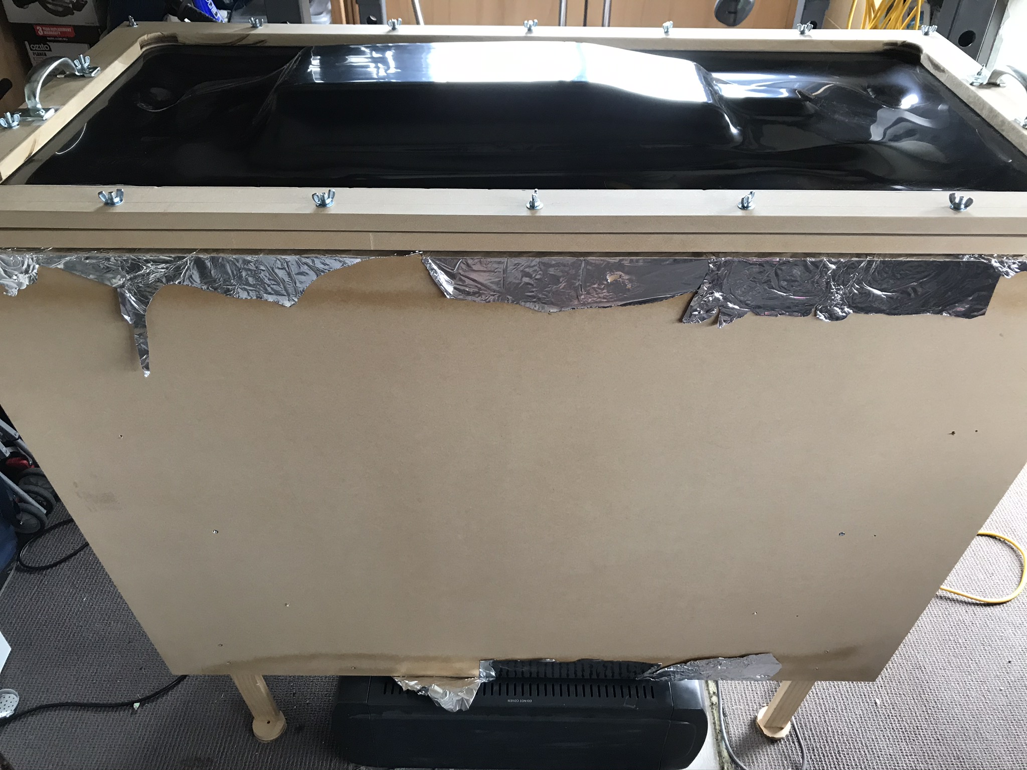

NO! I tried using a heat gun for ABS and it came out horrible. My recommendation is using Fiberglass resin and fiberglass cloth (not a mat) if you’re doing it without heating up ABS in some kind of oven and having a clamp mold to hold it down.

Possible? Yes. Feasible? No.
You really need an oven or other large source of heat to get the whole thing up to temperature at once. I used the kitchen oven and that worked great.
The heat gun is great for small adjustments like fixing a corner or a curve, but you’ll never be able to do the whole thing that way.

You can do it at home but it’s a project.
I followed a web tutorial and made a big wooden box to fit over a heater and melt the plastic. And then put onto a DIY vacuum table. It worked pretty well, but was not cheap (material cost was a couple hundred bux) But works pretty well. I have used a couple times and made moulds for Enclosures with it. I had some sketches somewhere but here’s pics.
Yeah, I went with a MDF positive mold and a harbor freight foam floor mat negative mold.
Screwed the plastic to a frame to prevent warping, shoved the whole thing in the oven, then stuck it between the mold halves and stood on it until it was cool.
I needed to sharpen the corners a bit with a heat gun afterwards where the foam didn’t provide enough pressure, but the final result was pretty decent and I think I spent maybe $40 on materials excluding the 0.080" thick kydex itself.
After working with kydex and ABS and fiberglass I can’t recommend more highly that any noob go directly for fiberglass and skip the heat molding
I wish I’d went straight for fiberglass
