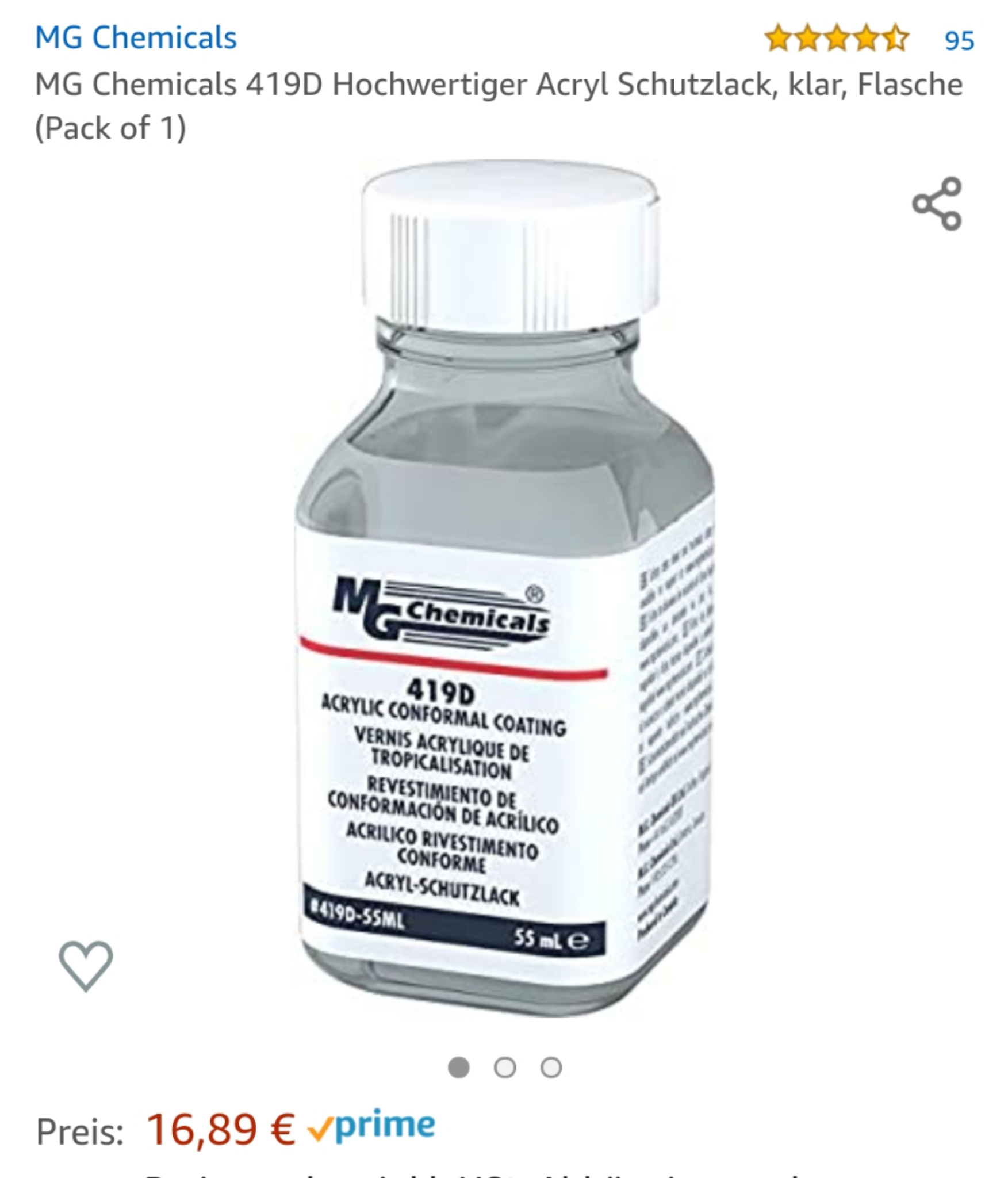

I put a spot for taping in a filter and using carbon filter made for soldering fan in there for now it’s not going to stop water from flowing in but I figured I can just swap back to the sealed case for winter time and just try to avoid deep puddles in the summer and have the filter in there in case I have to deal with a little rain.
Also I use silicone conformal coating on the pcbs in there for the most part so a little splash shouldn’t cause any harm even if it did get inside.
Is this the nail polish like stuff that kind of waterproofs your electronics?
Yup @b264 has some write ups about it but is basically just clear coat that adds layer of rubber over all the electronics I left the mosfets mostly bare of it but basically paint it on like nail polish let dry for like 20min then give a second or third coat, can check where it got with a UV light to make sure all the contacts or metal parts that could rust or short get covered.
https://www.amazon.com/dp/B008O9YIV6/ref=cm_sw_r_cp_apa_i_Gkt7EbD0XH18S
Some stuff you can solder through other stuff varies in different ways.
If using that stuff too just do it in a well ventilated area or outside the fumes seem pretty nasty on the plus side it dries pretty fast.
I actually now prefer the MG Chemicals #419D for electronics and MG Chemicals #4223 for big wires and connectors
and MG Chemicals #4228 for motors unless they’re getting the better battle-hardening treatment
