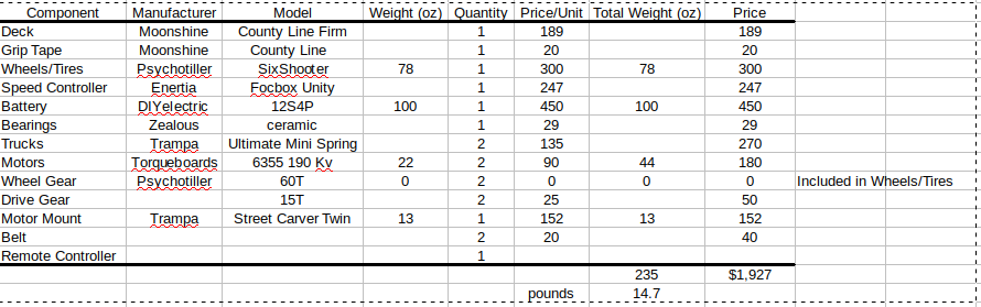

Here is my first guess. I want an ultimate precision carver. Stable at 20-25 mph. That’s plenty fast enough for me. Good range, at least 20 miles. This seems to do that if it all actually works together.

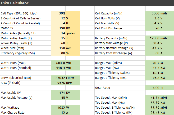

If you want to get 20 miles on numies your going to need a larger battery
Also, make sure you check the axle diameter for the trucks you’re using and get appropriate bearing to fit the 6 shooters. I think they are 12mm axles, but I’m not sure. 6 Shooters uses standard bearings, so 22mm OD.
If you find 12x5x22mm bearing that doesn’t cost 15$/piece, let me know
5mm width? Can you use 7mm width?
7 is better
aliexpress no
alibaba yes
https://www.alibaba.com/showroom/bearing-12x22x5.html
So AFAIK the Moonshine County Line is a standard longboard deck, the TRAMPA mini spring is a channel truck (straight kingpin).
You’d need a 30-35 degree angled riser in order to get those trucks to work on that deck, or choose a MTB style deck that has angled ends. Or, choose RKP/TKP trucks that don’t require an angled mount.
The trucks are the thing on that list I am least certain about. There don’t seem to be many channel trucks out there for DIY. It seems to me the combination of the easily adjusted springs and the dampers should make for a nice consistent bounce back when carving. But I’m just looking at the thing and guessing. I’m pretty happy with the Gullwing Sidewinder type trucks on my Evolve but the engineer in me thinks there has to be a better system than squishing urethane bushings. I’ve read some things about speed wobbles with the Trampa spring trucks but I’m never going to grow the cajones to run at the speed some of you do. Just really unsure about the trucks.
If you are gonna top out at 25, look at Surf Rodz TKP’s, the bushing seat makes them extremely carvey and stable, plus you can dial in the bushings for your ride style, height and weight (IMHO).
https://www.surf-rodz.com/content/tkp-hex-10mm
Full disclosure, 25 MPH is fine for channel trucks as well, I just like the street feel of skate trucks.
Yesterday I ran 12 miles on my Bamboo GTX AT and the battery still showed over half power left. I’m still waiting on my Six Shooters I ordered but in the mean time I replaced the Evolve 50 psi 7" tires with Trampa Urban Treadz 85 psi 6 1/2" tires. I put them on the stock Evolve POS plastic hub with the Evolve stock 7" inner tube so I haven’t had the guts to pump it up to 85 psi yet. Even at 70 psi I am getting probably twice the roll I did before and much better range. That is with 10s4p if I am not mistaken. It also feels more stable on sustained turns with the Urban Treadz. I was able to get closer to balancing the tire/wheel combo with the Treadz. I would have thought another 20% of better cells would get me to 20 miles.
You must be pretty lite to get that kind of watt hour usage.

I see the Seismic Spring trucks come with the angle built into the baseplate. They recommend 30 degree rear and 45 degree front. They are cheap enough to be worth trying out unless they are known to be shit. I’m not looking for a skateboard feel I’m looking for a performance longboard surfboard feel. Like my modern layup (read light) Weber Performer.

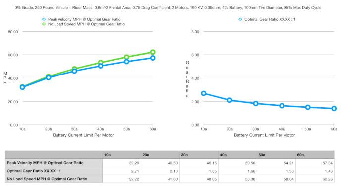

Illustration of how changes to the battery current limit per motor affects the maximum possible top speed while climbing a 20% slope and the ideal gear ratio necessary to achieve that velocity:
max possible speed and optimal gear ratios from 0%-40% grades and 10-60a current limits with (2) 190kv 0.05ohm motors, 250lbs, 42v battery & 100mm tires…
Not sure if there is a motor mount for those trucks
What calculator is that?
It is the only one I have seen that matches my real life usage.
I think its own one made using excel or something
It’s how @mmaner is going to take over the world, with macros
Maybe cause he used 80% effiency instead of the optomistic 90% that most calculators have as default?
