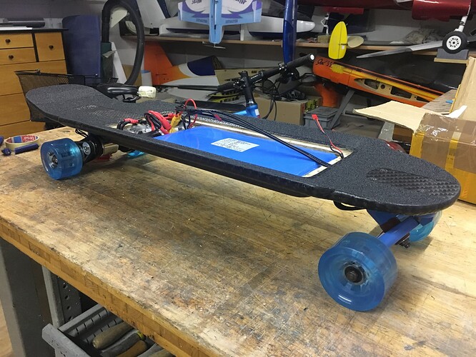

On the “Evo” deck, won’t you be puting all your weight on the battery?
Unlike the “Raptor” deck where there is room for the feet
I partly agree with you. I will be putting more pressure on the Battery but i’m gonna make the Lid very stiff and since you have all the screws on the side of the lid it wont really flex. But we will see it in the end if it is a problem. :wink:

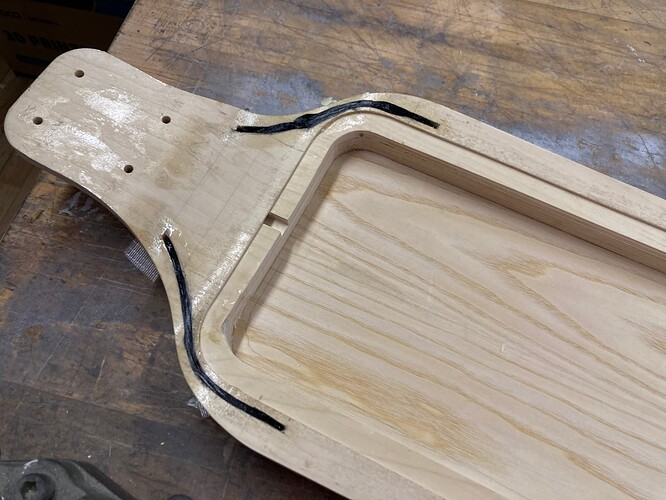

Spennt a few hours today building. Glue’d up the frame for the enclosure and reinforced the lid With Carbon-toe and two layers of thin fiberglas on the inside. The components fit very perfect in there, just the way i like it :grin:

Glued up the frame for the enclosure and cut and sandet it to shape. Very pleased with the look. Gonna glue on the floor of the enclosure tommorow.

Closed the Deck today. Next up will be stiffening it with Carbon-Toe and then Fiberglassing everything. I will soon be starting the battery Build but i’m still waiting on fishpaper and some other stuff.

So here’s the latest progress on my Deck: I cut slots through the deck and reinforced them with carbon-toe and put three layers of fiberglas on the bottom side. In the end the underside will be a shiny black Epoxy surface.

Yeah i am actualy going to rap it in carbon fibre since it was to flexy with just the fibreglas. That thing in the background is my dad’s current giant RC Jet project he’s working on.
I feel like putting a full composite layer on top and inside the enclosure might also go a long way to helping stiffen it up
If you would want the strongest deck out there you would be right. But i think it will be enought even if i dont rap it into the enclosure since most of the stiffness comes from the Carbon on the underside.
