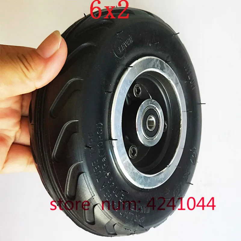

What wheels/pulleys/motors did you fit these up with
They seems to be the dickyho 6x2 on the stock hubs with printed or VEX pulleys
(10mm for NKP)
motors look like TB 6374
