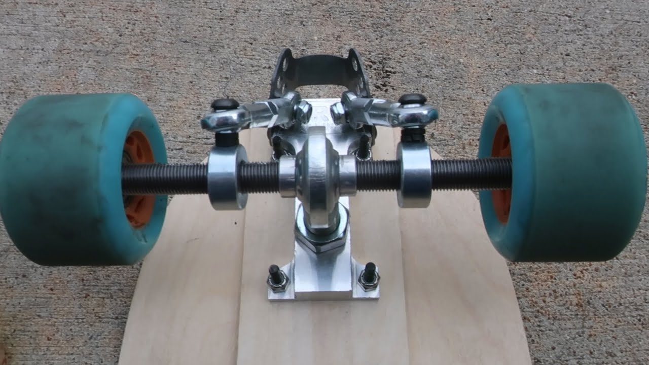

I am wondering why you moved your links so far in compared to the older models @moestooge wont they become inherently more unstable like this as you said? Since you have a way longer arm behind them where the wheel is connected.

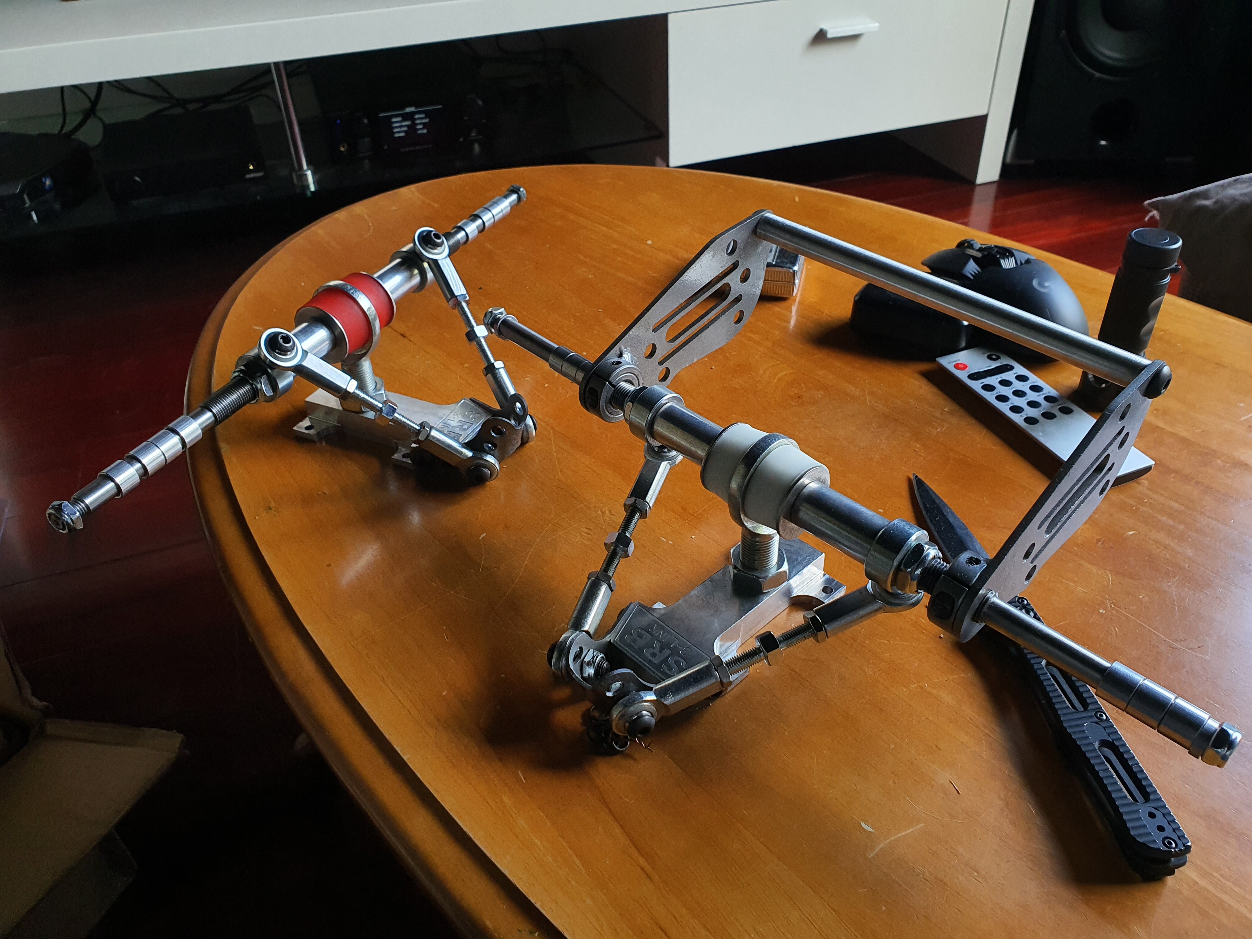

On the E-truck I wanted the motor plates to adj independent of the radius rod mounts and loose the vertical flag mounts. Having the rod mount collar and bushing spacer hardware inside the adj nut helps with easement of axel change and equal collar mount spacing from center of axel.
Yes, if the rod was pushed outward the leverage over axel is increased. To put in perspective look at the axel with on a wide hanger RKP.
There is a 2" or less control fulcrum between the pivot cup and the kingpin.
Was it a compromise in function to move the arms in? I don’t see any loss of control by moving the arm inward.
With an all mechanical connection it will mean a bit higher load on the
radius rod hardware. Will not be a stability loss when the parts are strong enough to handle the controlled load.
Hope this answers your question.

@MoeStooge can you shed some light on how to remove the motor mounts to replace the bushings?
Got it, but what about the bushings on the trucks with the motor plates? Is there a way to get at those bushings?
Motor plates, remove support bar, loosen collar and unscrew plate. Plate is threaded to axel with a threaded clamp collar
:man_facepalming: the crossbar…I didn’t think of that. Thanks for the quick response!
