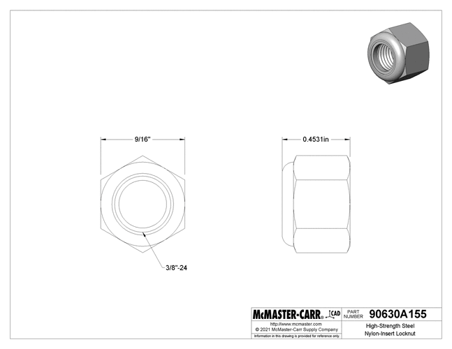

9/16" (same as kingpin on regular skateboard)
(really old ones used to be 1/2" same as regular skateboard)
3/8-24 is a standard Kingpin nut
You use a 9/16 wrench on a 3/8 nut:
