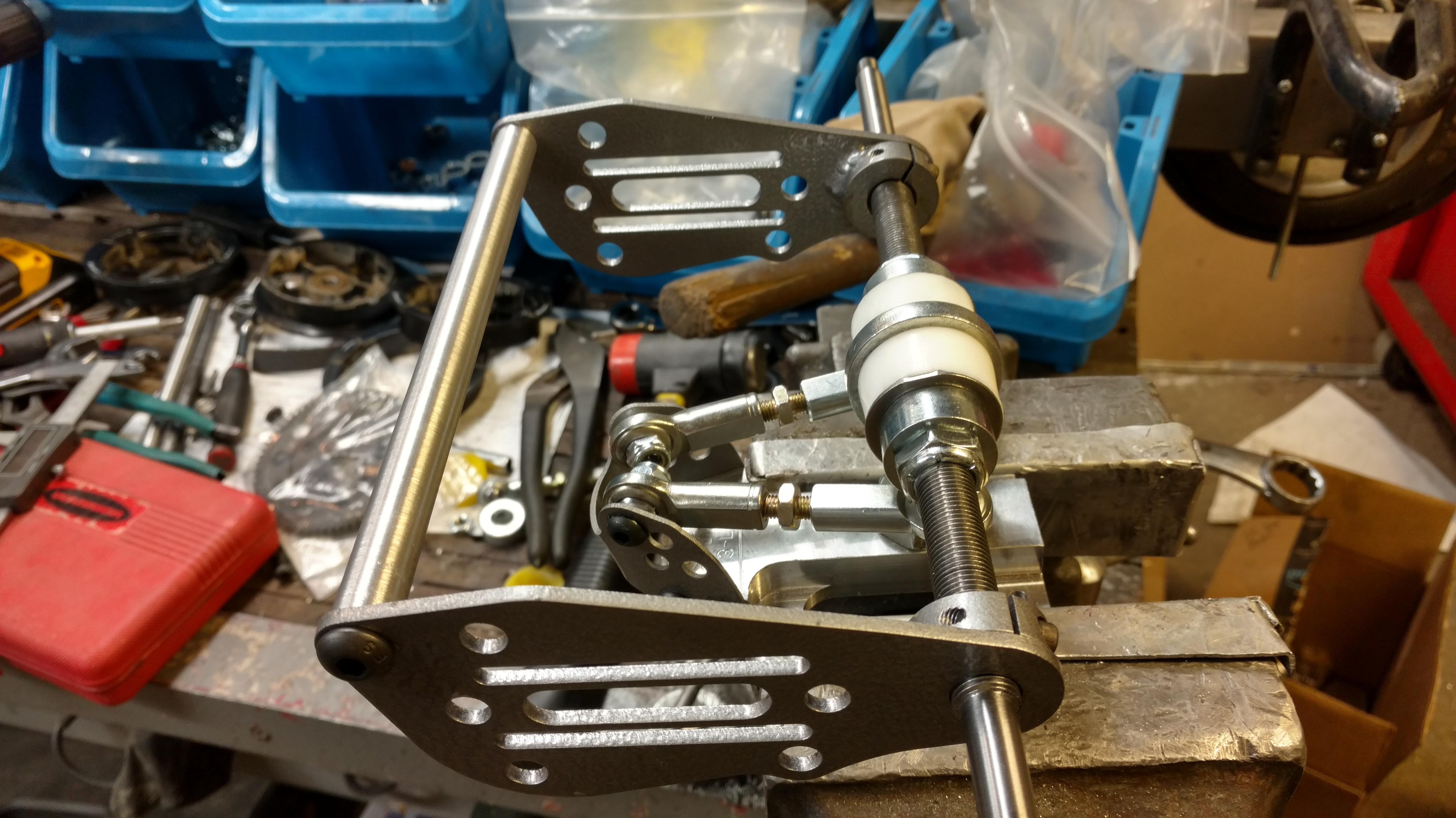

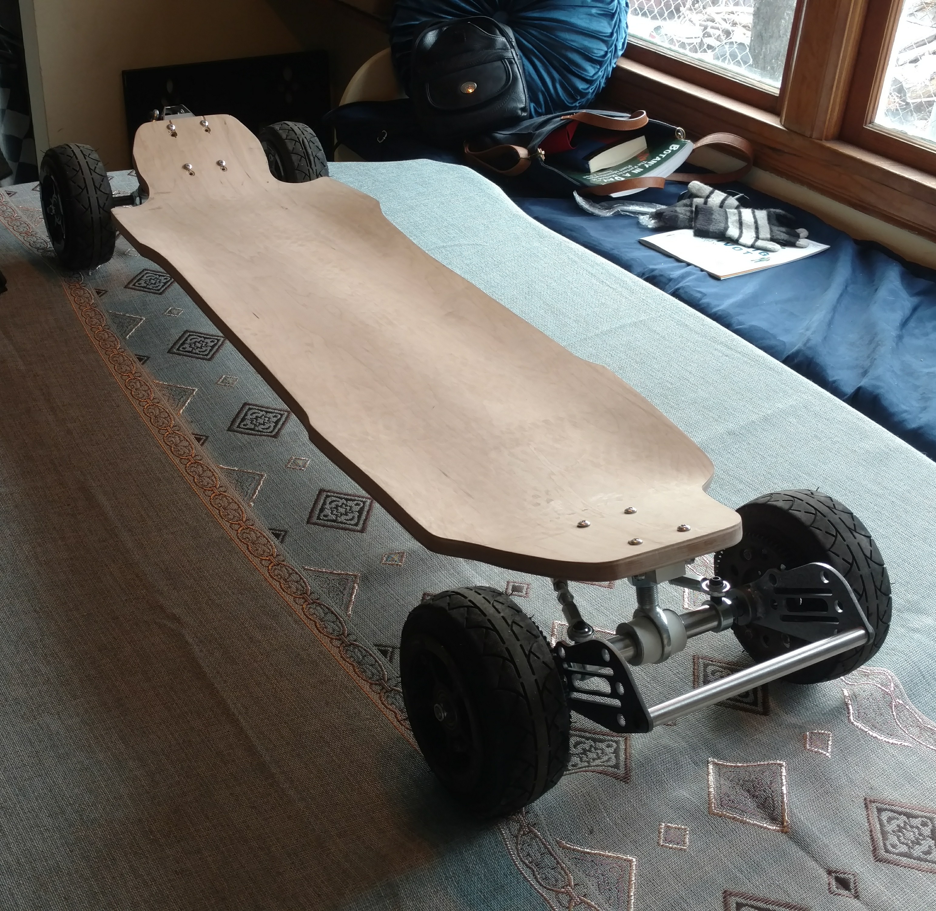

So is 14’’ the narrowest you can go with that type of motor mount? I am looking to make a race board where the wheels and width of the deck are flush.
Or would going with Ronins be better for this?
If your building a Raceboard. Start with grip. You are only as good as the contact patch will allow.
Long track, short track or up-hill with a powered board urethane will get spanked. If we’re talking straight line speed urethane still has a place with performance. Stay away from dual diagonal setups (Torque steer) The big problem with narrow trucks is having enough room for motors. @JaysTCB made a single motor live axel Ronin that works with grip being the limiting factor (Thane.)
With the DH truck we can get you pretty damn narrow. We can make your axel hanger width to what you want.

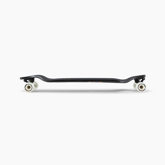

yeah, so I think my current setup for urethane I am good definitely looking to go pneumatic. So I guess I am def getting a pair of 3 links, I am wondering if a downhill board would work well with these, seems like your boards are metal? This is the board I am looking at because of concave https://www.muirskate.com/longboard/decks/73417/pantheon-2020-chiller-pro-longboard-skateboard-deck-w-grip
@MFBOOM theres a down hill deck and enclosure group buy going on right now. Zenit Marble 38 V2 deck - Group Buy (#3 => no shipping costs) - #115 by frame.b022

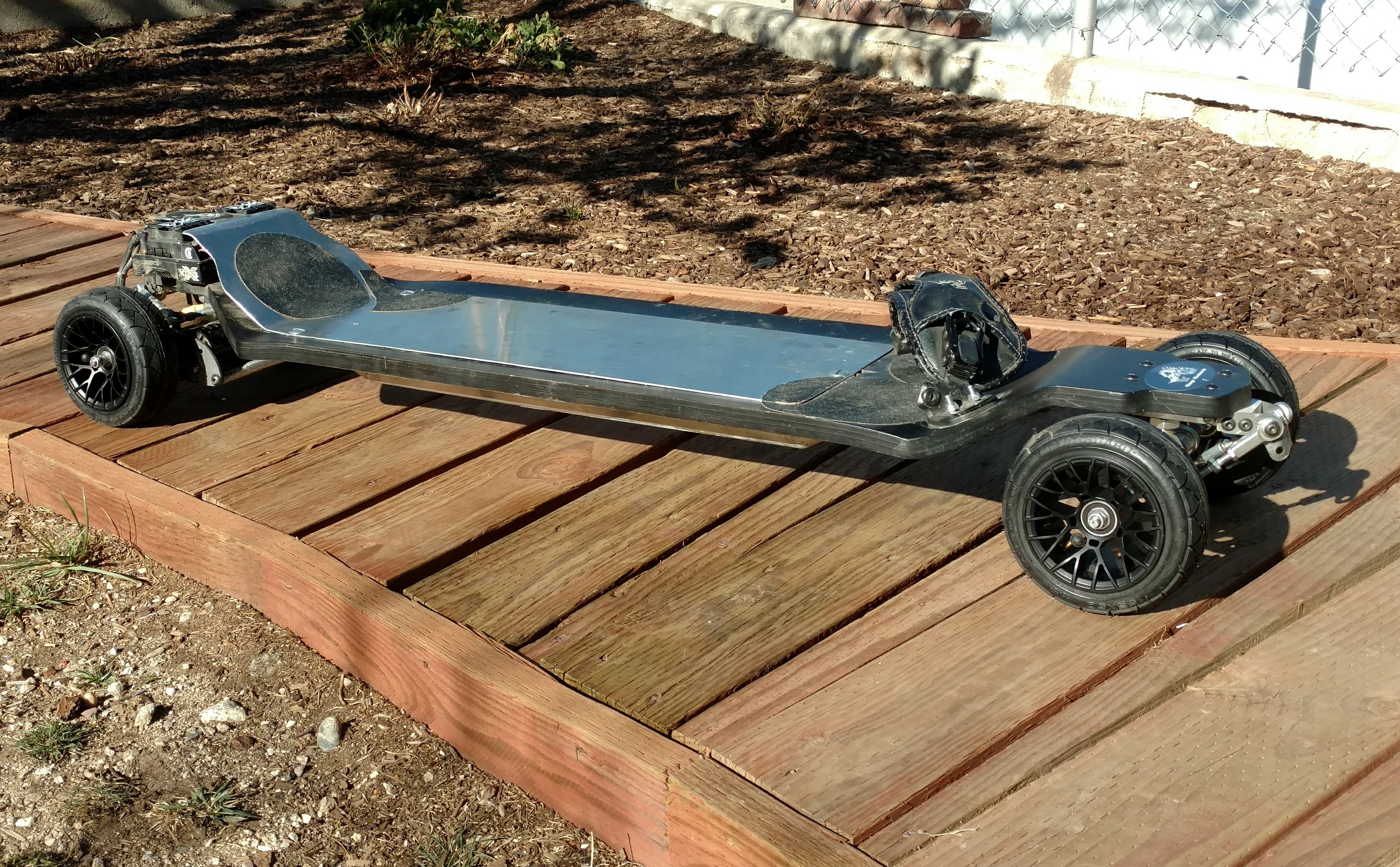

Where we are at in terms of deck design. With the grip level and lateral forces we are seeing. Getting the deck line just above the axel line is important.
With a flat deck (no drop) as turn G’s increase, so does the input force required to hold the turn angle. As the deck line moves to the axel pivot center, lateral force has less effect on input force.

Was modeling on the @davidbonde deck. I gotta say David really nailed the deck design. Red embers should be pressing these soon.
Any ways the wheel is the wide XCell. The fit and finished is second to none. The wheel is on Mario’s LakymeraProtoLinko build. Some day I’ll get a picture maybe. It uses the 20 deg rear kick with the rear link rotated 180 motors out the back , gear driven on Laqroix electronics and bellypan

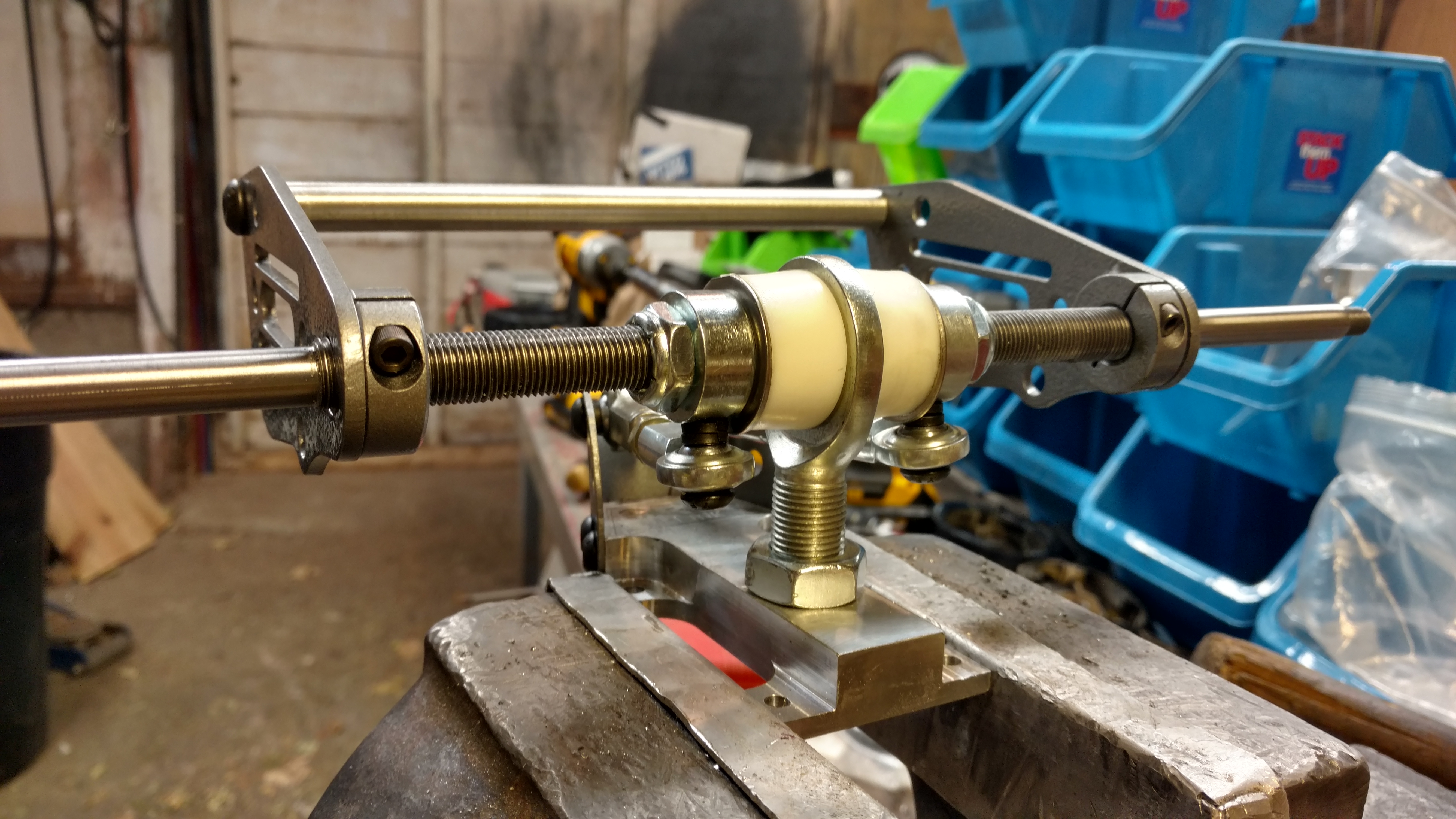

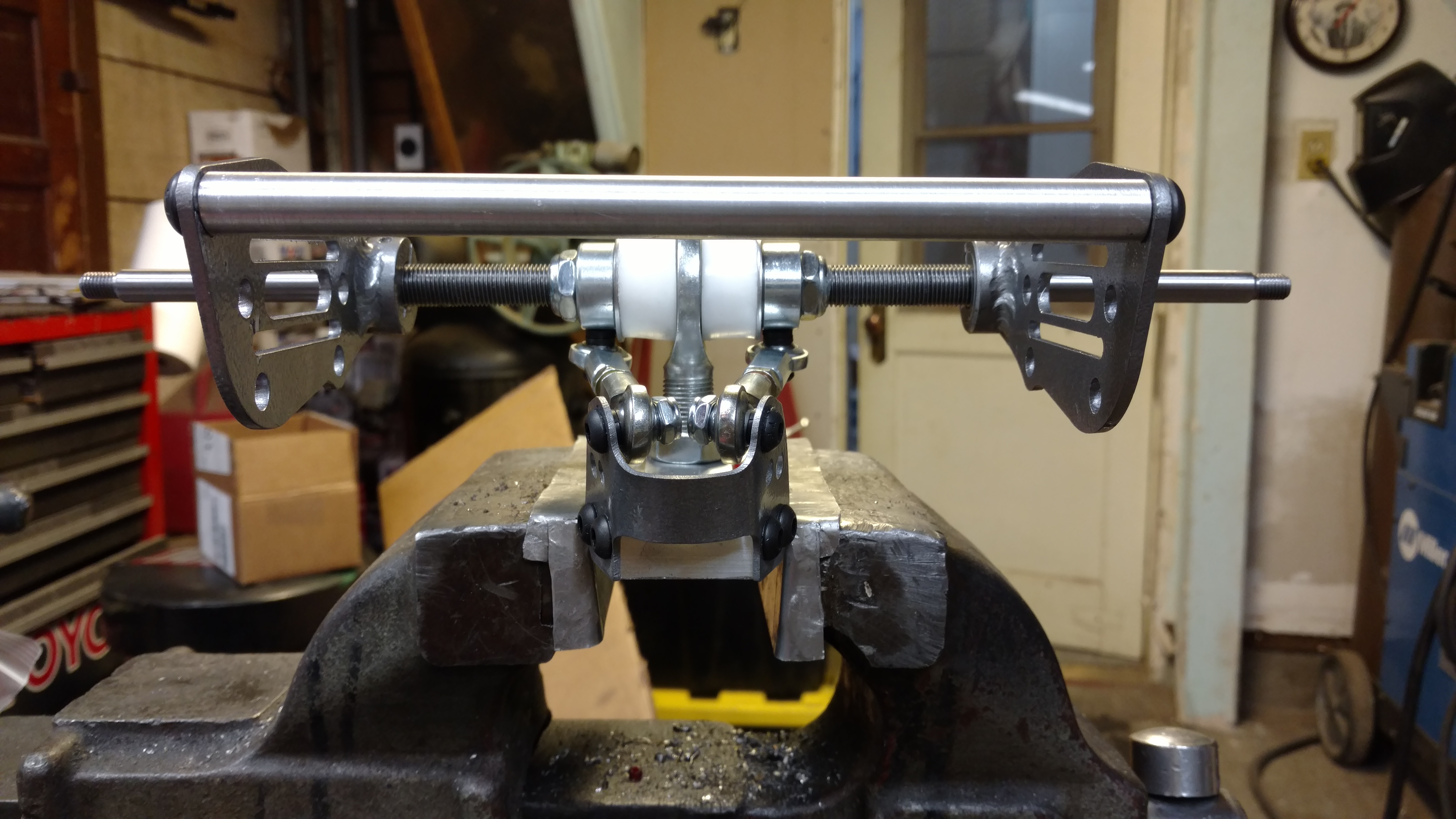

So this might be a dumb question, but what are the smallest and largest you can adjust the axel width using the spacers ? And what angles can you adjust the trucks to ?

Width with the 14" hanger depends on wheel offset and bearing spacing. 13" wheel center width is possible with standard sk8 bearing spacing. We run approximate 11" wheel center width to match up with the race boards and DB/red embers wood deck. Total spindle area 2.65". Motor mounts can be moved inboard to accommodate a narrowed track width if desired.
Truck angle adjustment is 0 to 48deg.
awesome thank you so much, wanted to factor in wedge/dewedge of the board <3

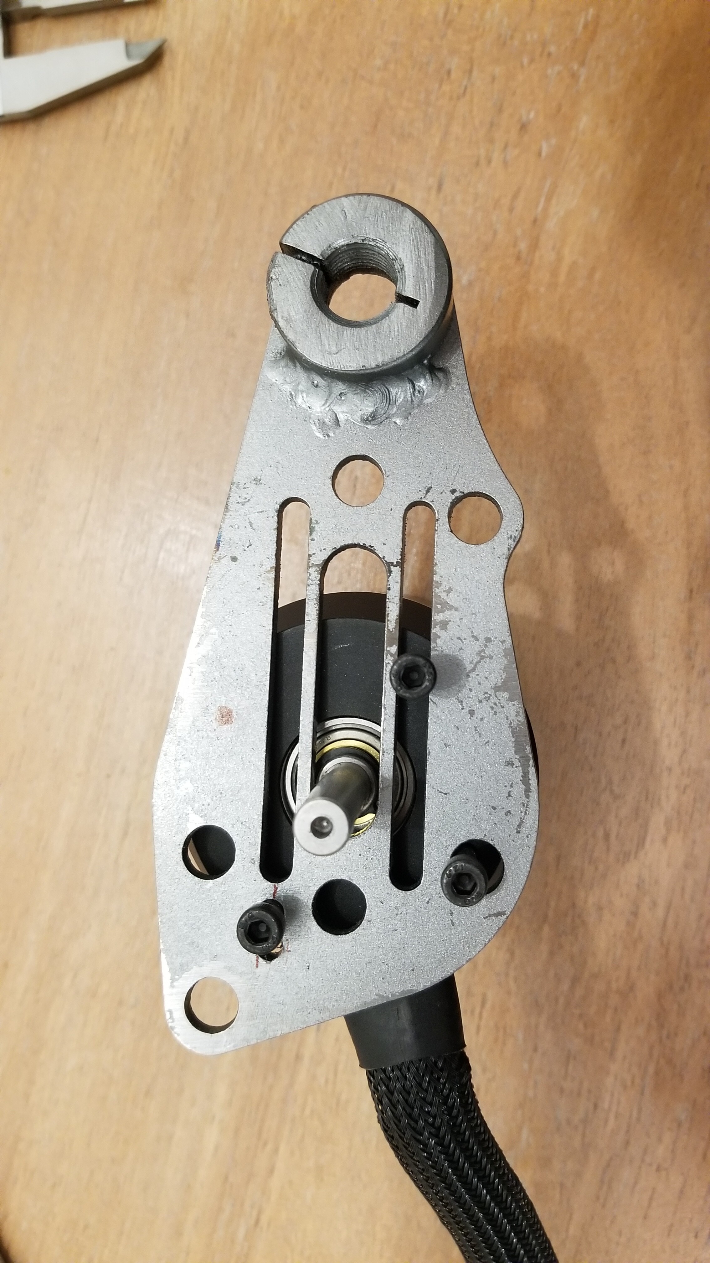

I’m attempting to mount FS6384 motors with the large bolt pattern. I’ve taken Moe’s advice to just use two screws diagonally to mate the plates with the motor.
Would it be a bad idea or worth the trouble to add a third hole at this mark?
Might even use the crossbar hole to mate the plate with 4 screws.
Do it… 4 screws a lil locktite… good to go.
