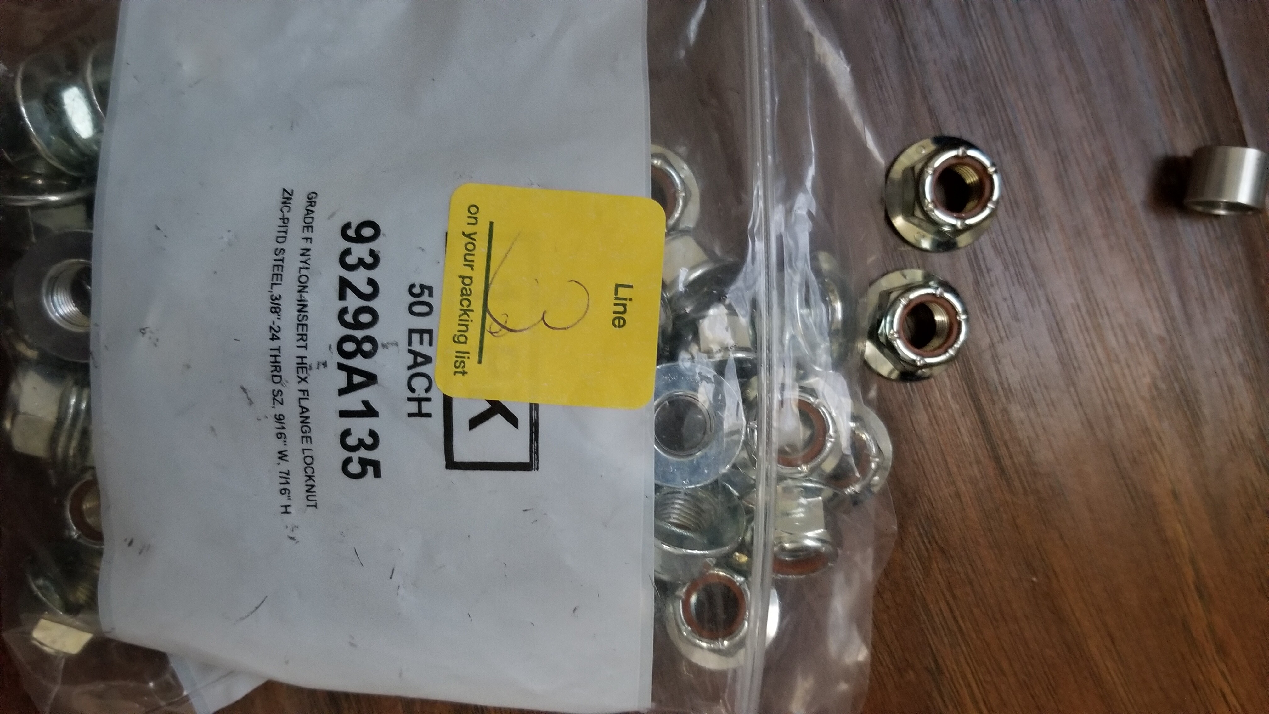

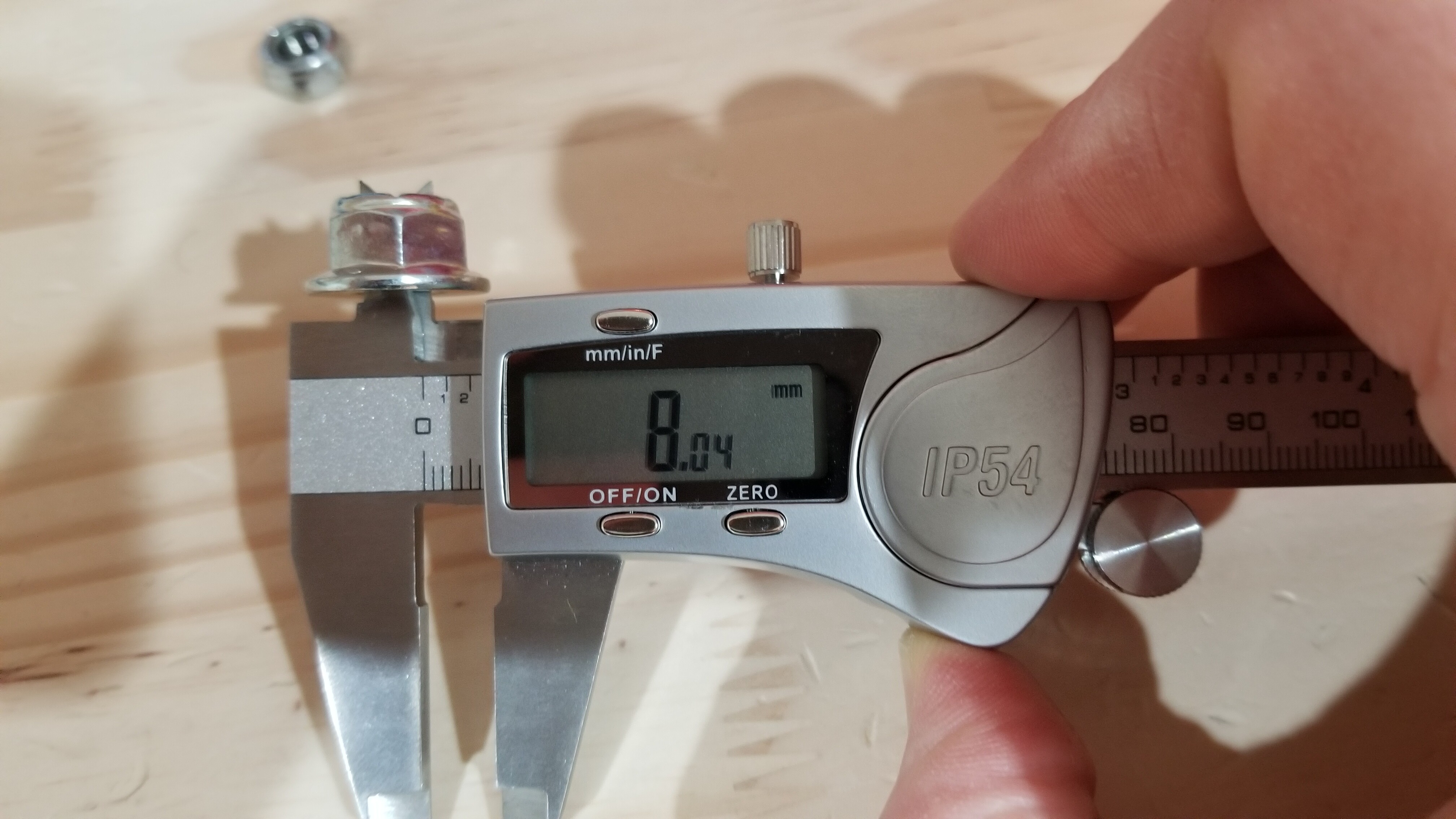

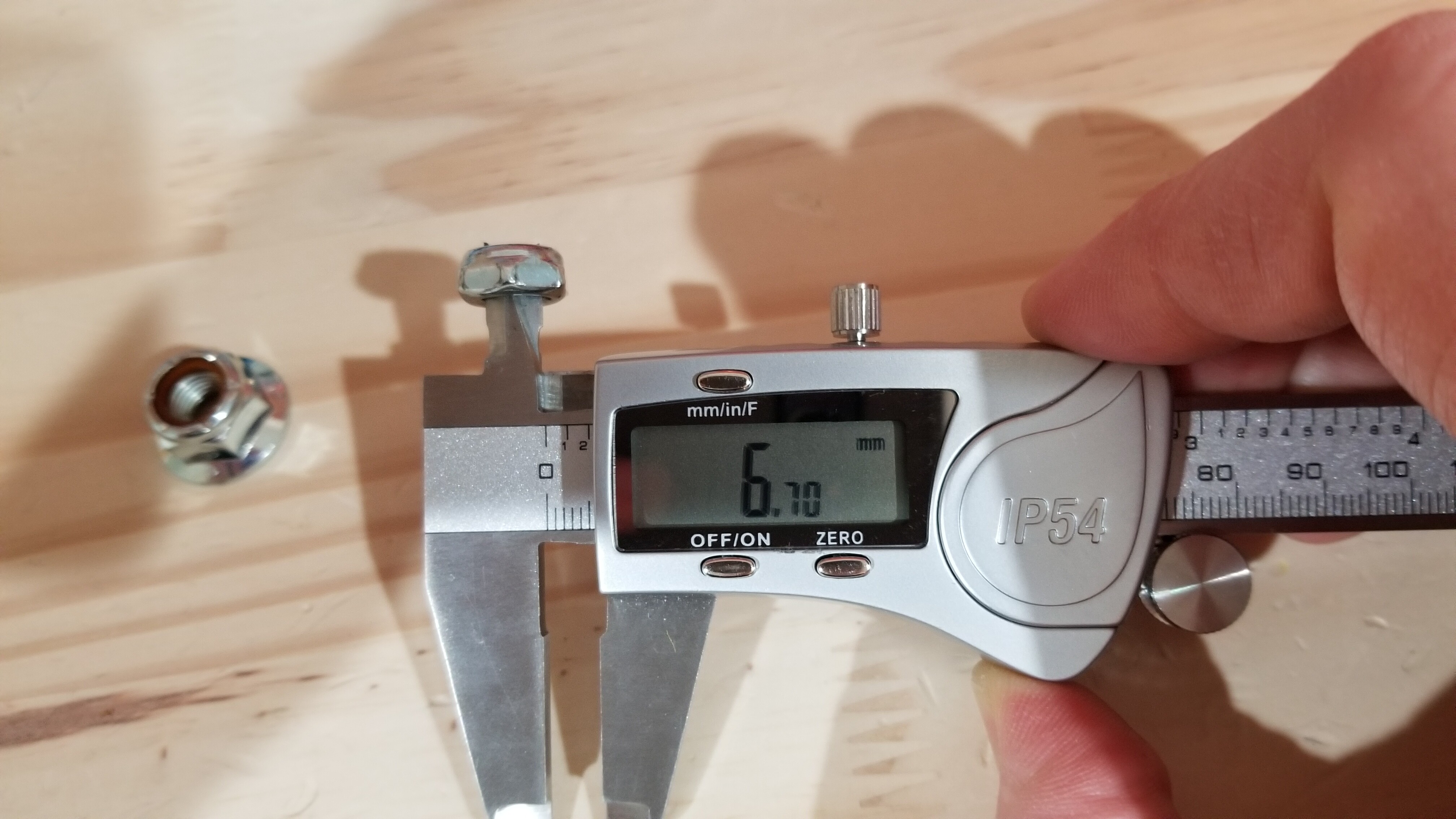

Hi friends, anyone know what size nut/thread the 3links take to keep the wheels on?
@Benja
axel/wheel nut is 3/8-24 thread.
@MoeStooge does this nut size vary depending on what version npk we have? I ordered 3/8-24 hardware from mcmaster but they are much larger than what came with my npk and dont fit the axel. I’ll make a trip to the local hardware shop and test fit my trucks :slight_smile: just wondering what I may have missed on my end.
Ignore my valve stem direction :slight_smile:
@Benja I apologize. Long day.
Axel nut is 5/16-24. Sorry bout that.
Your tire/wheel combo looks Sick!

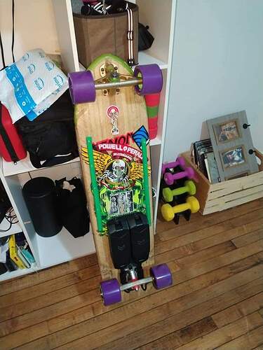

Okay dope definitely looking at this as an option to upgrade, 165 mm with urethane on a DH deck is what I am looking to do. But still trying to get a racing scene here in Chicago, this is my current set up which is sitll fun for going fast into corners but not so much straight speed
