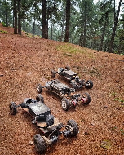

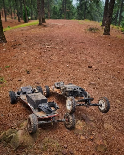

Both boards with RTKP and 4GS
RTKP jump test
