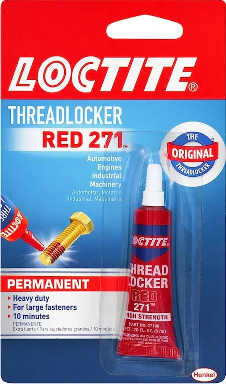

If you think it’s moving in the bearing seat (mine in my impalers did) you can add just a touch of loctite and it’ll keep em in place. I put a drop of red on each of mine in my latest build

Red isn’t a type of Loctite
I think the guy he just helped would disagree
sry u can derail me
Do the bearings fall out of the hubs? If they do, that’s not the end of the world. Just use green loctite like 609 or 638 to secure them in.

The world doesn’t revolve around you. There may be other people this thread helps either now or in the future. Furthermore, typing 271 or whatever descriptor is not any more characters than typing red and is significantly more helpful to readers, some of whom may not be versed in Loctite buying or in with the lingo.
Yep that’ll work too. I was worried using my green would be too much but who knows. I know green and red are pretty similar in certain circumstances (I think I have 638 and 271)
In any case they don’t fall out anymore
