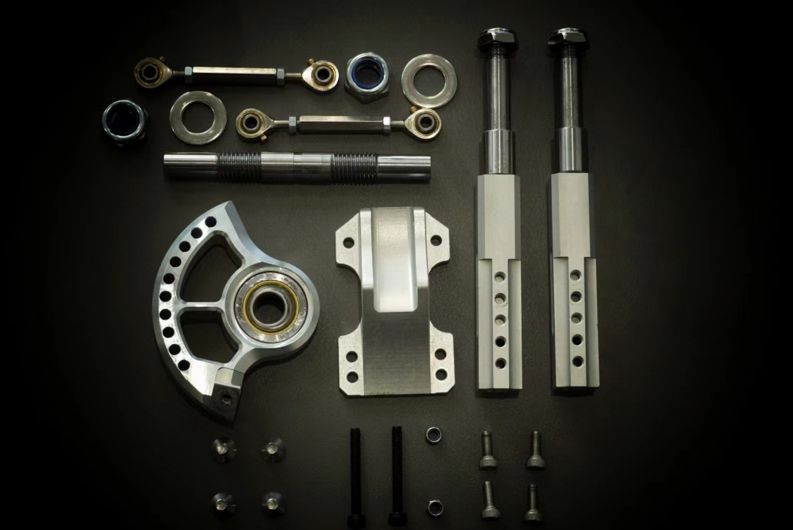

We are here to share you our newest truck! The newbee 3links (Mr.Moe/Stoogeboard came up this concept/ The OG deisgn)
For pre-order the Newbee 3links:
Triplelinks 268mm (pair)
(10 sets are limited, And we will include all the toolings that to modify your bushings.
Order it now, we will post it out before 21th Nov )
Description:
This is an integrated high-strength, highly adjustable, gear drive-friendly 3-links style of truck that was developed by us &
Modular design, easy to disassemble and replace.
Part used:
  • Precision-made 7075 aluminum components
  • Harden Steel Axles
  • Japan Iko Spherical bearing rods
  • Japan NSK Spherical bearing
Adjustability:
Baseplate angle adjustable from (-10)(0)(10)(14)(20)(24)(30)(34)(40)(44)(54)(64)
Rods angle adjustable from (87)(96)(104)(111)
Dimension:
Full size 398mm
Hanger length 280mm
Hanger profile: 20mm*20mm 3mm Chamfer
Move in action:(Gen2 Prototype)
(Please notice the pre-production, the engrave pattern are not all the way through)
Angle Reference Diagram:

This is super interesting. How much testing have you done with your prototypes? Or are these first 10 orders going to be the testers?
Super cool. Can’t wait to see these in the wild with more gear drive options.
Ease of mounting to any angle deck is especially useful, as well as the square profile. Maybe Boardnamics will make an adapter lol
I have done the first step of testing, did hundres Miles Riding, …it holds well so far. the one on the video is our second prototype already.
Now I’m looking for more feedbacks from more riders ride in Muti-style. See what else i need to improve.
20*20mm i think they have already.
I was thinking about this too. The adjustable angle baseplate combined with the forward offset axle should eliminate most of the deck compatibility/wheel bite issues people have with SRB trucks.
Would love to try these out.
Hmmm not sure, Apex airs are 22x22, he also has trampa precision vertigo. Those may be 20 but I’m not sure if the corners will fit
Trampa vertigo are 19.5². He made 3ds adapters a while ago but I doubt he has any left.
I have 20x20 BN adapters and 5.5 straight cuts that I’ll probably use on these
Wish I knew these existed before I bought stooge. So adjustable.
That being said, with all the adjustability it’ll be interesting to see what people set them at. There will probably be some ideal angles
