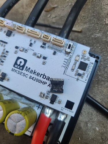

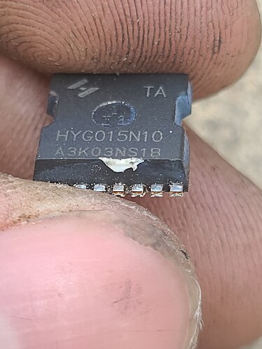

Here is onenof the blown mosfet i was only tunning 40 amps through these
Oh what with the other pcb issues above its not looking good, we only have a ‘small sample size’ to base an opinion on and this is only a ‘revision A’ scenario for this controller so I’m keeping the faith a little longer.
What voltage where you running?
any idea of the part number of that mosfet
I was running 15s battery my maximun current was set to 100a was running 47 phase amps. I ordered the gate driver and new mosfets to see if its repairable. The logic still works can still talk to it though bluetooth.
Here is tthe mosfet p/n. I was accelerating when this happened. It blew a 600 amp fuse it surprised me
oh yes when mosfets short huge current flows, i’m running 80a fuses for testing and my bms is set to 80 too. i’ll order some spares…

The model number of the field effect transistor is HYG015N10NS1TA. I have attached the specification sheet, please check it:
2203031730_HUAYI-HYG015N10NS1TA_C2979263.pdf (453.4 KB)
Hello, if the phase current is only 47A, the 84200HP can easily control it. The field effect transistor is the model HYG015N10NS1TA you have, 100V/380A.
I see signs of burnout in the gate driver? Is this a humid environment? If the environment is too humid, additional waterproofing treatment is required. The 84200HP does not have waterproofing treatment.
There is another issue that needs attention, which is very important, because it is the most common problem so far: please be sure to correctly configure the braking current and battery reverse current. These two parameters need to be determined according to the battery energy recovery performance. If If the configuration is too large and the current cannot be absorbed by the battery, it will easily break down the field effect transistor. If you use a switching power supply, it cannot handle the reverse current. Please be sure to configure the reverse current to 0.
