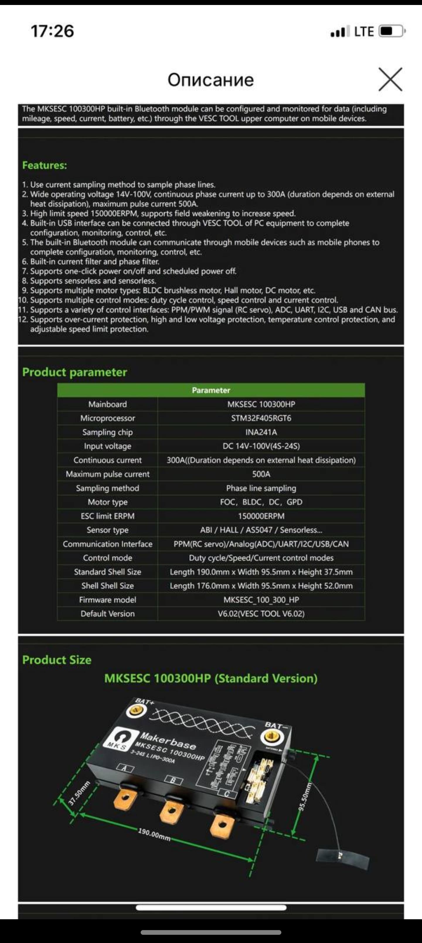

just seen the 100300hp standard for sale on AliE. Will a water-cooled version be coming out? I’m hovering over the buy now button!?!
Here I found this vesc on Ali and came here for reviews but I didn’t realize it was so new.
