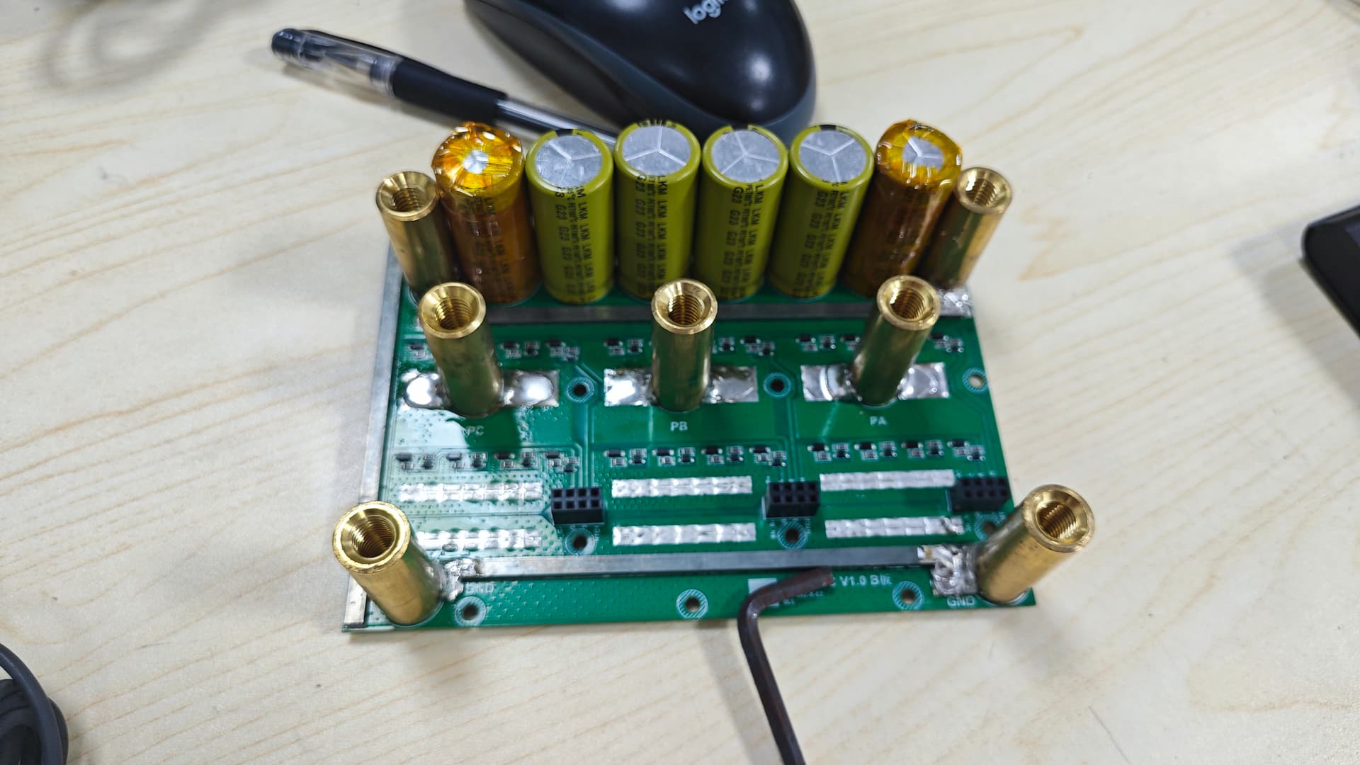

what if you used pluggable headers instead of direct solder, with a few holes through the logic board and power board (lined up) and M3 standoffs?
then you can screw down the power board with the standoff nuts, and use M3 screws to also fix the logic board when they have pluggable headers.
that means no need for glue or direct solder, you can then just unplug it after removing the screws, then access the power board and eventually unscrew that if you need to.

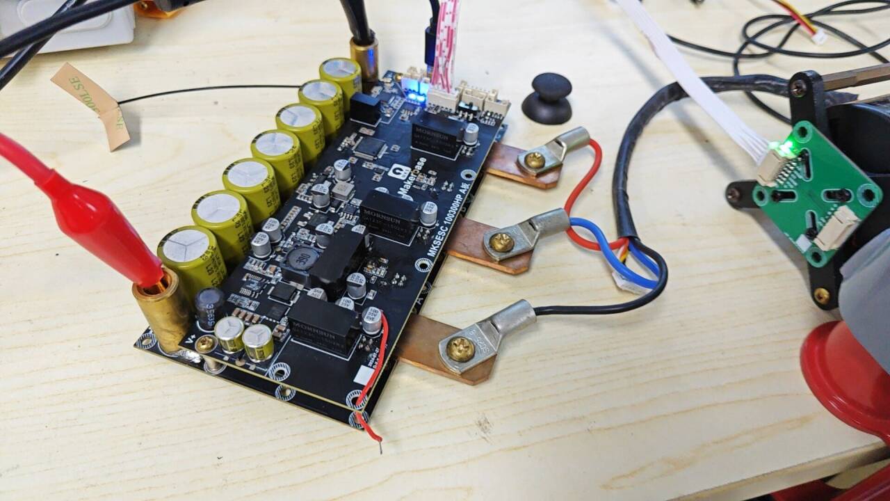

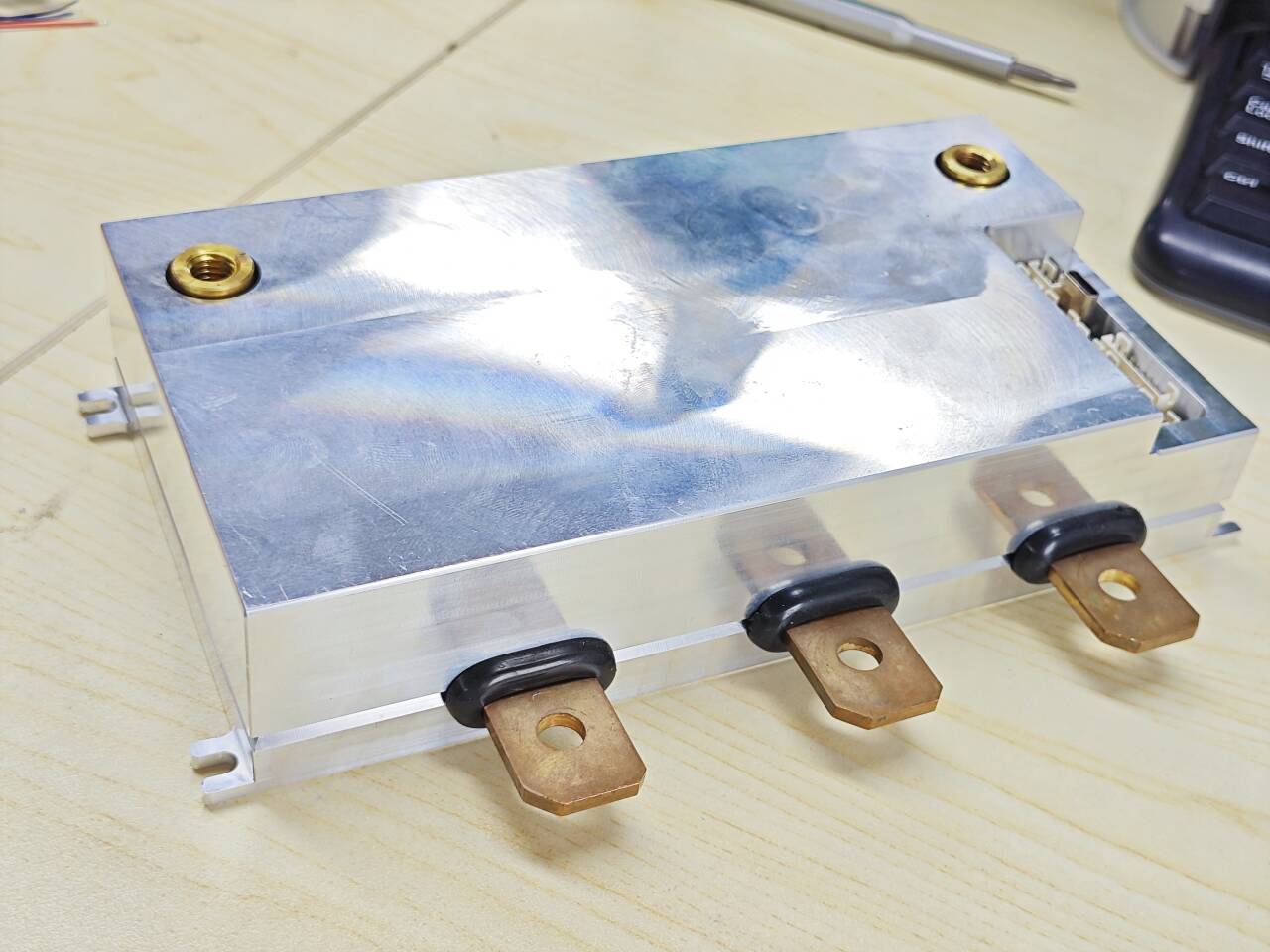

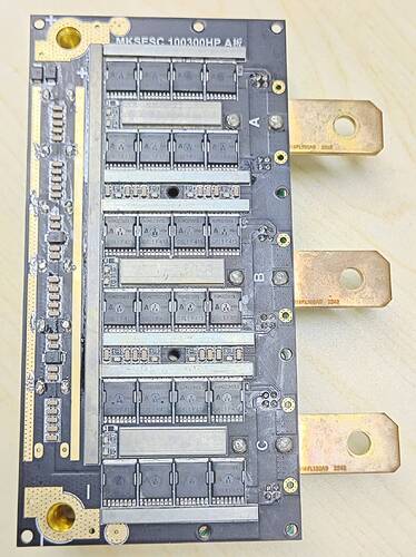

I want to know about new 100300HP model
Cause my 84200 v1 and 84100 was burned out and I want to update power supply, so I need MOAR POWER xD
But there is no MKS controllers with 24 fets, so I planning to buy fardriver
The new version of 100300HP is already in the production stage and is expected to be available for sale in early December.
At the same time, when designing 100300HP, we listened to many suggestions from ESK8 friends and optimized the wiring method of the motherboard. Thank you very much to ESK8 friends who left a message in the 84200HP post.
Let me briefly talk about some parameters:
  1. With 24 135V/305A MOSFETs, 4oz copper thickness, and full copper strip coverage for high current;
  2. The operating voltage can reach 24S (limited by the phase line sampling chip INA241A);
  3. The current sampling method is phase line sampling;
  4. There are phase filtering and current filtering, and one-button power on and off circuit (equipped with a switch button);
  5. There will be non-water-cooled and water-cooled versions. It is recommended to install heat dissipation equipment for the non-water-cooled version.
  6. Use SiC driver dedicated DC/DC module power supply to ensure the integrity of the gate signal;
In addition, I can share some photos below:
