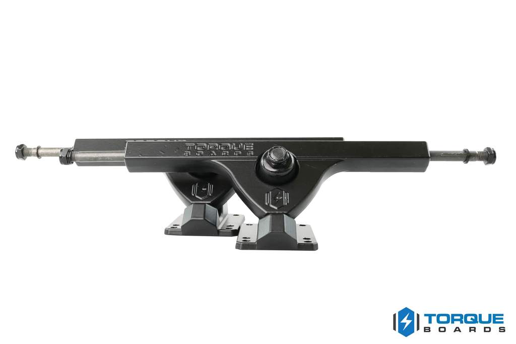

@BbsMentos you could do the torqueboards kit with AT trucks comes to around $450
i will show you another one in a minute

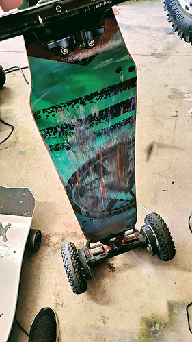

If you wanna do some real offroading (more than what your XR can do) then you will definitely want a top mount enclosure. This will make sure you dont have to worry about big rocks, treeroots or dirt screwing up you enclosure and possibly your electronics. Plus if you want to do some jumps you definitely need a top mount enclosure.

What do you use to secure the box to the board ?
Threaded wood inserts like this
I then put fat rubber washers under the box for vibration and water resistance
So this will work eventhough the Trampa deck is not made out of wood ?
Yeah, I might go with coarse threaded inserts for a composite deck. @Andy87 @taz what did you use?
