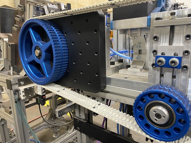

Yes it does eventually happen to aluminum, I’ve seen it on production machines, until now…
Made these pulleys for a machine and hard coat anodized them.

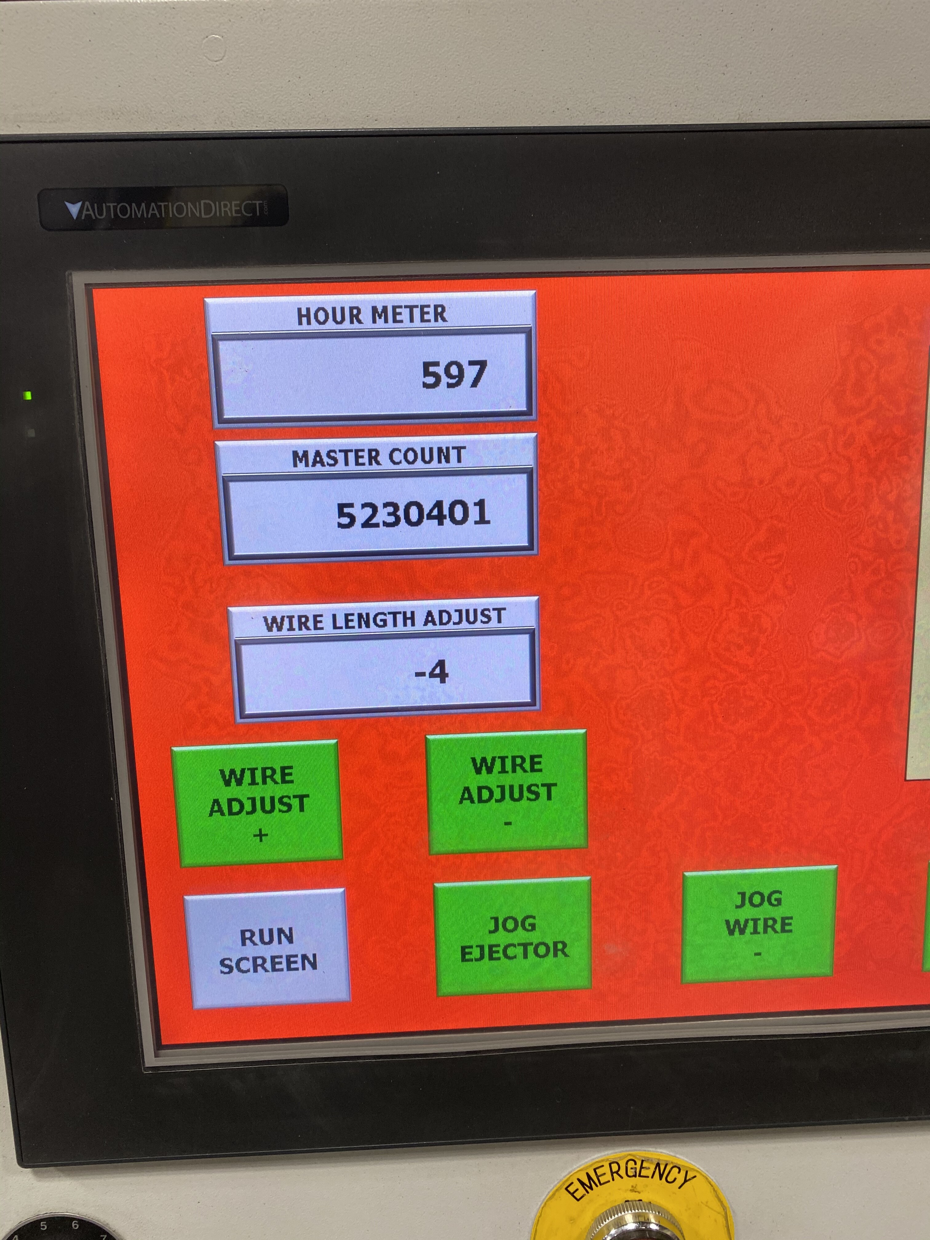

After almost 6 million cycles, not the slightest amount of wear. So, of course you know what I’m thinking :thinking:

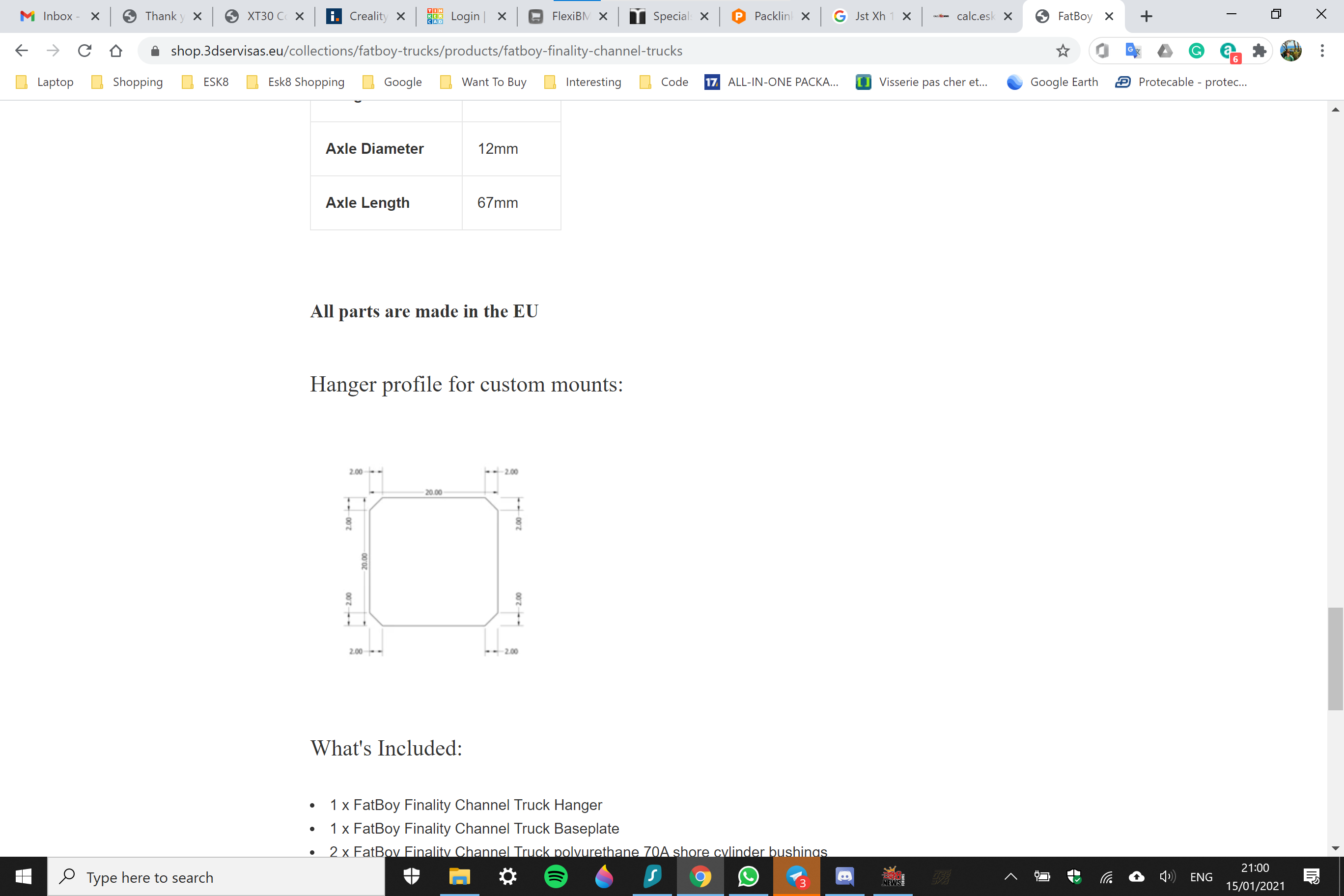

I’ve found that the 3D servisas fatboy hanger is 19.7 by 18.1 square for caliber2 bases. Does anybody know if it is the same profile as their channel and matrix? And if they hold those tolerances fairly close?
Profile is different
Correct me if I’m wrong @3DServisas but both of channel trucks are 22mm square with a 3mm radius
Nvm
right on! thanks!!
FatBoy320 hangers will have a 20x20mm profile with a 4 mm radius coming soon. Old version is 22x22mm with a 4mm radius.
@3DServisas, Thanx man!
