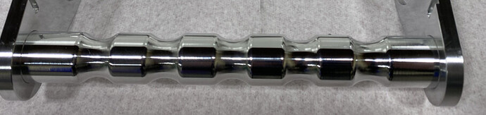

@BruSkater that’s the feedback we are looking for! To answer your question, when using gloves, hopefully you can grab the handle comfortably
Could I suggest a Boardnamics hanger profile as well
Yeah I’ve seen a number of people try to drag their board around by a typical bash guard, and it looks beyond uncomfortable trying to jam a couple fingers in such a tight spot to cary heavier boards. As Phil said above, we took gloves into consideration as well. That said, you’re not the first to say this, so it’s a fair point.

For sure. Again, the idea is to allow people to swap out truck styles as much as they want without having to buy an entire new mount system, so we’re considering any truck style that has decent usage in the community. We know boardnamics is popular and well respected, so that would only make sense.

I for my part like the big handle, kinda resembles a spoiler from a car, and it looks quirky. Love it!

As for me, mount has to have holes for belt tension bearings, each plate with two holes. with higher kv’s (mine is 192kv) and powerfull boards 2kW its the only way to avoid belt skeeping
Yes, holes for belt tensioning bearings would be a really nice addition!
So I guess Im not the only one who thought of that haha
Definitely not :smiley:
Hey hey, that’s one more thing we can add to the list of features!
