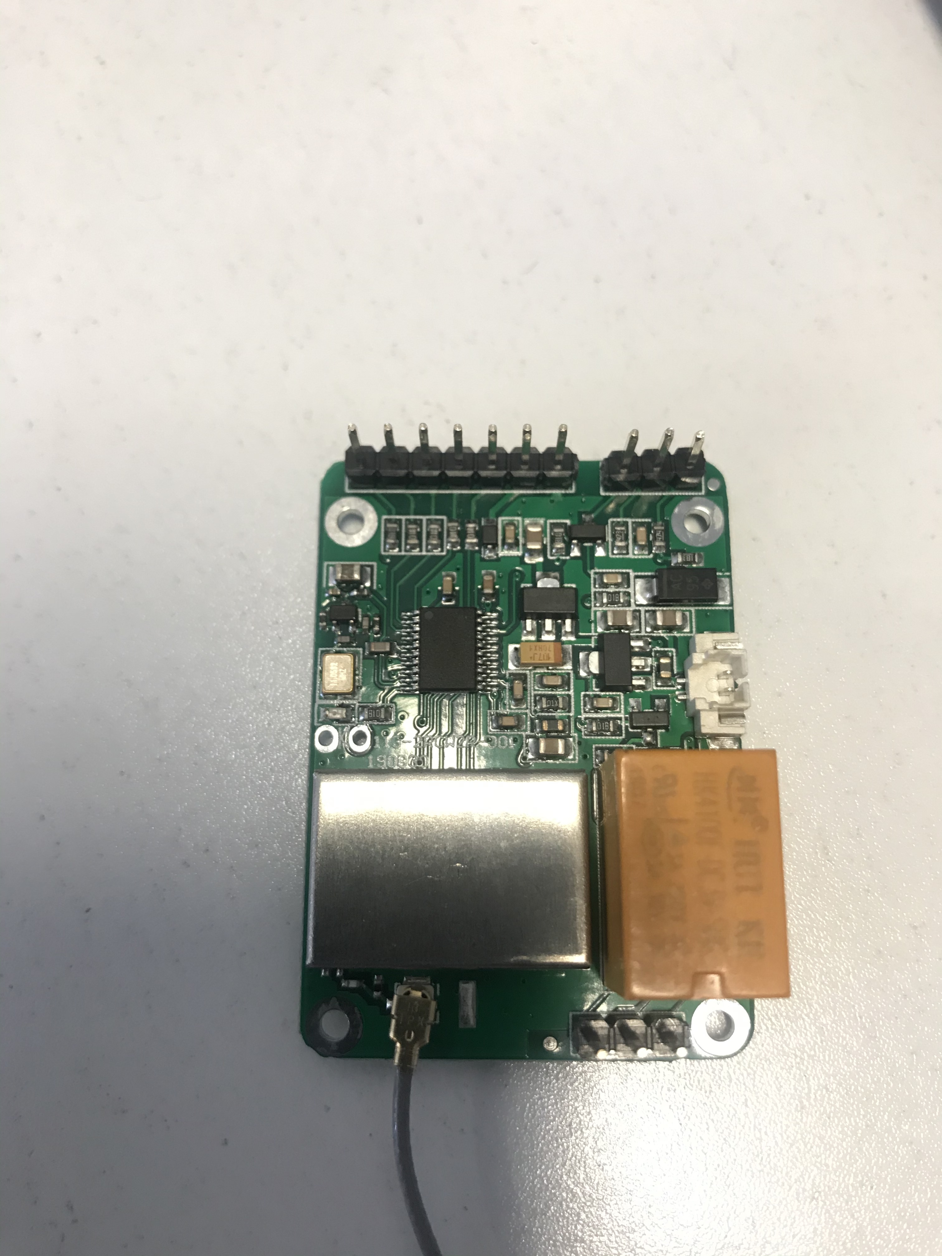

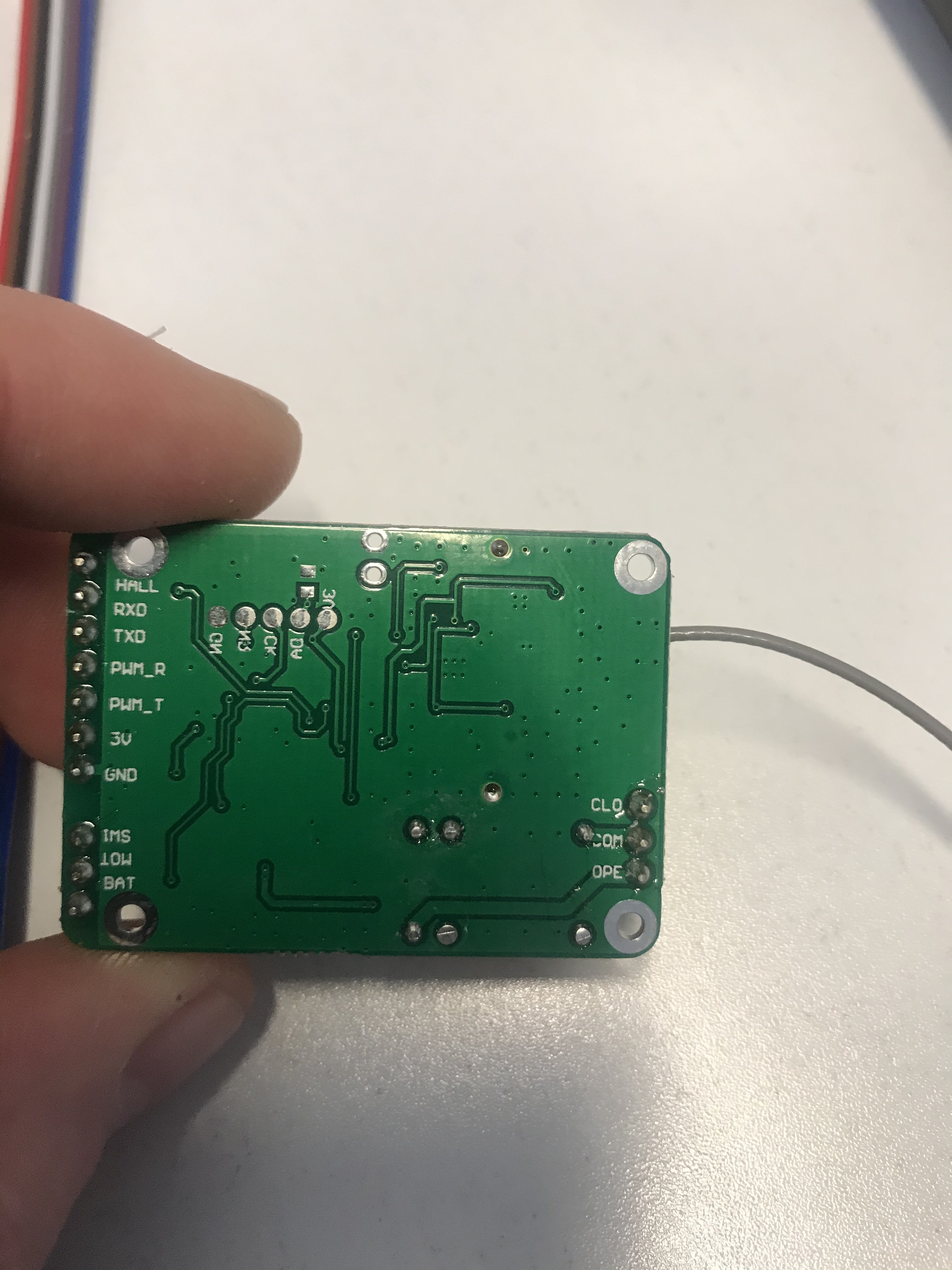

I personally pushed Elieen and the maytech crew to do better. I’m sure I’m not the only one. This has resulted in a revised interface for screen and a new receiver.
I’ll do some testing but my question to the forum is what do you all think the likelihood is that this receiver is better?
I’m not a wiz when it comes to the remote signal portion of DIY esk8, from what I understand this receiver can handled many more signals making it a more stable connection somehow.
Pics of the new guy:
Vs old
I’ll update this thread with testing updates, but figured I’d ask the lords or tech for their thoughts as well. It’s going on my Commuter board with a Unity first since it’s my lowest powered board so if all goes wrong I hopefully won’t be going too fast.

I got mine back in April on a group buy deal, once I had all the connection issues Maytech did me a solid and just replaced mine with this new iteration when it was available. If its as stable of a connection as a nano v2 its 100% worth it. The feel from what I remember was second to none.
I love my V1. Never had an accidental button press in the split triggers. I’m really interested in seeing if the V1 remote with the V2 receiver with a FW update. Any insight on this?
Ask them which frequency hopping algorithm / tech they use. Is it DSSS based or FHSS. If it’s DSSS I’d be avoiding it personally, since every WiFi / WLAN router out there uses it and it’s less robust.
