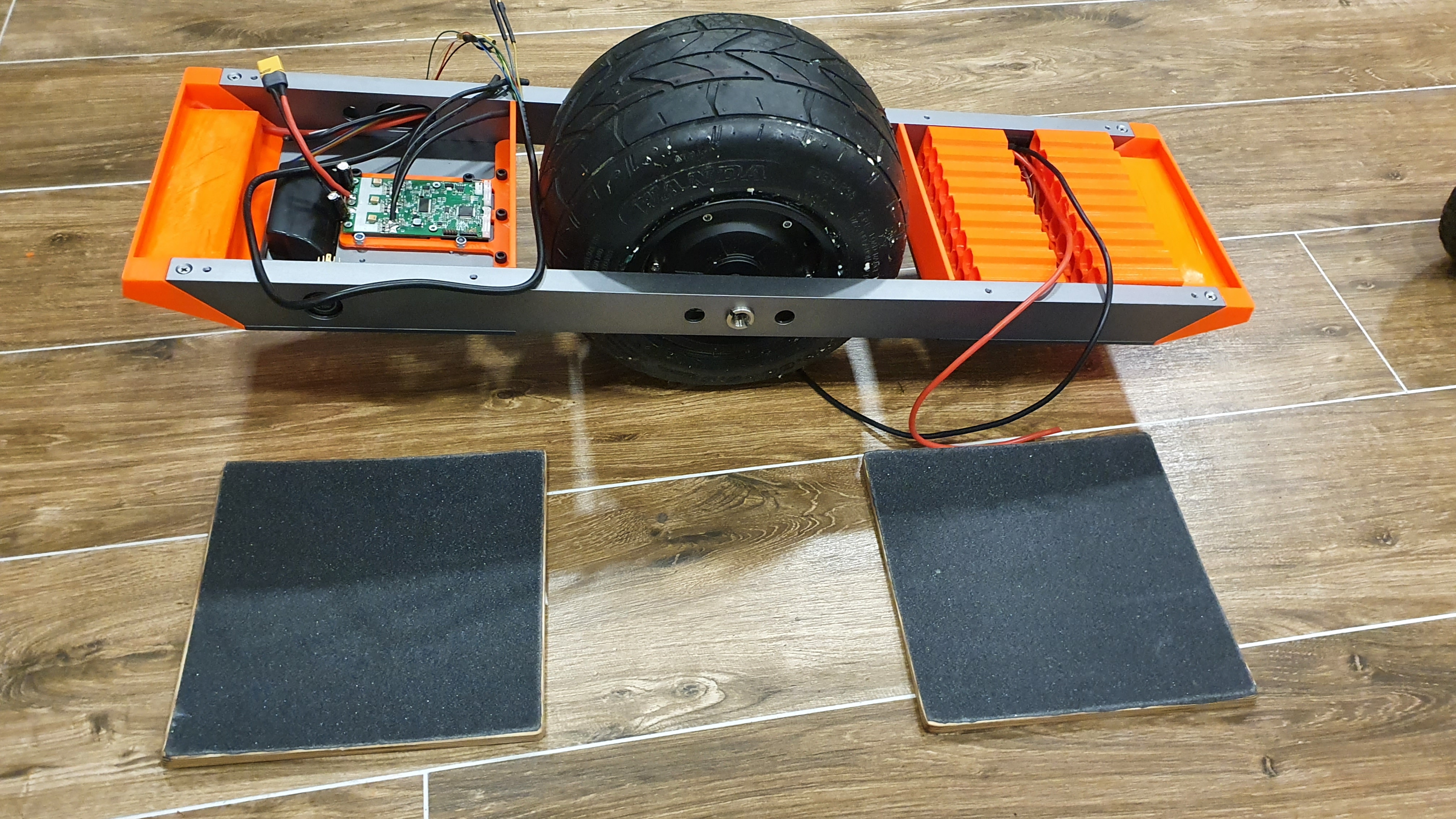

Finishing my build with previous kit. Everything is included in kit except printed parts, esc and wheel. Quality is really great!
Esc not included ? How did you manage the gyros and all ?
You still have the files for the orange 3d printed parts ?
Focer (you see it on photo) has integrated IMU (balance). Foot sensor is also included, it is under grip tape so you can’t see it.
Front and back bumpers are creators (@Enginir) design, other orange parts are mine and I can share all files.
Looks like the old kit has much more room for batteries.

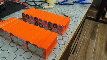

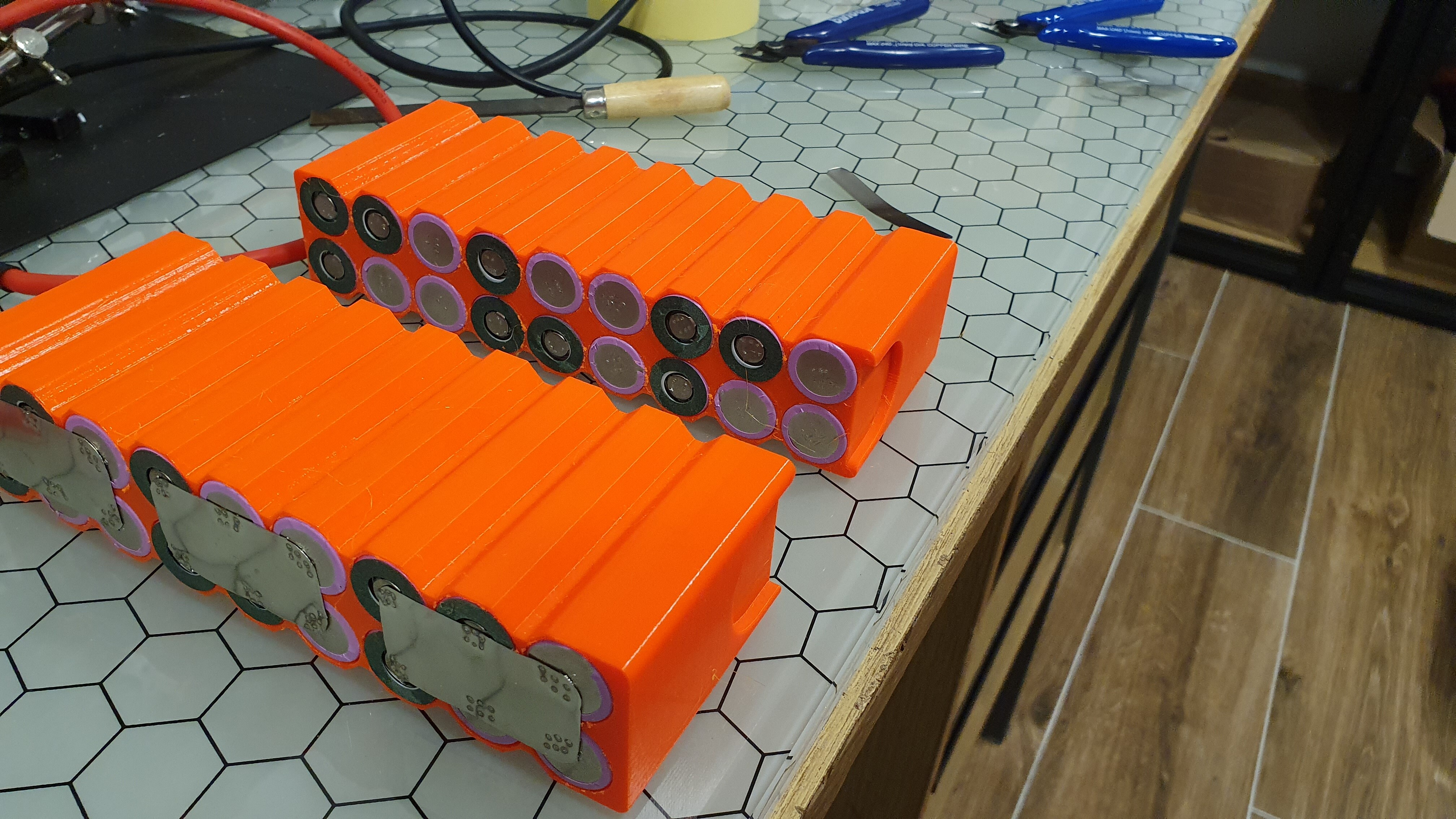

I’ll fit 12s3p 30Q inside

Quality in the previous kit is really nice
I’d love to have those battery holder files if you don’t mind.
