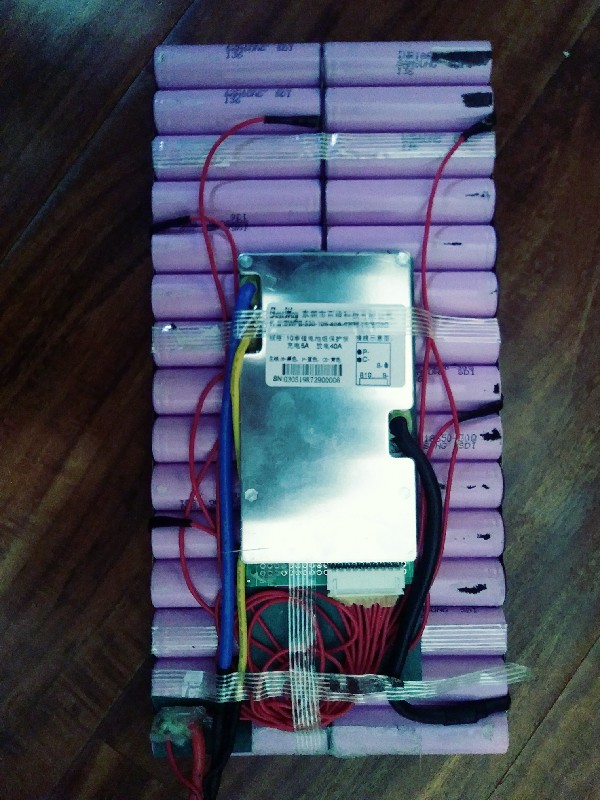

make sure whatever board/enclosure you use doesn’t flex the battery… I’ve seen more than a few of their batteries, and they all are connected with nickel across the series connections…
and no isolation between Pgroups
a stripped nekkid mike fucking beard 10s3p battery
a flexy deck and an mBored battery is a dangerous thing…
good luck…
Ooook wow that does not look good. My deck has no flex and my enclosure has more than enough room to safely accommodate the battery, so hopefully it’ll be safe. Jesus christ never buying that shit again
oh… just an FYI… all the mBored batteries had discharge BMS’s, some as low as 30amps…
their battery systems are crap

I’ve fixxerated some, and it’s a pain in the ass just to make them safe and salvage the cells… i bought the one in the pik above for 30 bux when I showed the owner all that needed to be done to make the pack safe and efficient…

pictures unwrapped Mboards battery pics mboard pack specs
Is this one of the ones after he stopped making them himself and started getting them made by some manufacturer?
