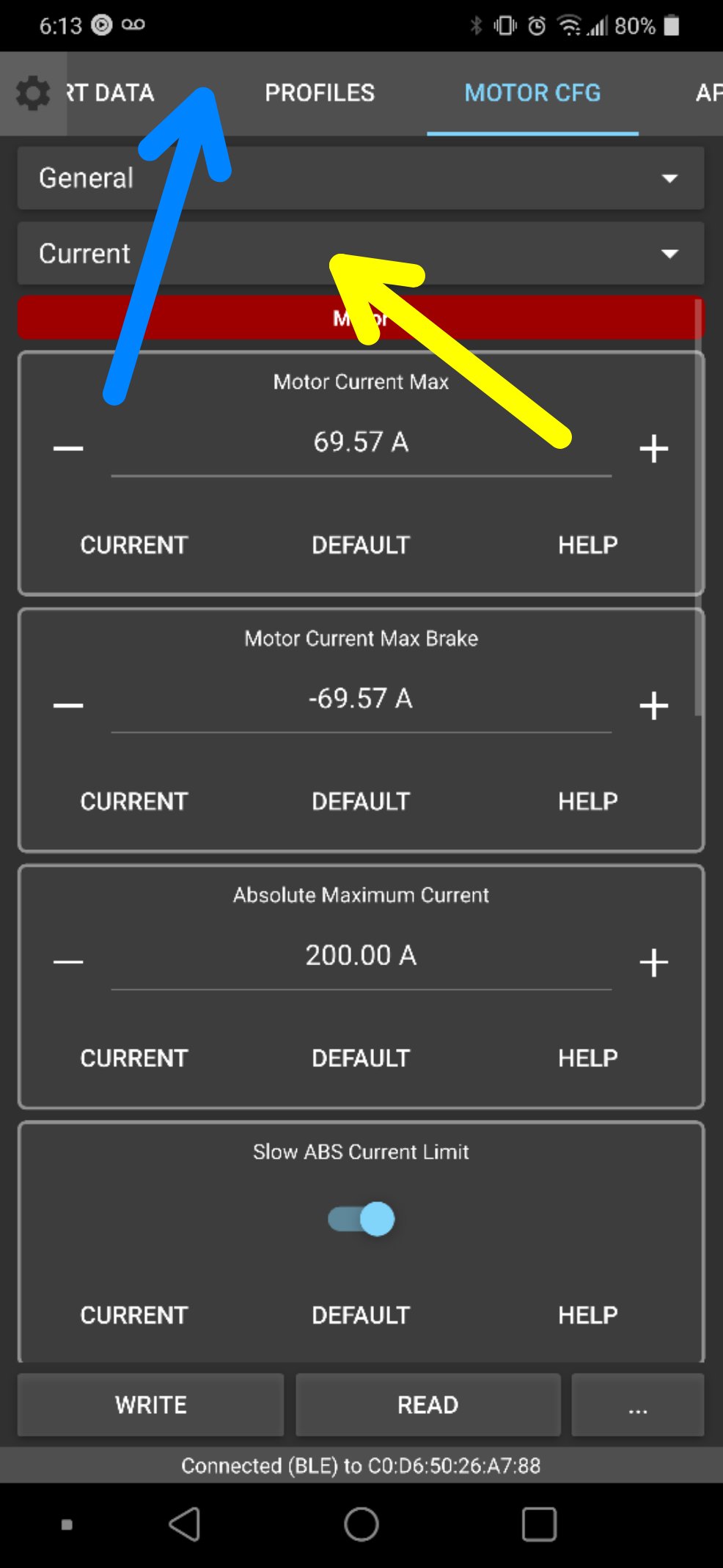

Top menu can slide left and right (blue arrow)
Go to motor CFG
Second drop-down menu (yellow arrow)
You’ll have all the current settings there

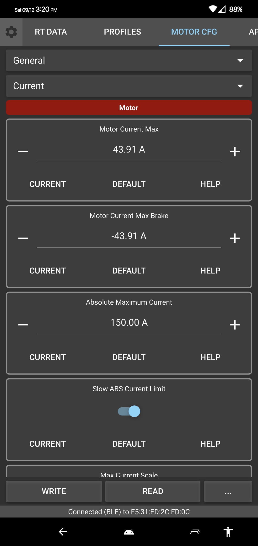

stand by guys, trying to get this screenshot posted
So around 44a per esc
Battery? (Scroll further down)
