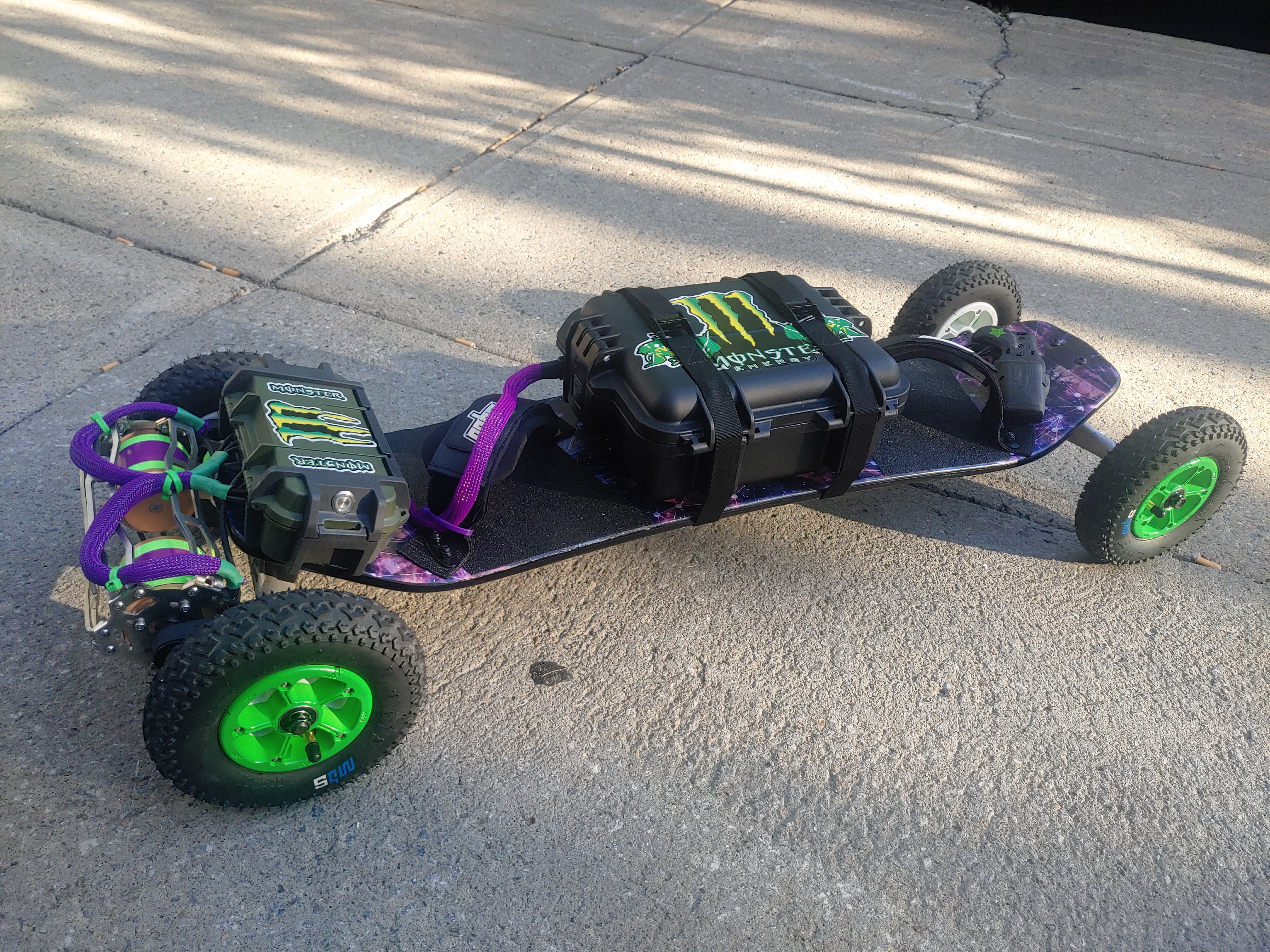

First build so roast evenly on all sides. I used twin maytech 6374 derated to 4200 max Watts output (this is pertinent). Two 50 amp max cont. 200 amp burst vescs by maytech as well. My battery is 10s6p high drain 30q cells providing a max of 100 amps to keep everything well bellow limits. All that being said I made the containment system and motor mounts with hand tools from blank slabs so they are… unique.
Now to the fun part, I built this thing for torque so it would climb hills and it does! I have been using an accelerometer to test its parameters and on a full charge I am pulling .8 to 1.29 g’s! It is so sketchy punching it.
I did, this design actually had multiple iterations where I considered a centralized metal container but did not like the size (I used a battery system that was blocky) initially. However one of my biggest concerns was that with so much torque I would have terrible traction(on anything other than rough pavement its a spin fest if I punch it). I realized the weight being over the back end would put less strain on my rear leg and help keep weight on the tires. This board was not made with traveling around the city in mind. I wanted long range, currently getting 15 to 18 miles riding like a mad man up and down wild grass hills and some road but mostly getting to the fun. I have to say an unintended consequence is that big booty does some really fun dirt drifts.

As you should be! Keep an eye on those ats trucks. I had a set snap under me at 30mph and it was… Not so chill. I like how they and the 20° deck tips ride a lot though.
Ha! Like an accidental dr Suess. What kind of set up do you have going? The build is so much fun, its almost dissapointing to finish… but then you get to ride it and honestly the tinkering and adjusting phase took just as long as the design and build phase. All about building what works best for you, I just wanted a mountain board and an atv to have a baby. I would love to see the finished product when you get done.

Holy hell… 250 amps! At 100 amps my take off is like getting teeped in the chest… What kind of range do you get and at what amp/h? I have not range tested mine to any real capacity, curious to see others.
@AaronMerritt61
Its capable of it but I have it limited at 65a per side. I haven’t done any range test as it’s not made for that purpose. I can say I’ve done four F1 trackruns in one go
Track is 4.361km long so comes to 17.44km on one charge with about 40%left
