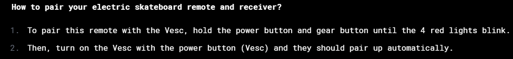

I’m only not sure how I can connect a new remote to the motorcontroller, so how I can activate pairing mode :slight_smile:
It is possible that the only similarity between the esk8supply remote and the ownboard remote is just the case. It will be interesting to see how this plays out
Yeah I think I gonna buy a Flipsky remote link in my original post (the print looks exactly the same as the one which is integrated into the controller) and try if pairing works.
I also found more information on boundmotors who is using the same motors, they say the power is around 600W and max current is 50A
And also they have the same look-a-like remote:
Pairing looks pretty easy:

Then I tried NRF quick pairing when I put my remote from ownboard in pairing mode, but it doesn’t work.

The Flipsky vx1 remote is not working.
Tried every connection type but no succes.
I just ordered a vx1 pro remote and we think this might work.
Also found some pictures on the flipsky website of the internals of the remotes and they look prety much the same.
@Pecos just for info :wink:
I found some new information.
So the new Flipsky vx1 pro remote won’t work.
It’s using a E28-2G4M12S chip while on the dual vesc a E01-ML01SP4 chip is build in and in the original remote is also a E01-ML01SP4 chip
These 2 chips can’t work together.
I found a picture of boundmotor which gives some more information about the free taps to connect a seperate receiver? I don’t know for sure but I think it’s for debugging.
Or I can buy a E01 chip and replace the E28 chip in the flipsky VX1 pro remote.
Or I can remove the E01 chip on the dual Vesc and place the E28 chip on it and connect the correct pins of it.
