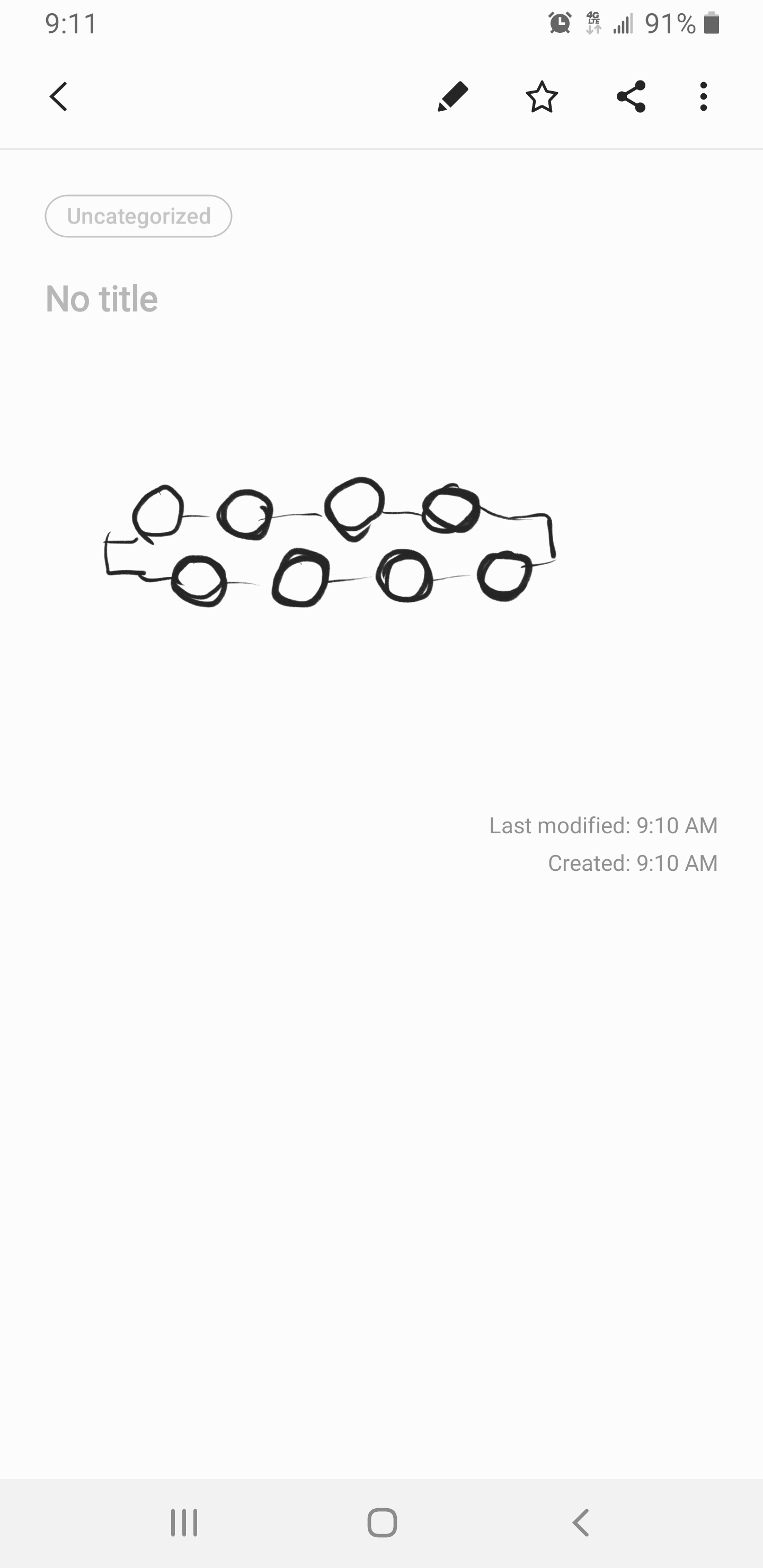

What’s the spacing between the tabs? From one parallel group to another?
@mishrasubhransu do you mean the gap between p groups? There really isn’t much of a gap. There’s double fishpaper on the end cells of each P group that touch. Here’s a pic of it with all cells
I can probably squeeze a credit card between them if I had to.
Gap between the tabs meaning the distance between the planes of the tabs. I meant the other p groups, the ones connected by series connection.
I took total cell length minus the button top and subtracted .25"
Nicely done! :+1: How are the 4P tabs held in place? If they moved towards the center that would be bad. Do you have any kind of spacer between the 4P tabs?
The 4p tabs are held in place by black RTV silicone. I ground down the edge of the tabs that meet in the center to give more distance between p groups. Then I put some black RTV in the gap between the tabs. The tabs are almost impossible to remove. I had to redo one and it was hell getting it unstuck

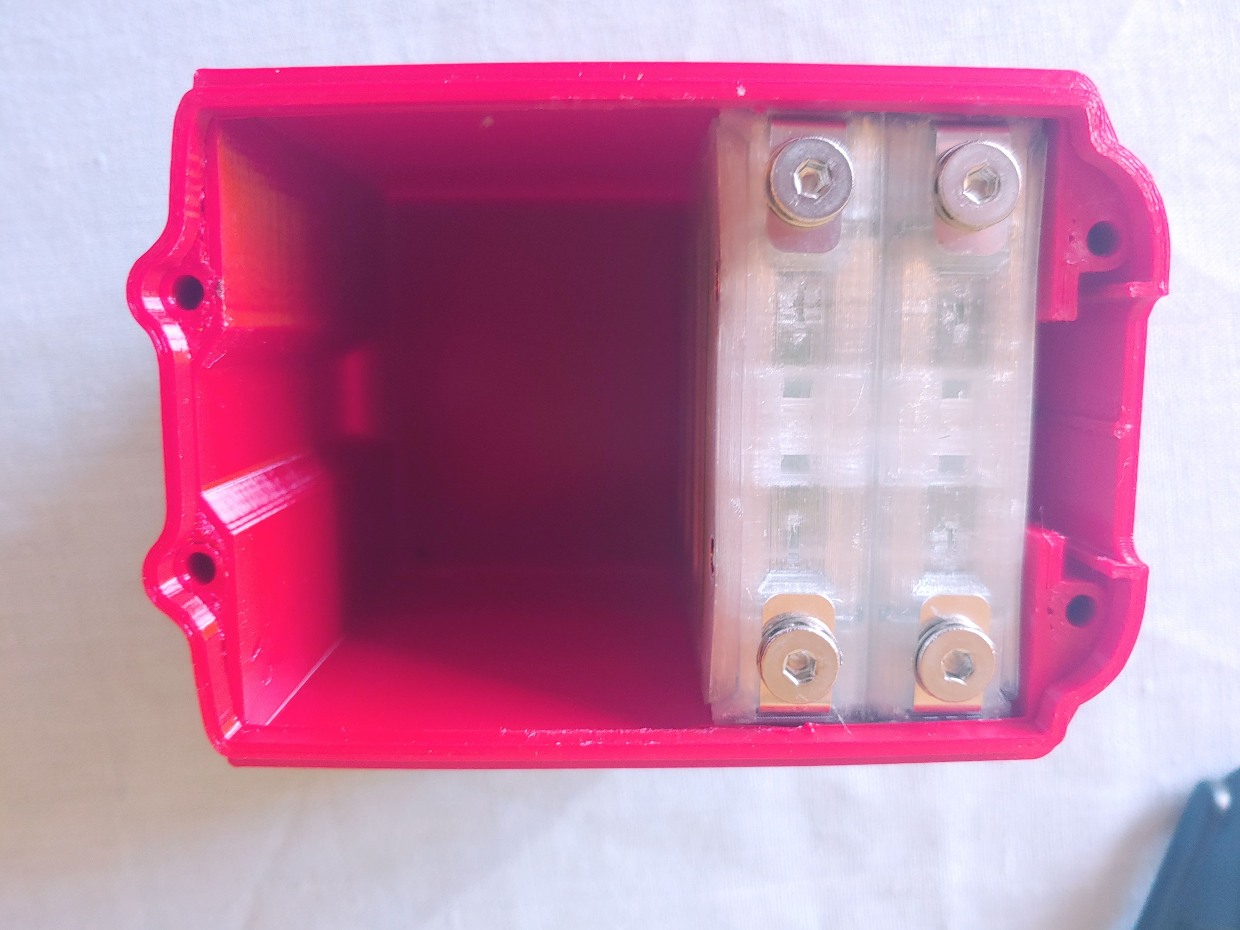

I have started working on Makita tool battery. The design will use original Makita lid but will take 2 to 8 cells and will be rebuildable many many times. It will use ultra thin modules at 18.5mm.
So far the design is made for older style PCB’s without management but i will get the new ones done as well. I am still early in this and its a teaser, nothing more, but its good to share stuff with people to get some opinion.
Sure it will be larger than original but its rebuildable many times and some tools like lawn mowers dont mind that. 6 to 24AH Makita battery would be dope :slight_smile: Oh, and it should use original charger too.
This is 4P(12ah)

Succsess. 12AH makita battery works.
Does it work with their charging system as well? I had to repair one of my father’s batteries (replaced the cells), but afterwards the charger would refuse to charge it. Also found it interesting that the cells did not have balance wires, only a single one, which I guess was just low voltage input for some circuitry :man_shrugging:
The circuit boars counts the cycles or voltage. If it gets below threshold it bricks the battery. This is the old style battery. The ones with gauge has cell level monitoring and balancing. You can get first gen replacement pcb for 4 bucks and new bms pcb for arround 12 bucks on ali. It uses makita charger.
