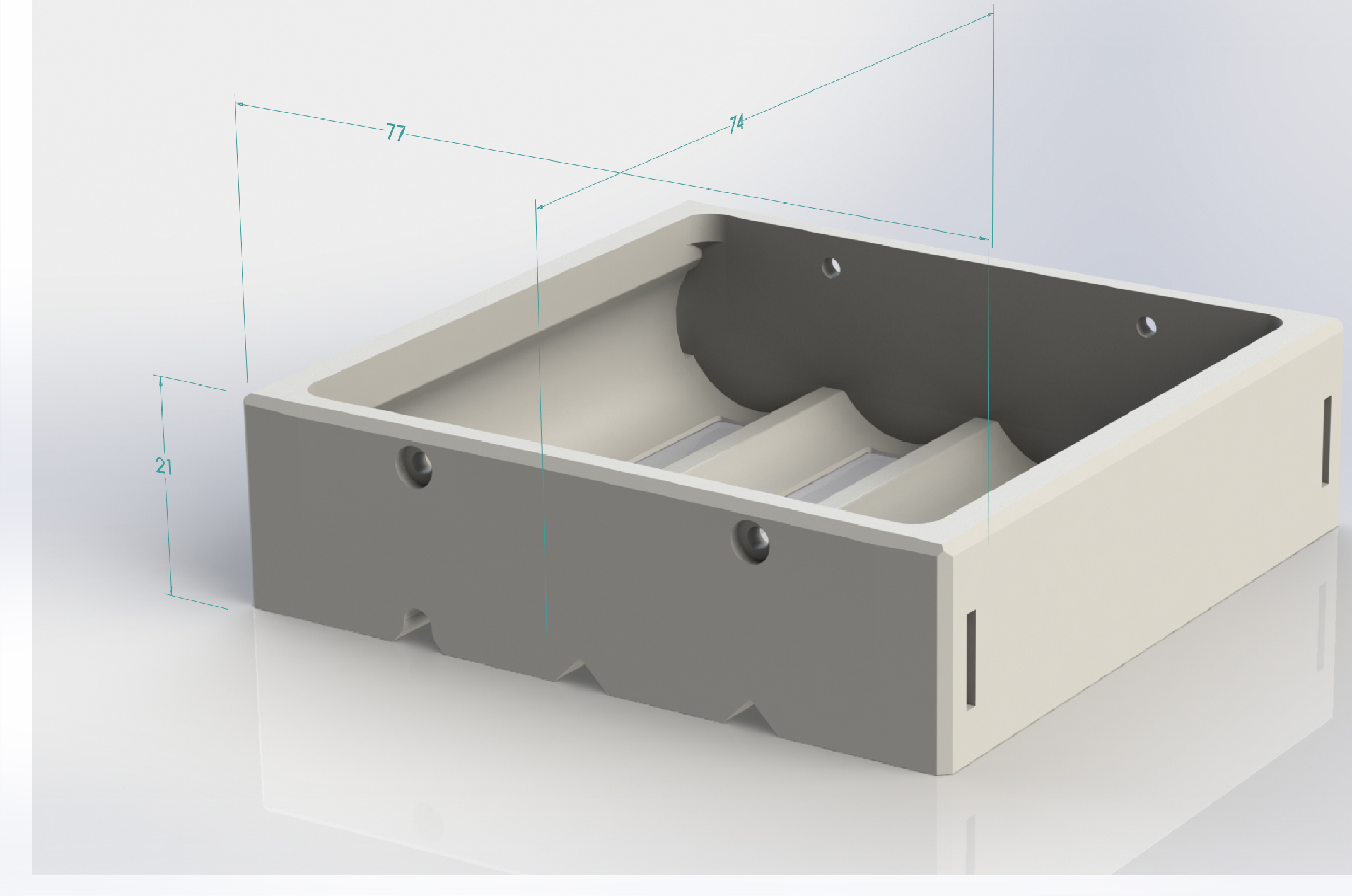

Not sure if you started but what are the dimensions of a 4p block? Looking into my options for the haya.
2S4P and 4P modules respectively.
I was looking for a 3p, if too complicated I can edit the step file myself.
You the best!
Not complicated at all. I have them all in terms of equations. Just change a single number. Also you can’t just edit the stl files because the walls are curved in a particular way to help with the compression.
I have two questions for you though:
  1. 2S3P or just 3P?
  2. with the protrusions for mounting using dampening standoffs(like in the battery pack) or just plain ones seen above?
BTW, if you don’t already have 3P tabs, I can send you brand new ones. I have them from making 5P pack(8-5=3). Cost will be 3/8th of what 8P tabs cost.
I would say 2s3P, with protrusion (I can cut them of if I decide to not use them). Sure I’ll get the tabs. PM me the details. Thx!
