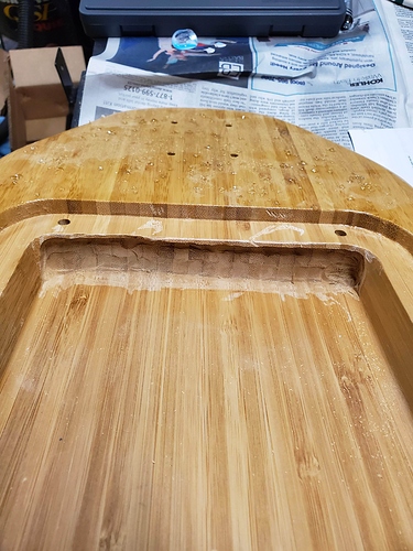

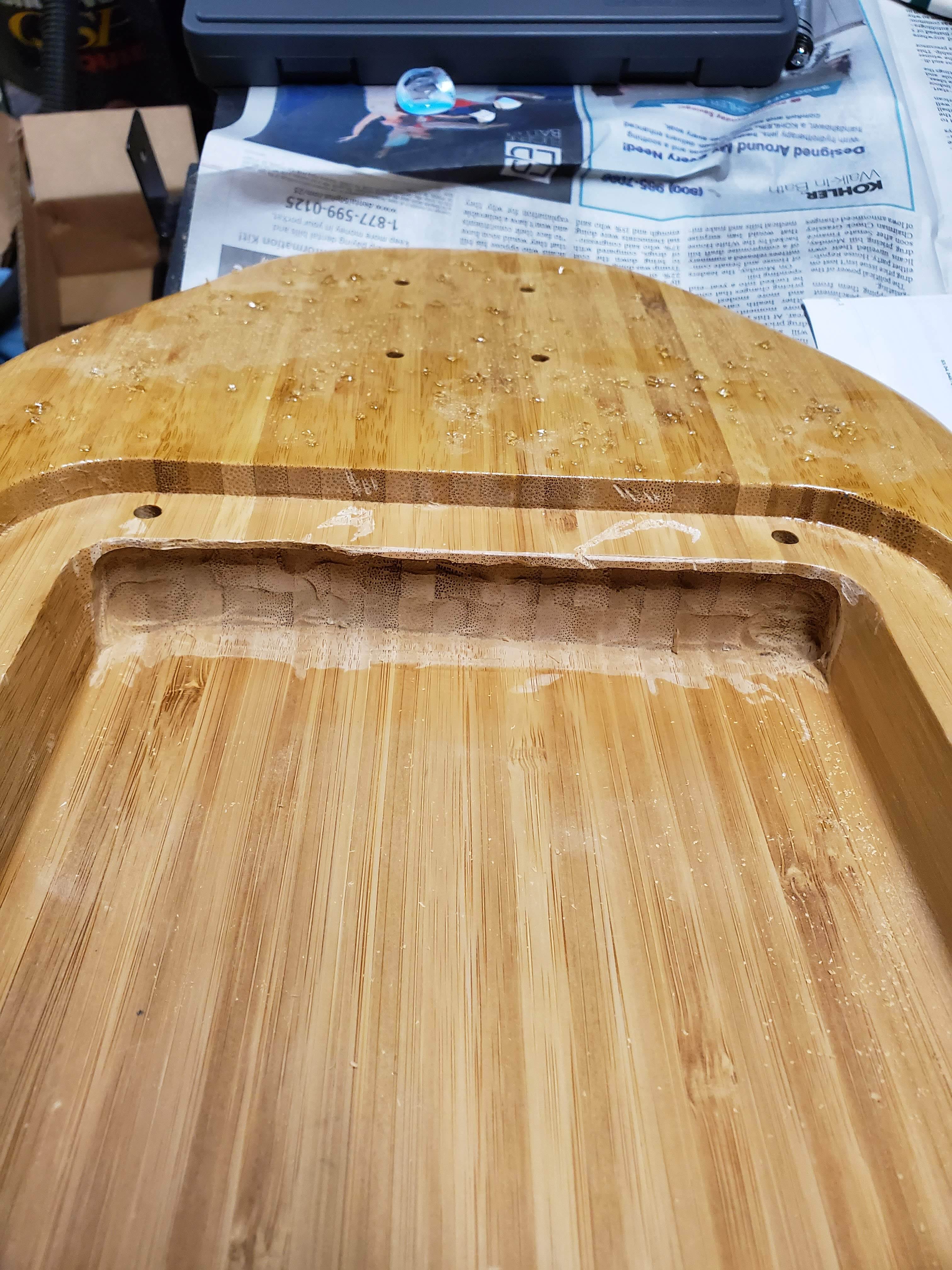

Well, I hope I don’t regret it, but I went ahead and routed out some material in the front. A bit of a hack job with a dremmel, but it turned out ok. I left about a lip that the battery can slide under at the top to try to keep as much strength as possible.

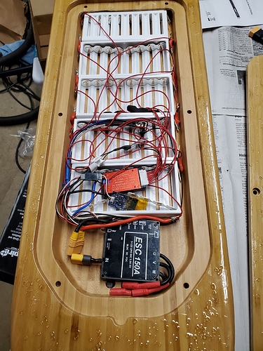

Now the battery slides up and gives space for the esc.

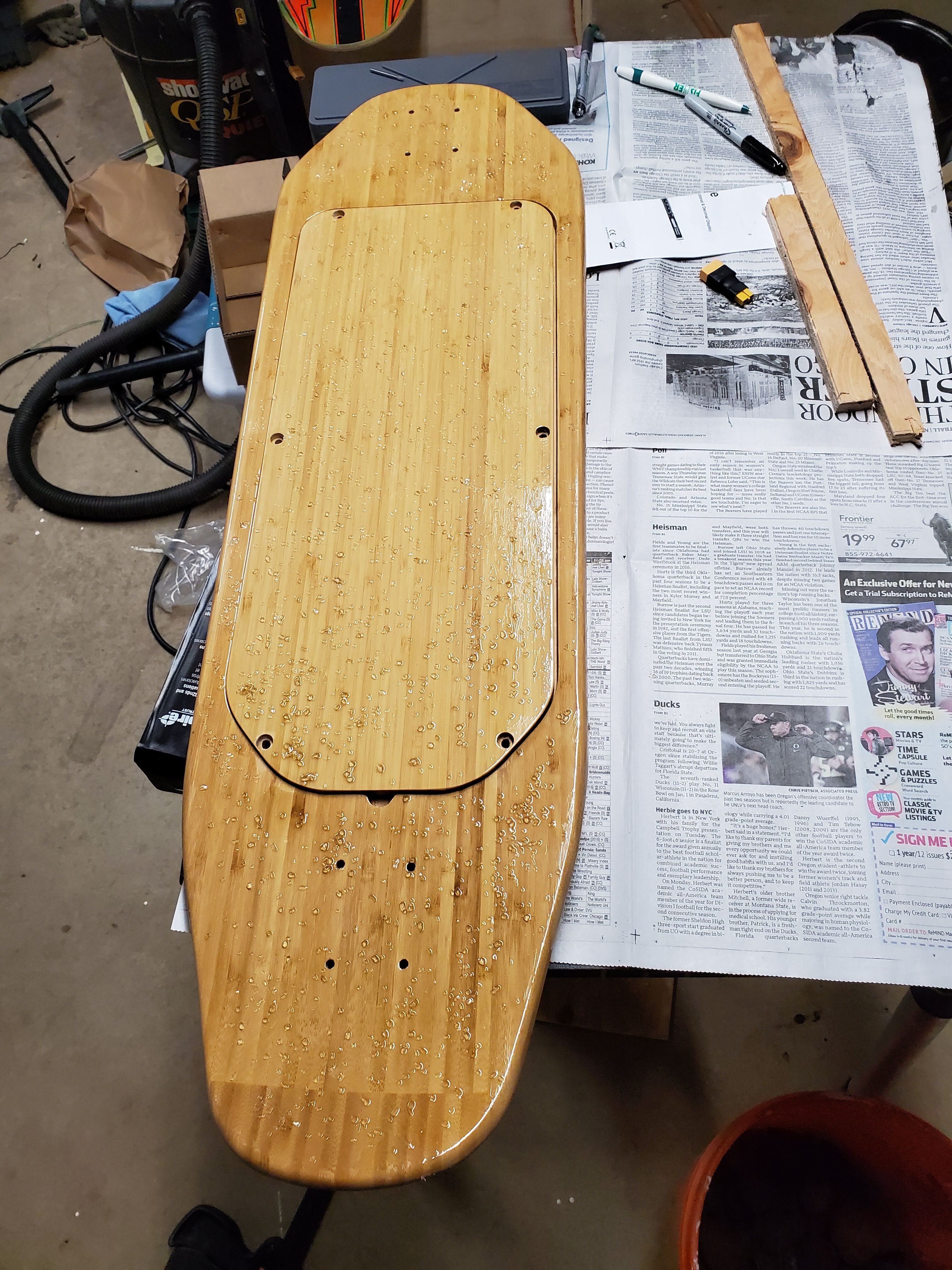

And the lid now fits.
I still need to fit in the connections, but it should work now.
Will the screws drive into the battery? Looks like the slot goes under the holes
No, I did not go all the way to the holes.
Must be careful for removing this material. It weakening material and can crush battery. Is needing some reinforce now or can breaking.

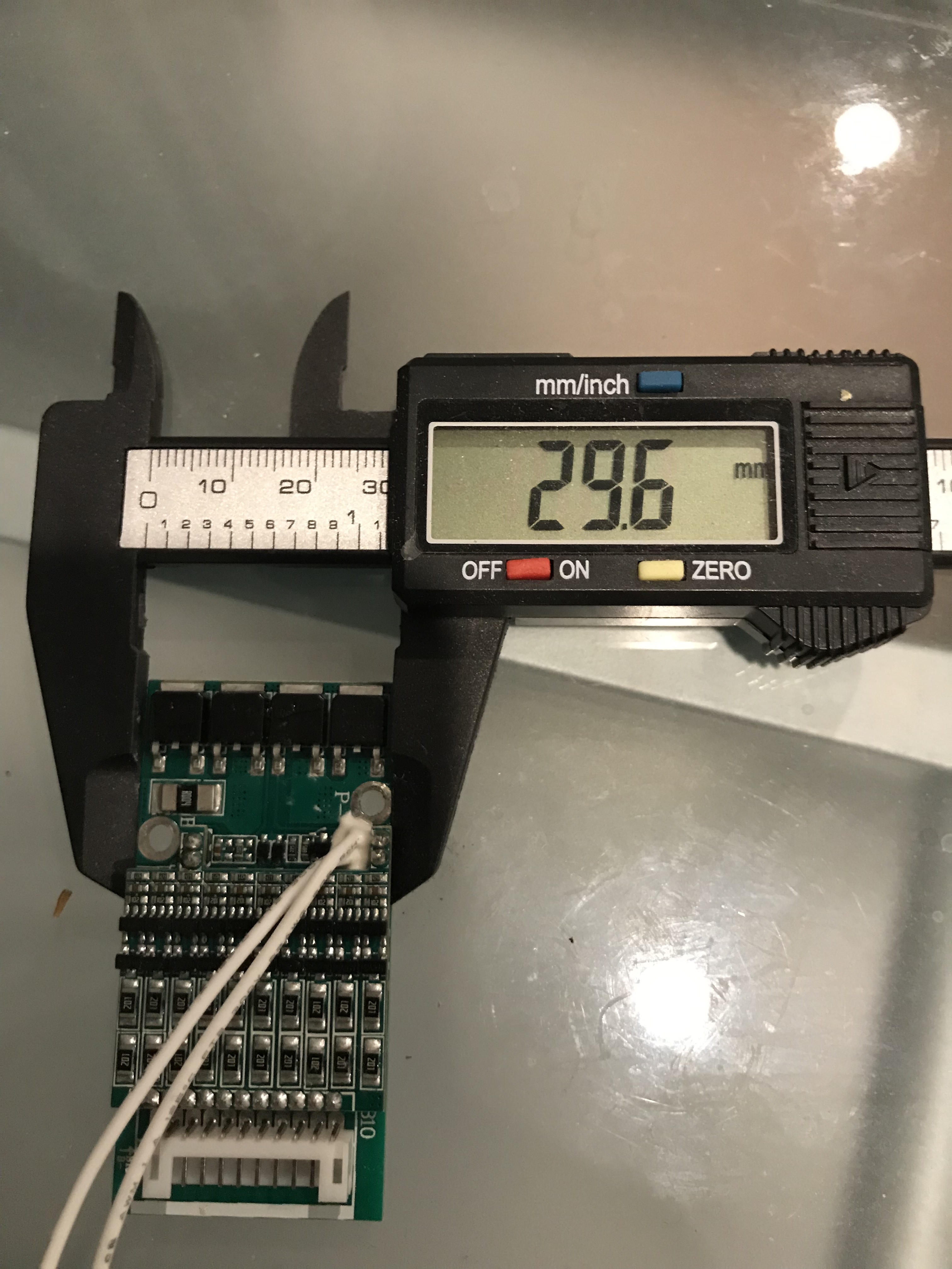

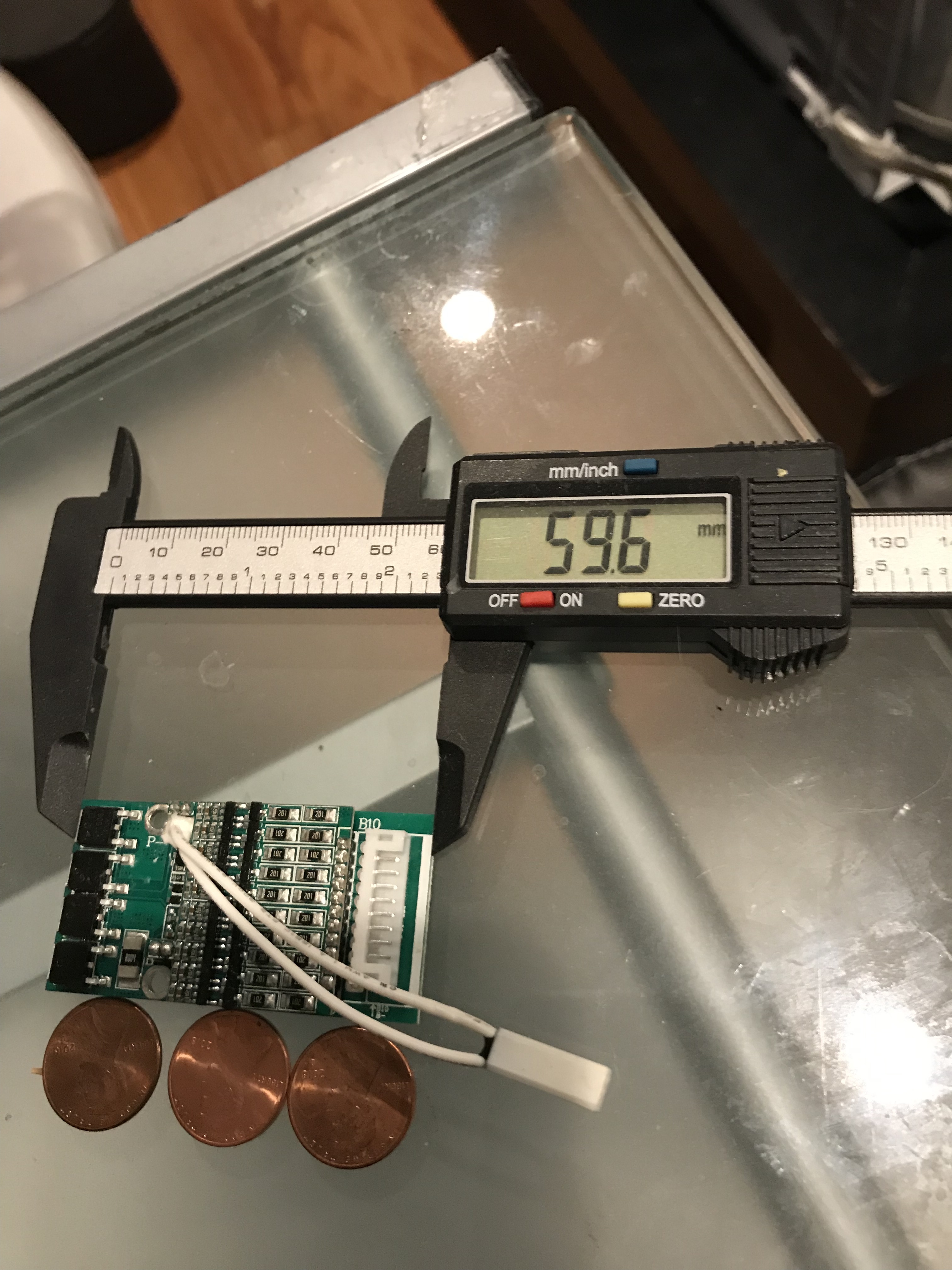

Hmm, idk what I will do. Have to choose between external BMS, or maybe buying 4 2s4p modules and having an 8s4p battery. :thinking: If only there was a super thin BMS option…
Also, deck arrived cracked. My build will have to wait. Deck size is awesome though, and looks clean too. Will try to glass frit the top just like @Tbone did.
The 10s waterproof BMS will fit fine…36x9x49mm
This one is also pretty small 10s
The lid has a matice support. You should be able to fit the BMS between these supports to gain some height
