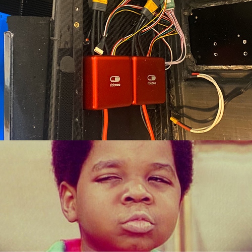

Mine have been giving me side eye since the day they came.
