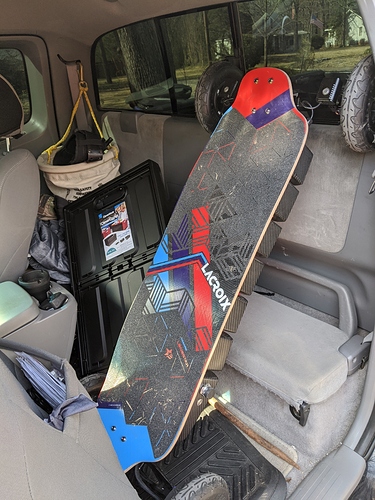

But that statement is wrong. I have 2 very flexible decks that do 35/42 respectively and better than the majority of stuff decks.
Regardless by making the statement and “leaving it up in the air” you didn’t actually tell the guy anything but biased him against flexible decks with zero demonstrable proof.
you literally going after my opinion with your opinion Dr…because if you can cite your sources here in this thread right now, you win this argument. I’ll wait.
42 mph
35mph
Both my boards and I’ve built a few dozen. Lastly, I’m speaking from experience and not just what I heard. So, yeah, there’s that.

JK but you linked 2 boards with very wide platforms, which means the flex is constrained to vertical compliance, with much less torsional flex (wobble inducing). Cut the rails off both those boards and tell us how stable they still are.
There’s nothing inherently wrong with flex boards, but if the front and rear hanger can twist independently due to torsional flex, then speed wobbles is much more likely and stability goes down significantly. Especially if not channel trucks, the deck angle has an effect to stiffen the deck in one direction.
