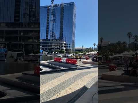

Most would have seen a few highlights from the ERL Elizabeth Quay Cup in Perth Australia (surely at least the stack into the water video!)
I couldn’t have had a better showing being fastest qualifyer, and winning all three races to take out the Esk8 Pro. My board was the clear advantage I had over the rest of the competition. Can’t wait to watch the races back when the footage is released.
The BRPs performed very well on the bumpy surface and felt solid as a rock down the main straight with my 3-links at speed. The smooth wooden bridge was the only time I felt a little sketchy so I backed off over bridge.

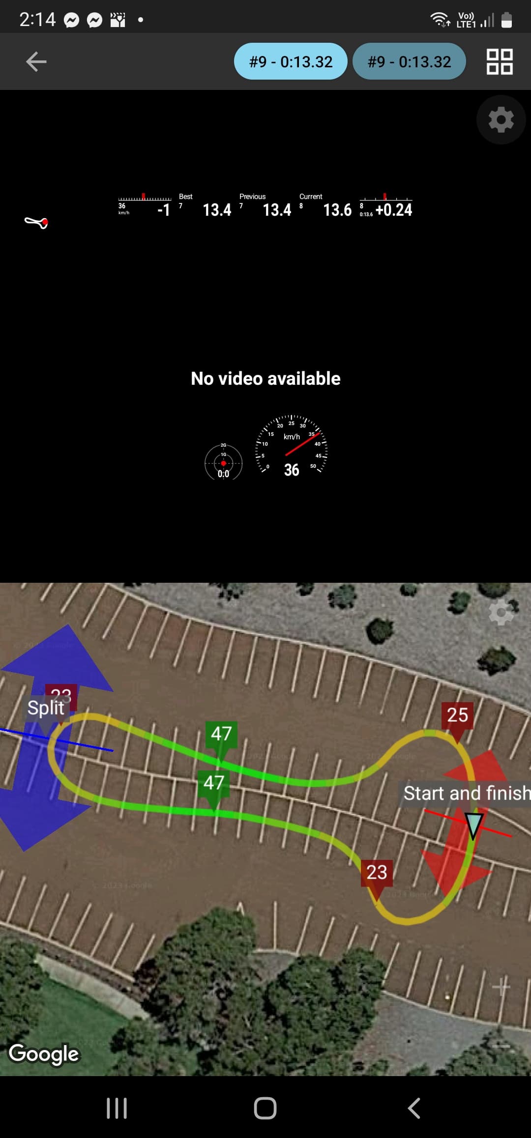

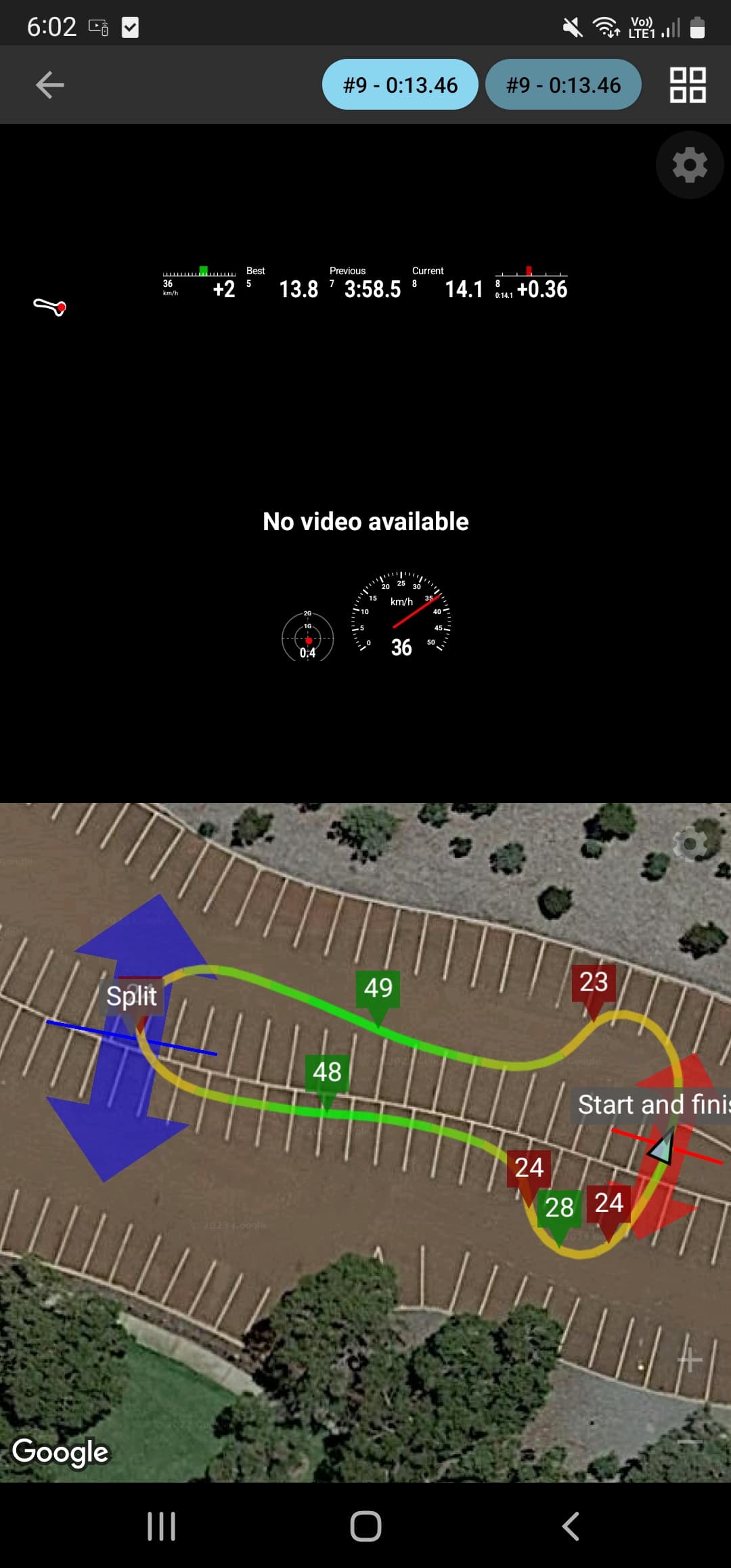

T Racing has been going well too with a few pbs on recent outings. The last session moved me up a place in 1 Lap rankings and I’ve secured top spot on the 3 Lap ranking for the time being. I know that spot at the top will be short lived but it’s nice to see some reward for the many laps I’ve been putting in to improve.
I’ll have a Race Box Mini S soon so monitor lap lines and see if there’s anymore time I can make up :crossed_fingers:

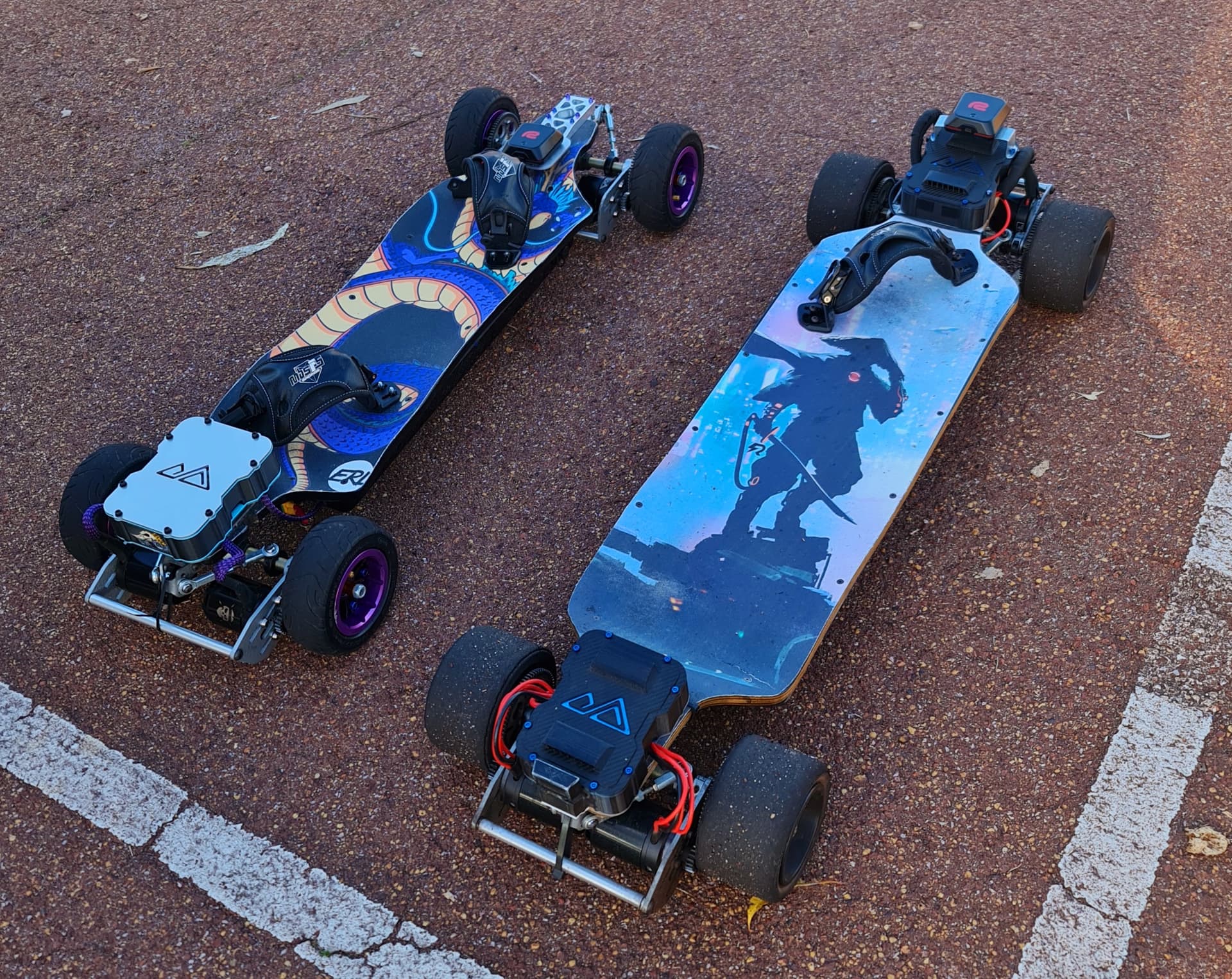

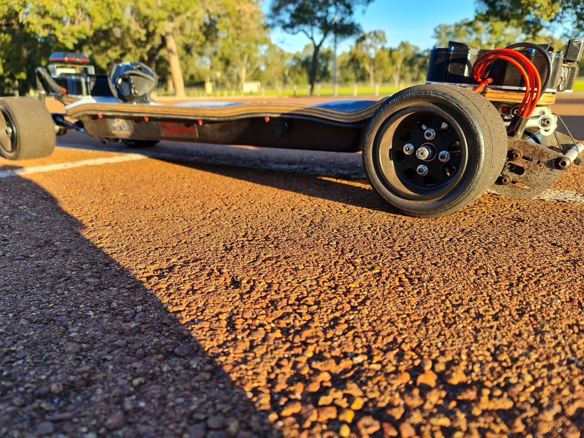

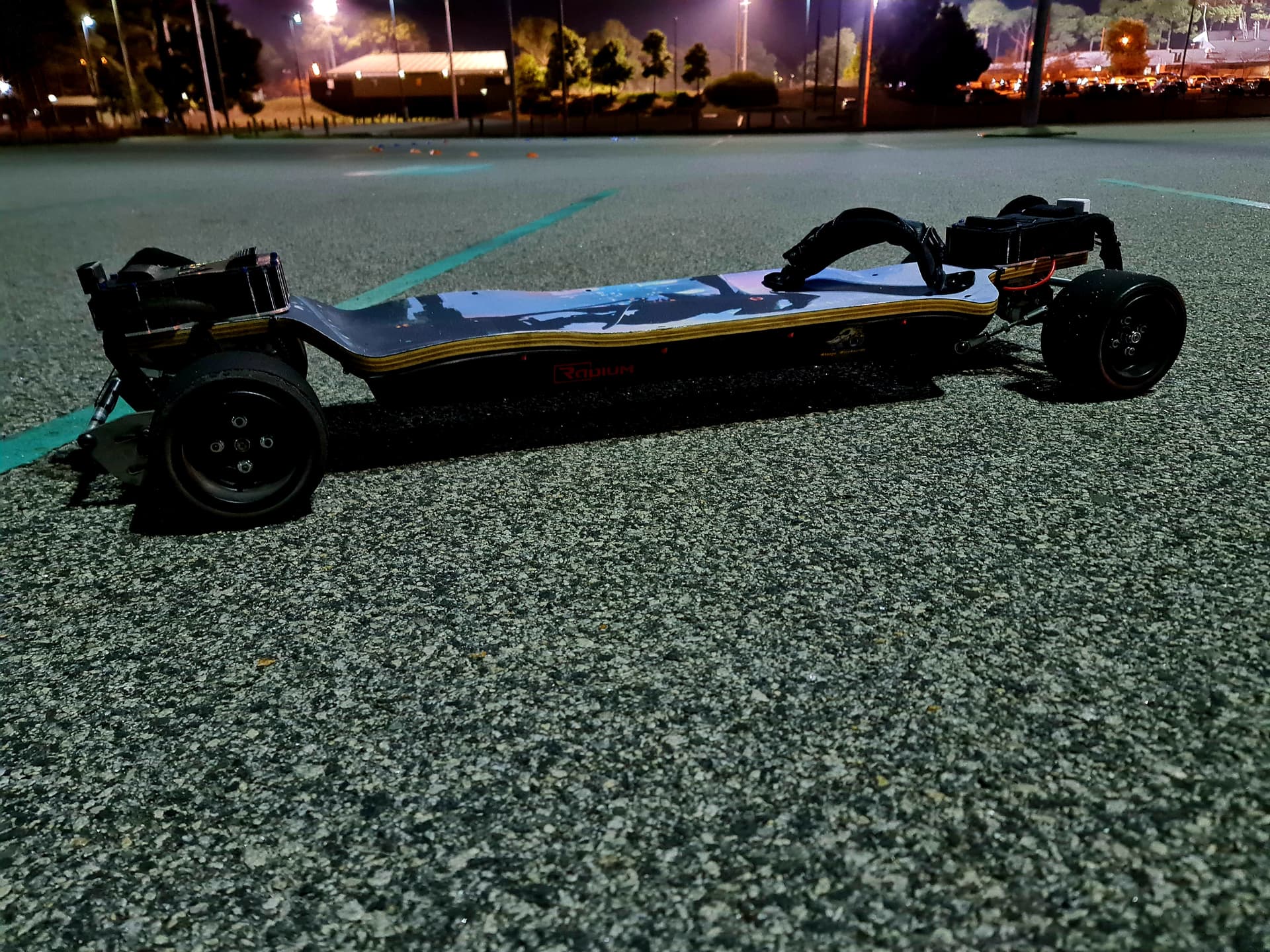

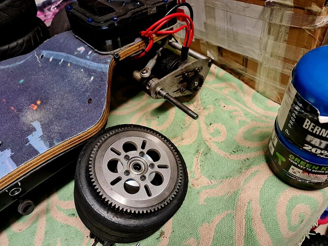

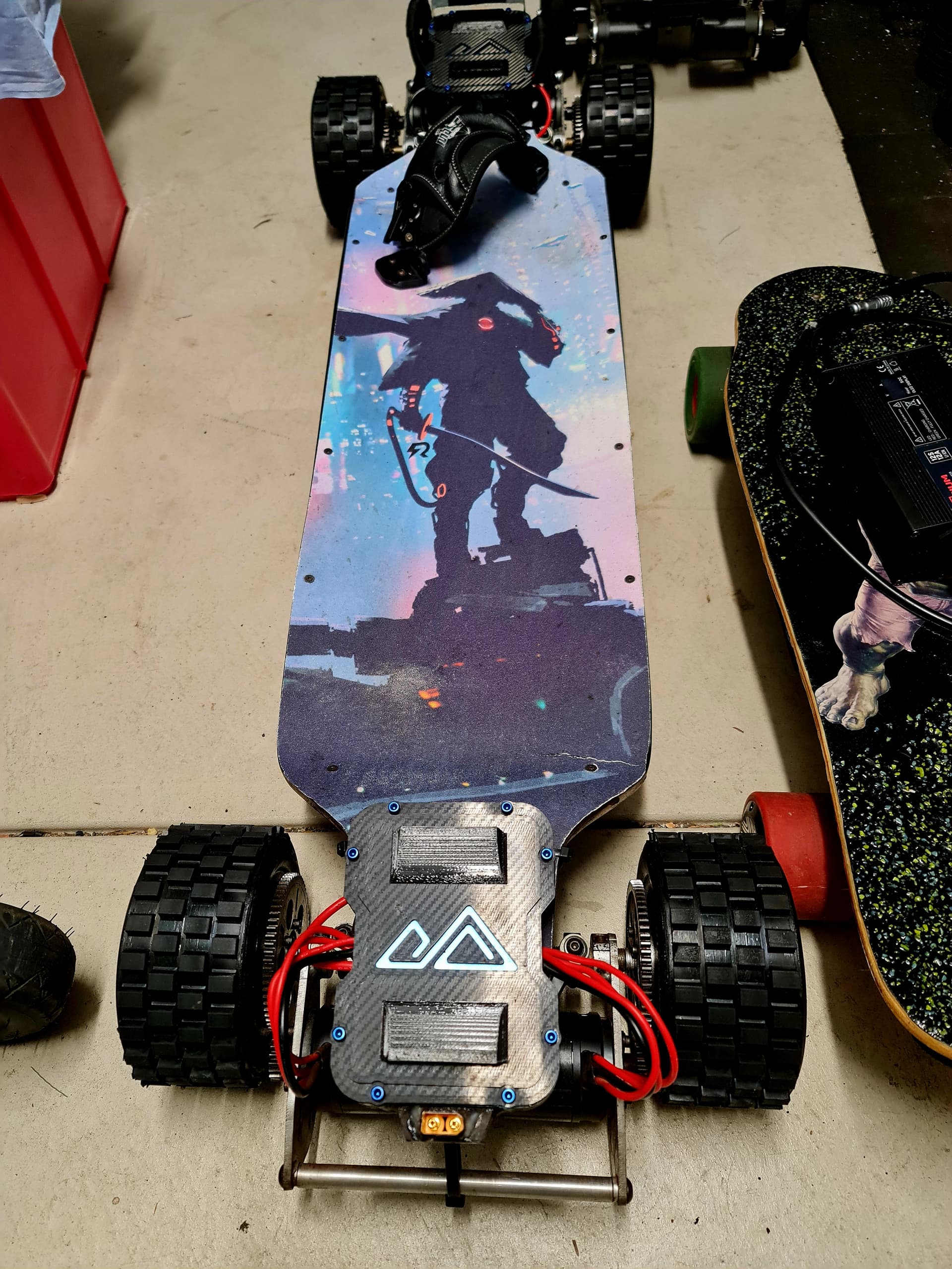

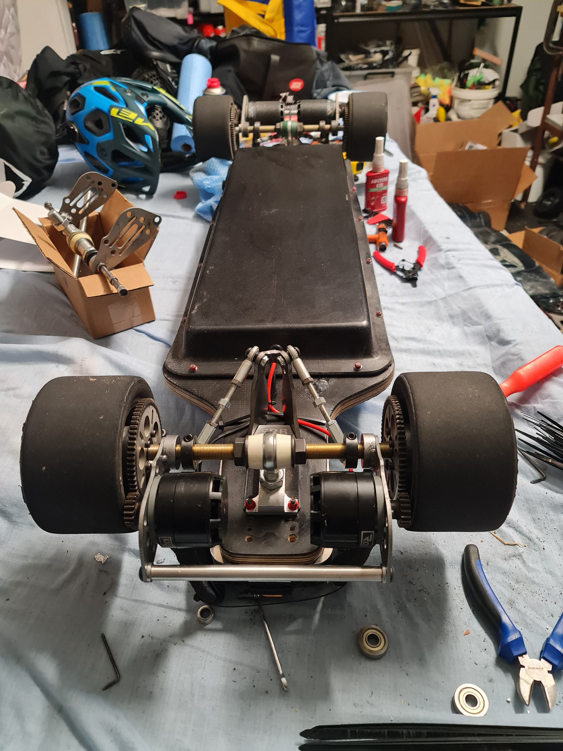

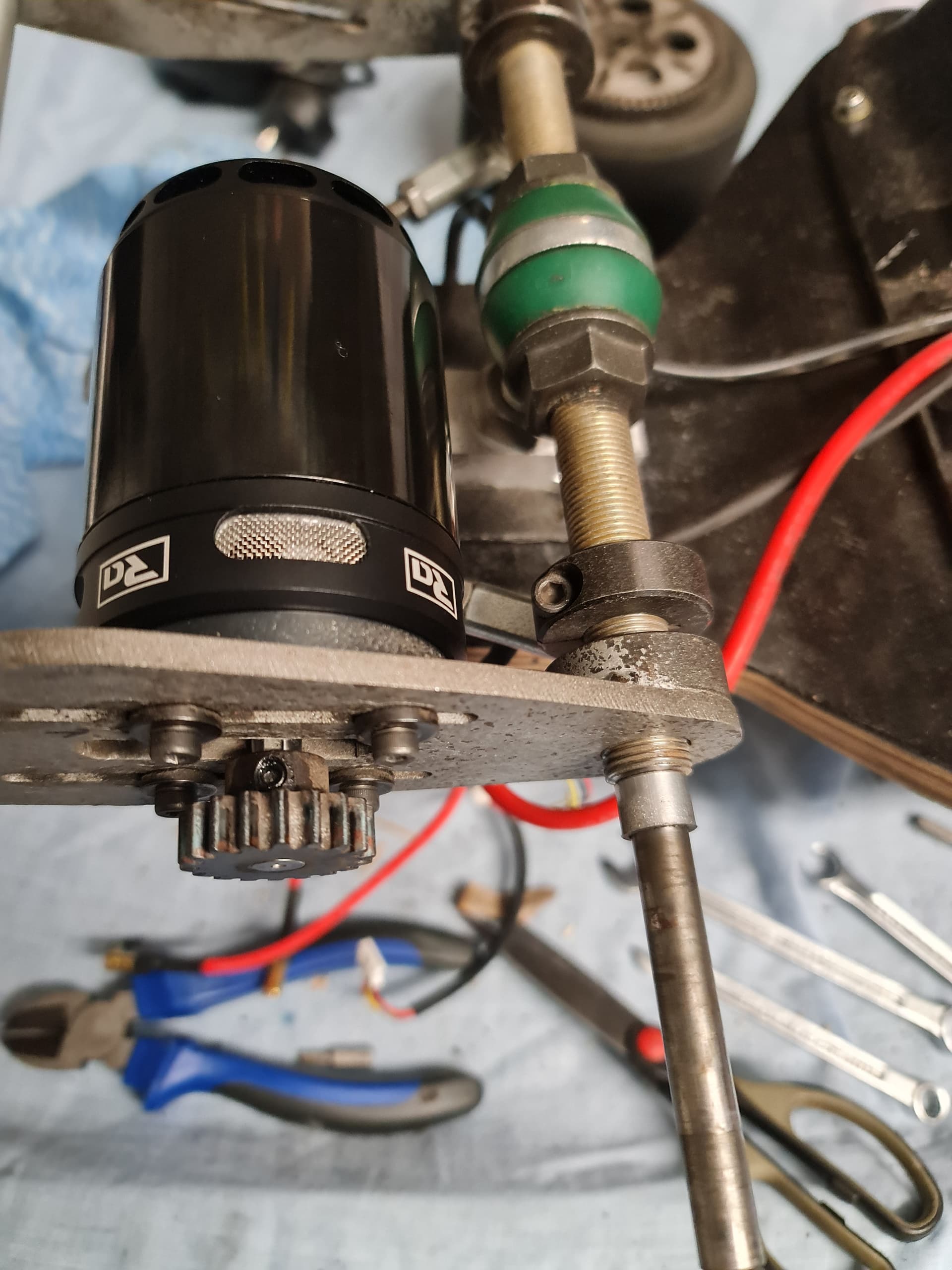

Front end changes:

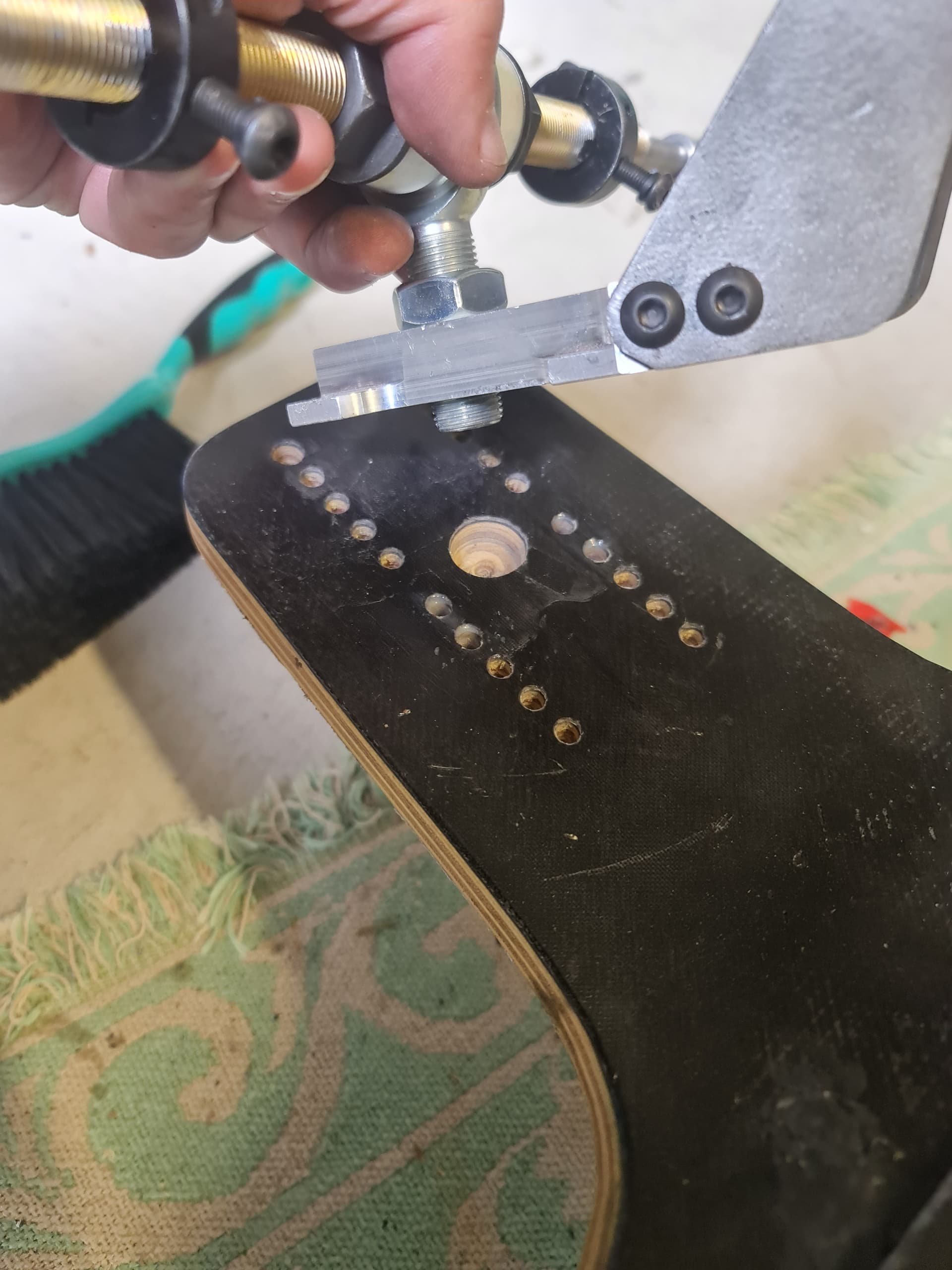

Few upgrades. I changed to inward mounting radius rod bracket to get the motors out in front so i can lower the ride height. Drilled the deck to allow lower ride height of 3 links. Also brought track width in to the minimum (no spacers on front axle now). Changed to the new HD axle too with new bushings.
Took her out for a spin after adjusting the front only and ride feel was quite different. The front end was quite divey. The narrower track width and the fact the front is lower than the rear probably why. I think i need to tighten front bushings too. Once i lower the rear as well and tighten the front bushings i think it will be an improvement. T race times were mid 14s with this adjusted setup and worn rear tyres so good initial signs.

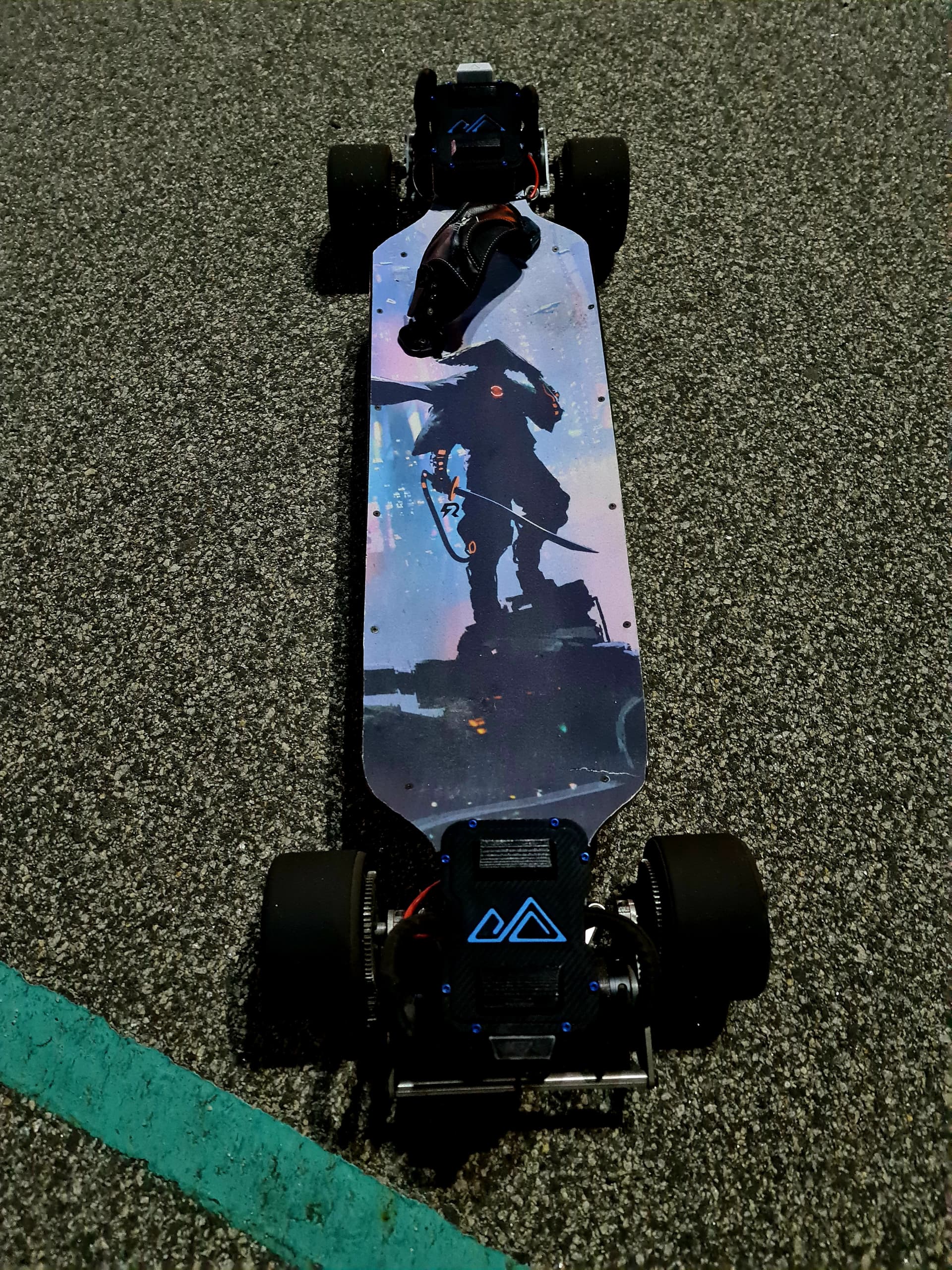

Then changed the rear:

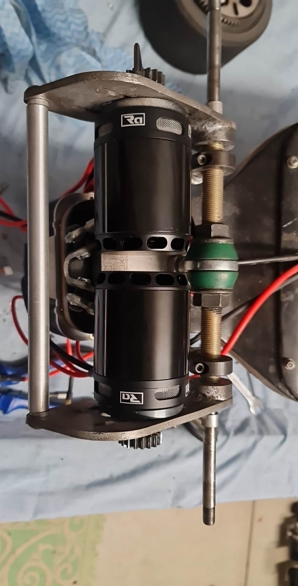

New Radium Performance 6385s as the PREVIOUS Reacher V5s had a sensor die (something grinding in that motor too).
Also lowered the ride height on the rear to match the front. Brought track width in about 15mm too.
Hoping to get it finished this week to take out and test.
Gah damnit I want a full radium setup! When I ordered my 85’s radium was out of stock and then I order 55’s and he posts his up a week later :pensive:. Setup looks sick man, my boards have always felt better the closer they are to axle height, you’re spoilt with that single stack. Did you stick to 205kv?
Thanks man. Yeah still 205kv with 18/67 gearing for now.

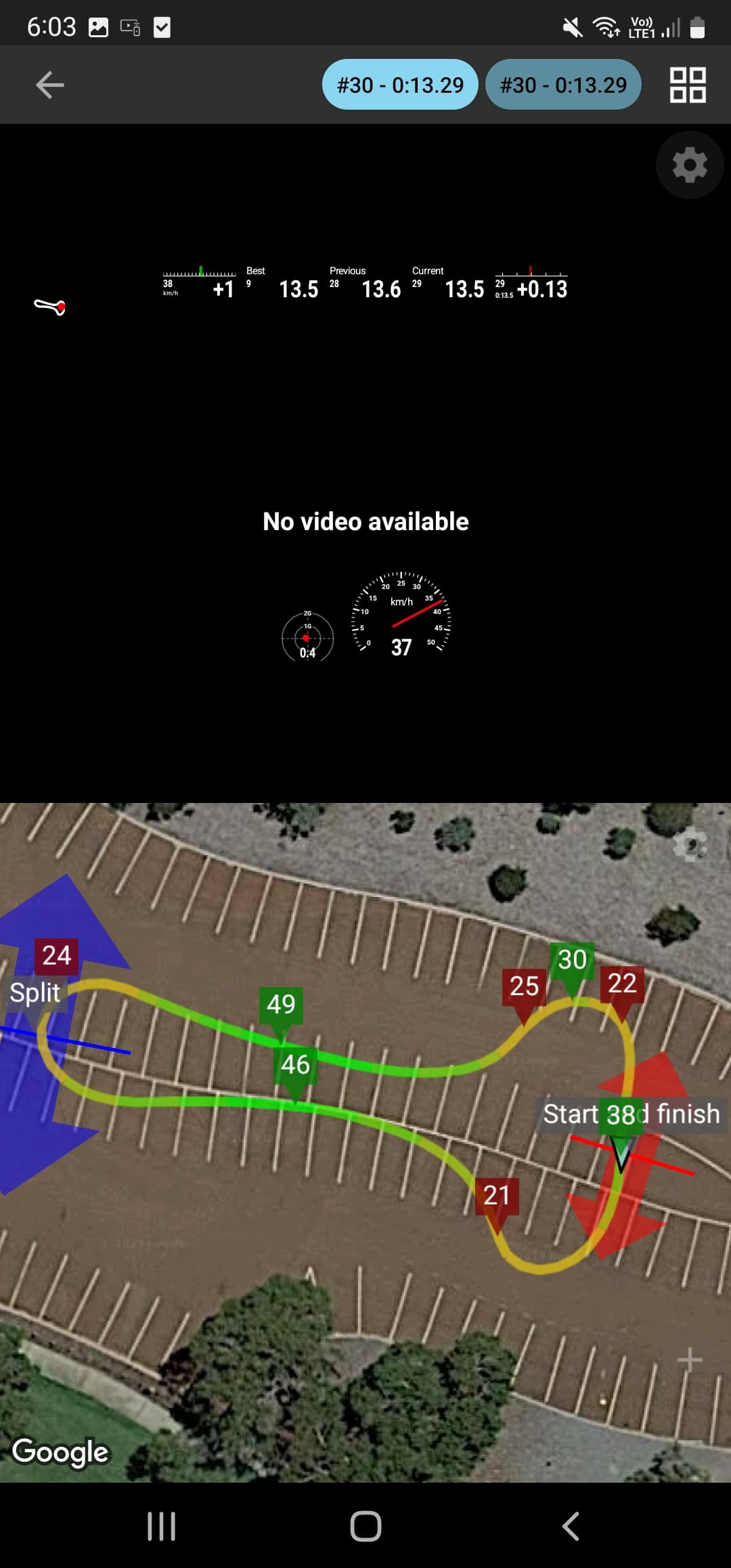

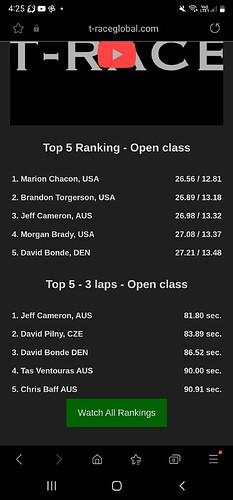

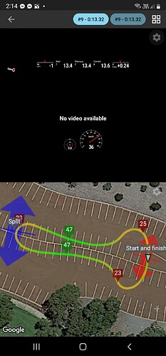

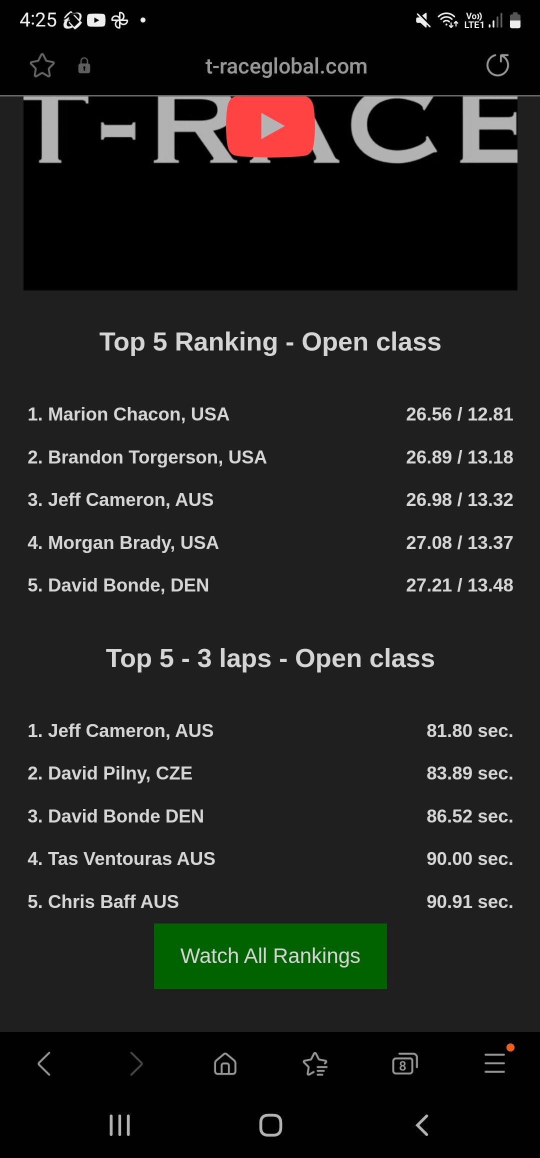

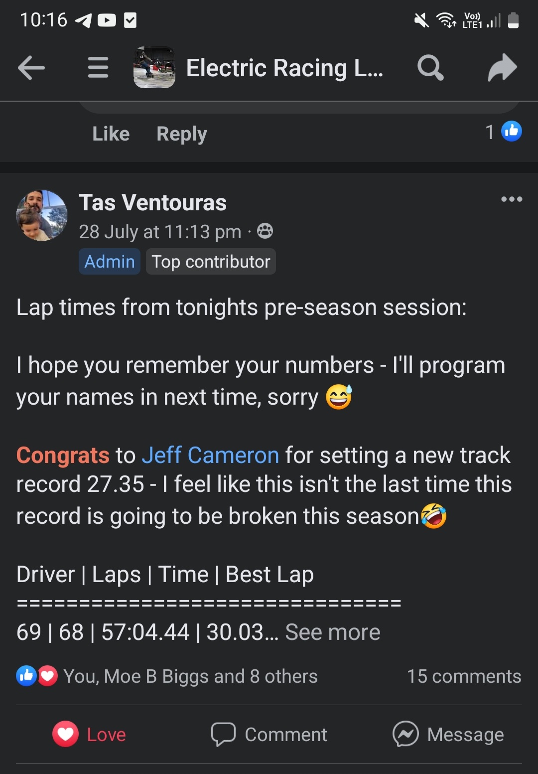

Been plugging away at T Racing lately and momentarily got myself into the top 3 before @Mbrady grabbed the spot back. I still got a screen grab while I was up there for keep sakes haha. I tried again tonight to sneak back in front but couldn’t do it. Hopefully some fresh BRPs and the upcoming T-Race World championships will give me extra motivation to sneak back into podium position. Check out the event here: 1st T-race World Championship

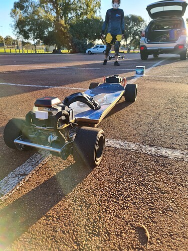

@Tasventouras came out for a T Race session to dial in his new race board and he’s definitely going to be one to watch out for when he gets a set of BRPs for the tarmac! His board looks bloody incredible too :fire:

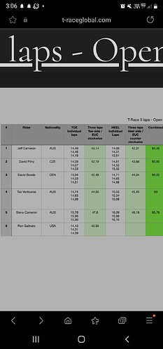

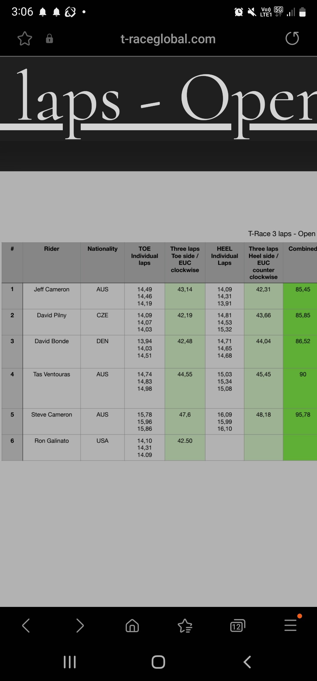

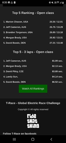

I’ve also busted back into podium position for T Racing snagging 2nd spot! I’m loving this little competition and it really motivates me to keep pushing. I had to take a screen shot of the leaderboard again as I really feel this will eventually take off and my name will tumble down so holding onto that glory for now!

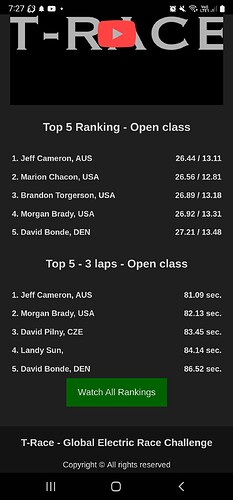

T-raceglobal.com top spot in the 1 lap and 3 lap leaderboards!! I’m so stoked to achieve this feat and definitely worked hard for it!!

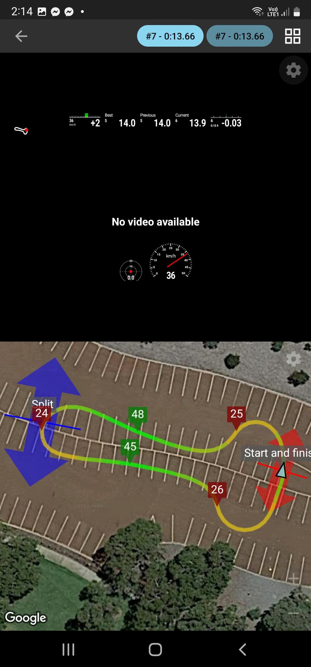

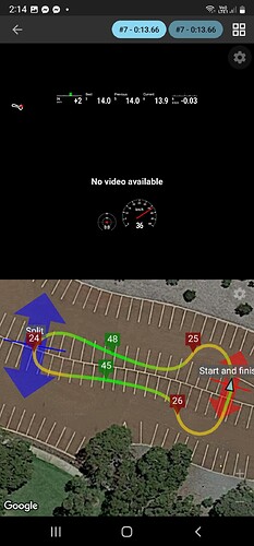

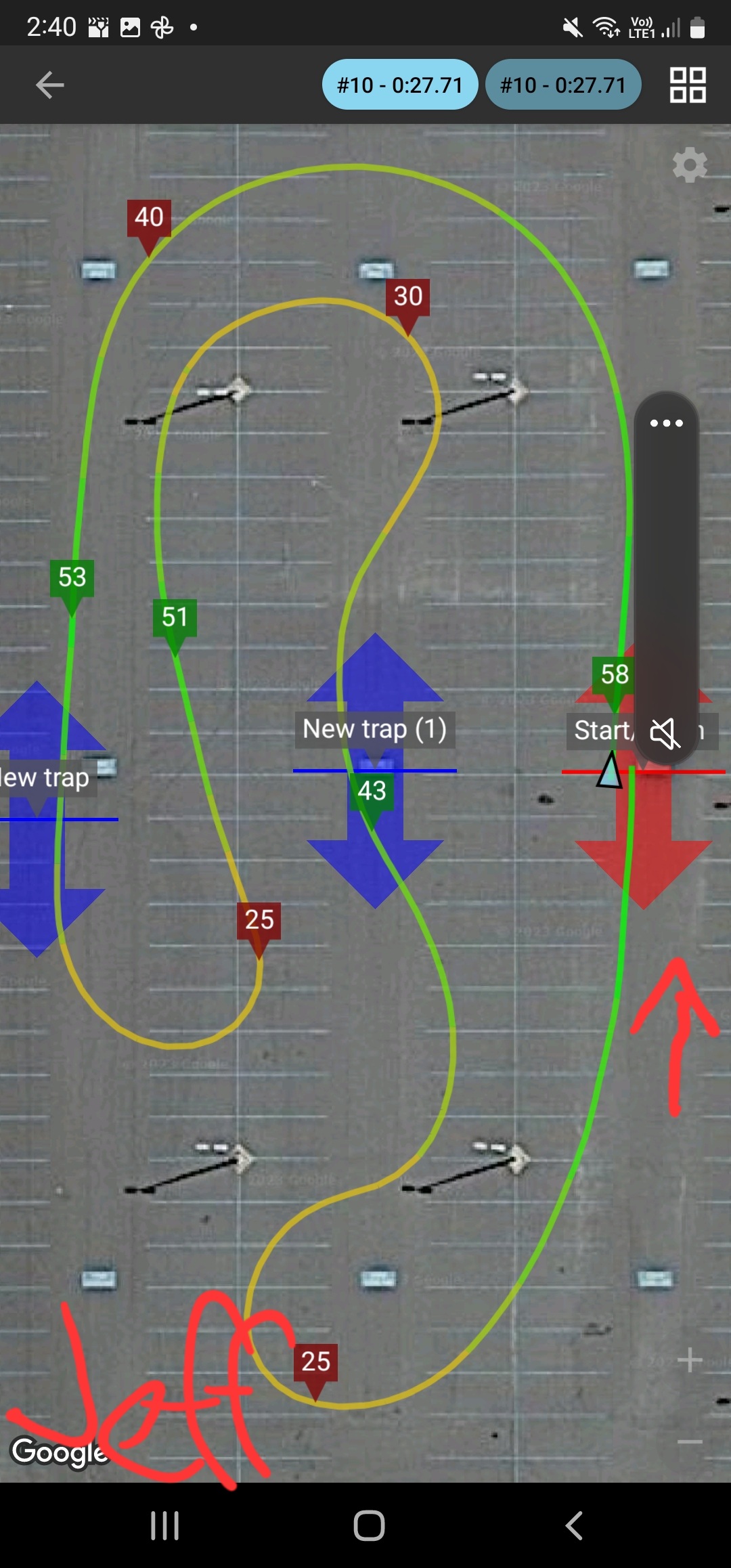

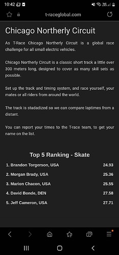

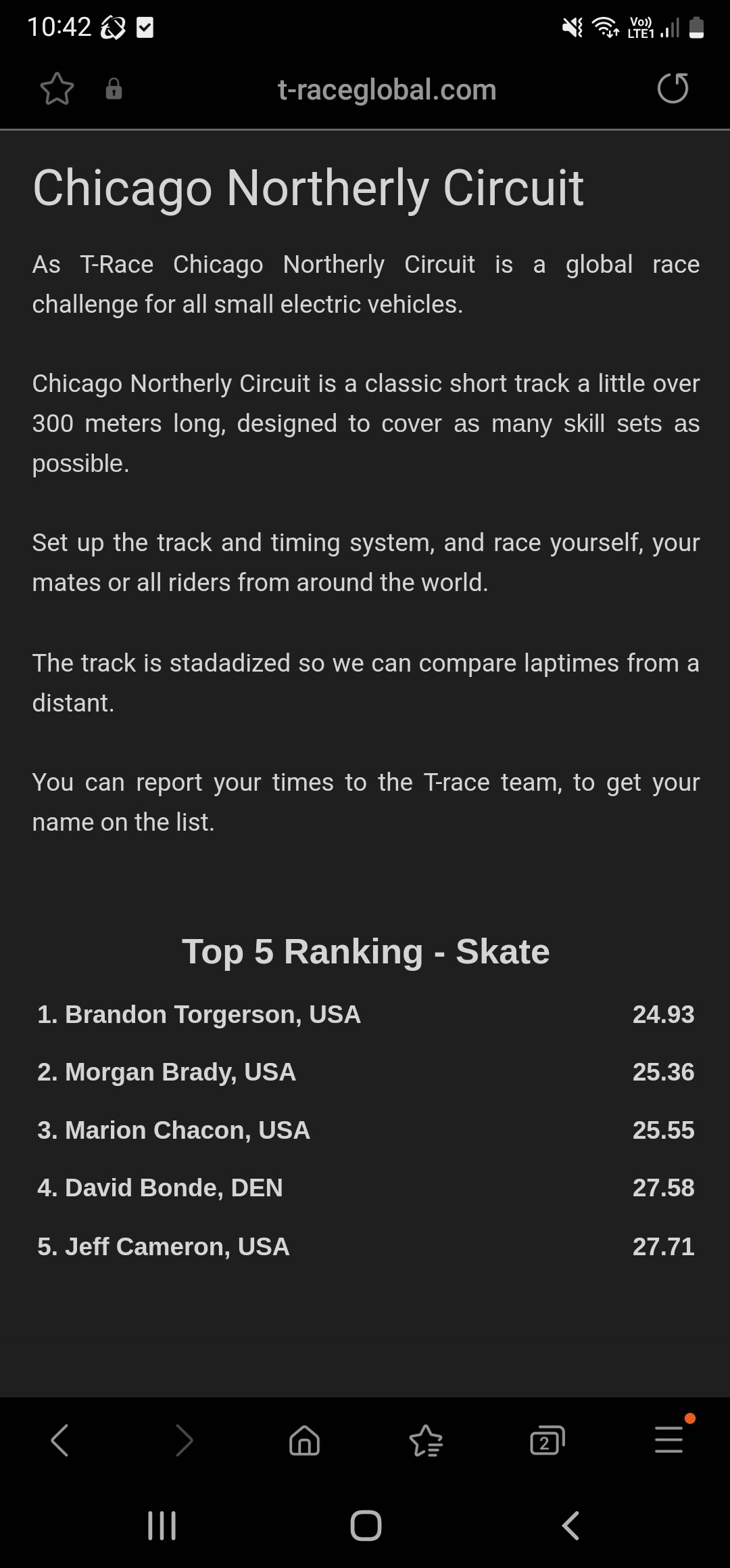

So onto the next challenge of the Intro 2 Speed Chicago circuit designed by @Mbrady. I’ve had two and a half sessions on this track now and made it into the top 5 but some way off the pace still! I think my top 5 spot was already beaten recently but i took a screenshot while I held the spot.
I’m maxing out down the straight so I’ve changed my gearing tonight to get me another few kph. It’s a gamble as I’ll lose some torque but we’ll see if it helps with lap times :crossed_fingers:.
The last thing I’m going to try as well on next outing is to run my Hoyt Puck remote in reverse to hopefully get a bit more juice off the line by removing the inbuilt throttle curve.
Next session will be interesting and I suspect the new settings will take a bit of time to adjust to, as I was feeling quite ‘as one’ with my board previously.
