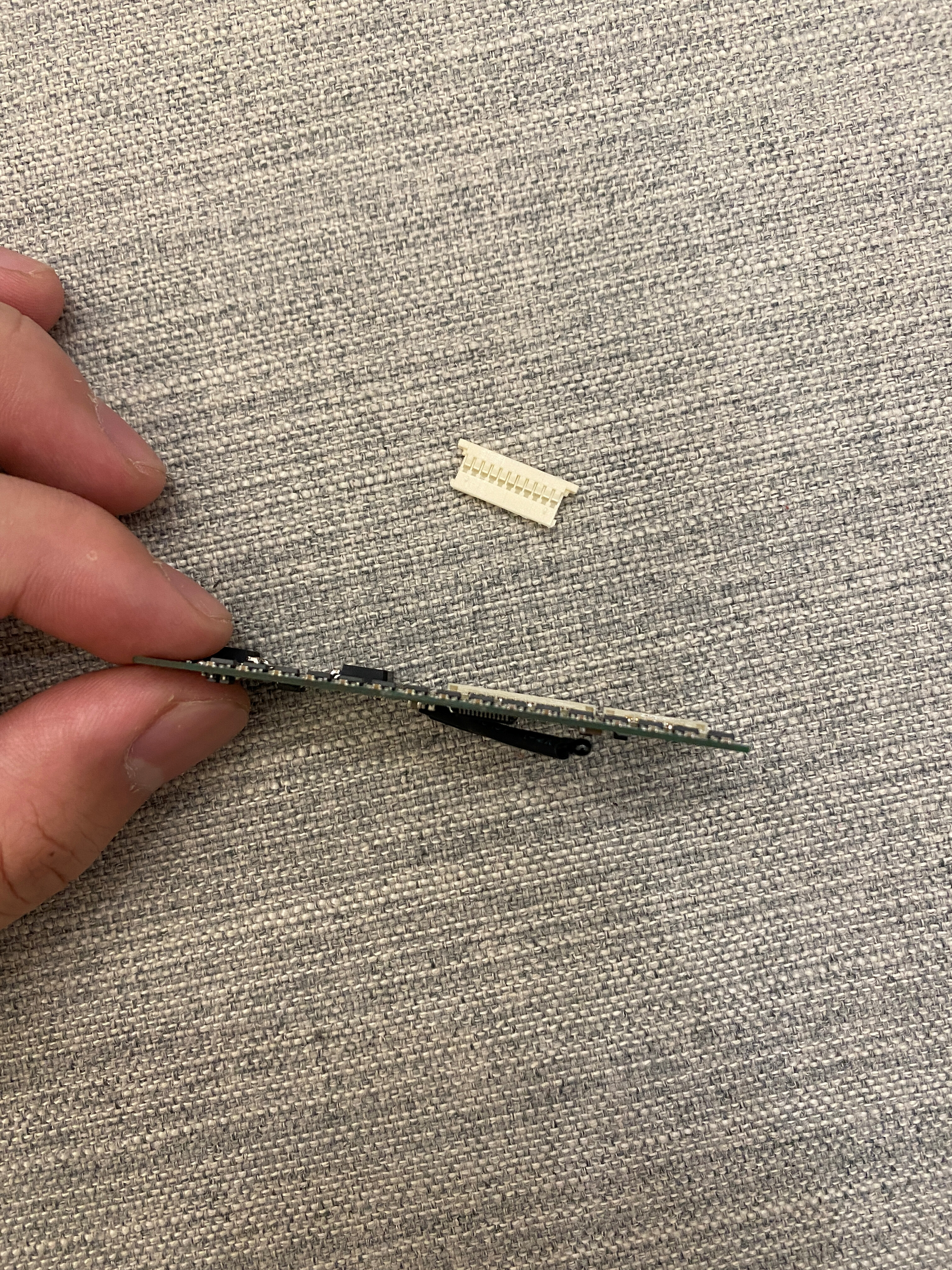

Some more pictures, showing the thickness
![image|666x500] (upload://u5ZGwZ6igGXTQaIyvTiLeTIF5aW.jpeg)
will run some test(charging a imbalanced pack with high current)
and we will do a trial production
This connector is surprisingly robust and anti-vibration, it takes about 15 kg of pull force to get it off, and they have metal clips on the side and 2 plastic notch on the top to click itself in place, to my experience, this takes way more effort to get off than the dalybms ph2.0 port which has no clips to hold itself in place.
Excellent! Thank you for the photos.
I am looking forward to hearing the results of any temperature testing you might do. With the main MOSFETs and the balancing resistors creating heat during charging things can get pretty warm inside an esk8 enclosure.
Just the two MOSFETs on their own will create about 4.5W of heat at 15A. The balancing resistors will add about 0.18W of heat each and all that can add up to a big temperature rise for a board as small as yours, especially with so little copper being available to spread the heat.
Small boards are fantastic but heat is always a challenge. :slightly_smiling_face:
Will your aluminum shield be used as a head spreader?
Nice one! Do I spot a BQ76952 in the wild :nerd_face:? And will it be open source :pleading_face:?
If you have then it won’t work as connected. :grin:
Chip markings are wrong though.
Wow this is looking sweet! Its so small!
Thats what she said
I’m curious would there be a way to implement a temp sensor?
Was just a guess, but if you say its not then I believe you :stuck_out_tongue: .
I believe that is a thermistor (temp sensor) that is connected to those two black wires seen in the photos.
