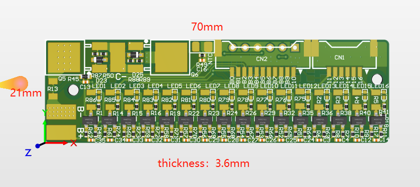

I am currently developing a BMS which features some exciting stuff and want some design input from you guys.
Features:
  1. Nano size: 21703.6mm.
  2. 5-16s configurable via PCwritetool.
  3. Balance current: 45mA .
  4. Super affordable $20+.
  5. Balancing led indicator.
  6. 15A charge current.

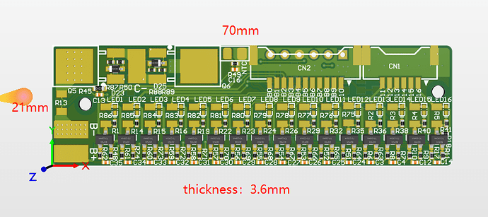

Proposal layout 1 with balancing indicators on the top

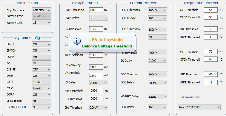

Configurable values and PCwritetools

I would love to see a button or link on that settings screen that brings you to a page with a short explanation of each acronym/setting. That will save you from having to respond to a ton of questions and will help reduce mistakes made by users.

In the PCwritetool, it explains the value when you mouse over it
What is the estimated max component/junction temperature (or design goal) for the board in an enclosed space without the aluminum case, assuming worst case balancing resistor heat load?
