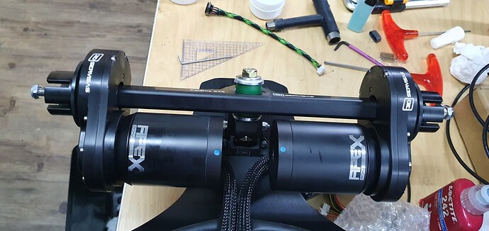

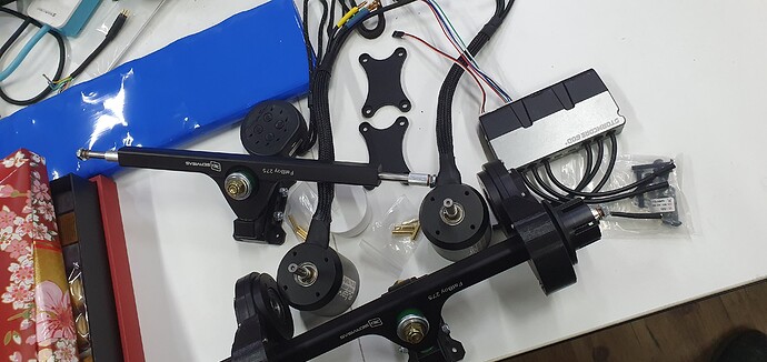

For the battery, i built a 12s3p P42A for him.
Yes i know… it can fit max 12s5p, so why did i not? This is a urethane build, and this is going to be a mid range type so we went smaller for this.
As for the rest of the components, we went with 3DServisas gear as it has top notch quality, the gear backlash has also been pre adjusted so its just sliding the motor on, grease, and lid it up. Easy assembly.

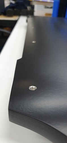

This is how i do my inserts. Drill the enclosure first, set it above the deck, use a pencil and trace the holes onto the deck. Mark an X, and thats your hole! No misalignment.

Such a clean build! Gotta ask what deck inserts did you use? You installed them so clean I wish mine looked half that good

The trick is to use another insert on the top before the actual one you use, so it doesnt rub on the deck hole. The OD of the threads measure 7.5mm, so i use a 7mm drill bit.

It’s 25mm, but the one i used for this pack is 30mm.
