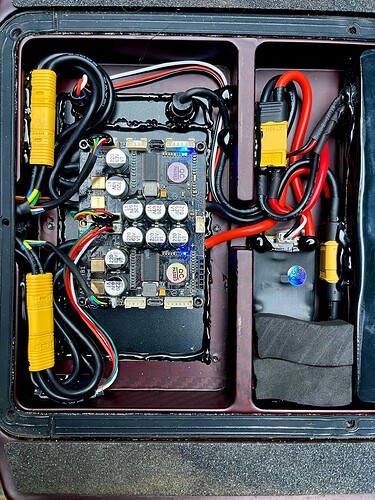

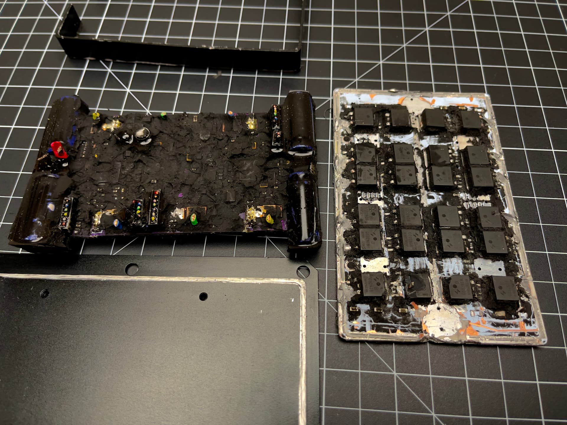

Thanks! Yeah, I still have to scrub off the potting compound.
Is that an aluminum PCB?
Yes it is

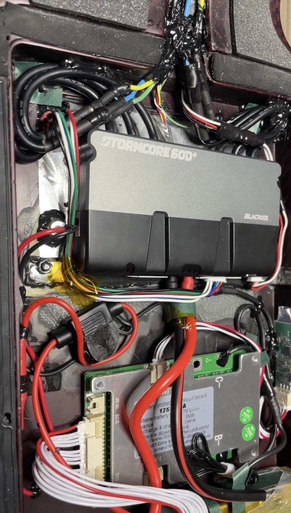

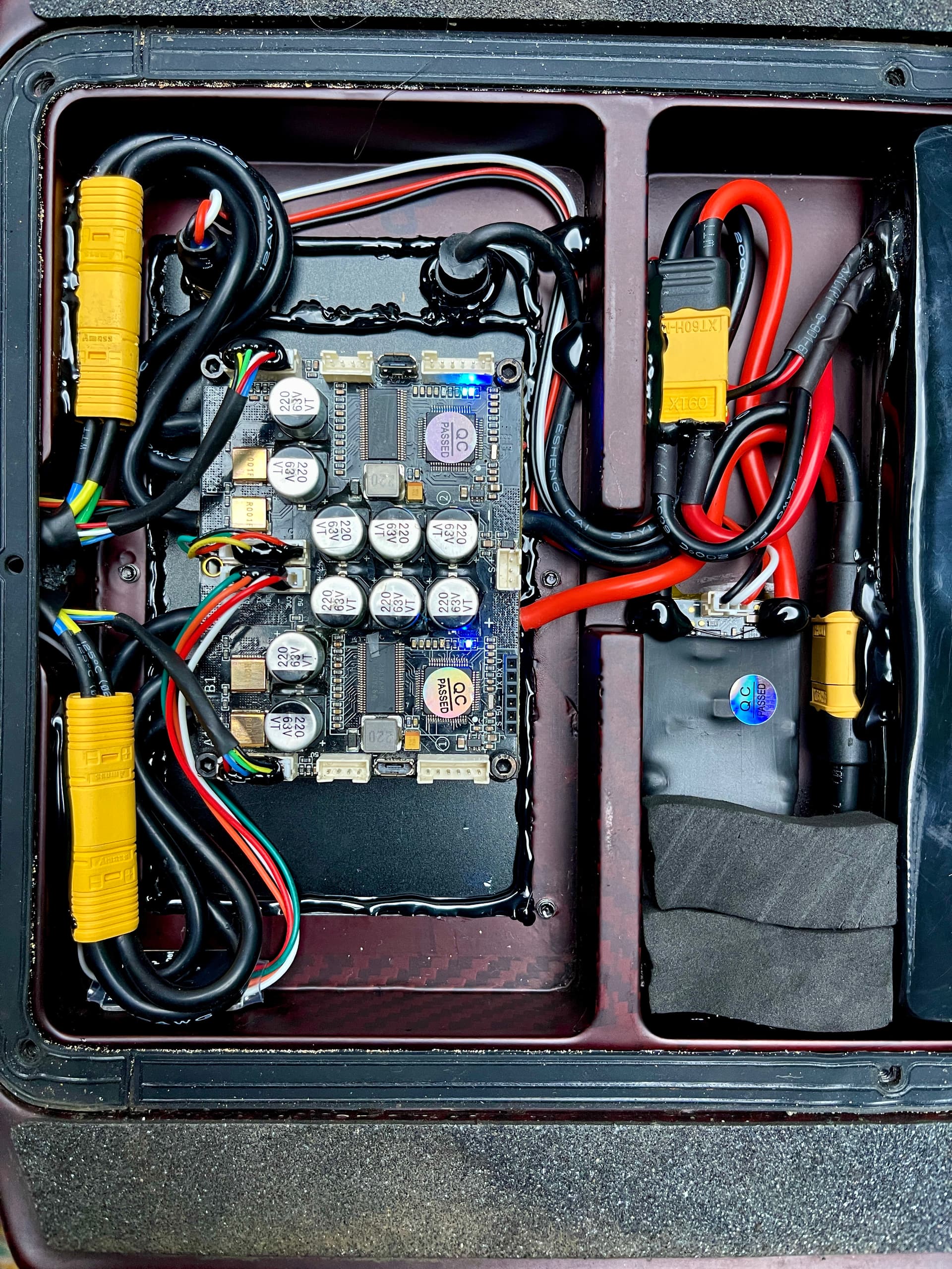

Finally finished. Unfortunately the Stormcore was too tall, so I used a Flipsky 4.20 plus with smart a/s switch and bt module. I tapped new holes in the heatsink and kept receiver externally mounted.
I have a stack of dead eovan esc’s, one of them nearly started a fire! :joy:
I replaced their shit ESC with a ubox and haven’t had any issues since.
Hoyt Puck with a 60D+ powered by a 12s4p P42a pack
video showing some of the steps - Eovan Carbon DIY - Stormcore / Molicel Battery Upgrade - 12s4p E-Skate Build - YouTube
Dang you could almost fit 14s4p in there with a tiny bms
16s4p fits with relocating the ESC :o
