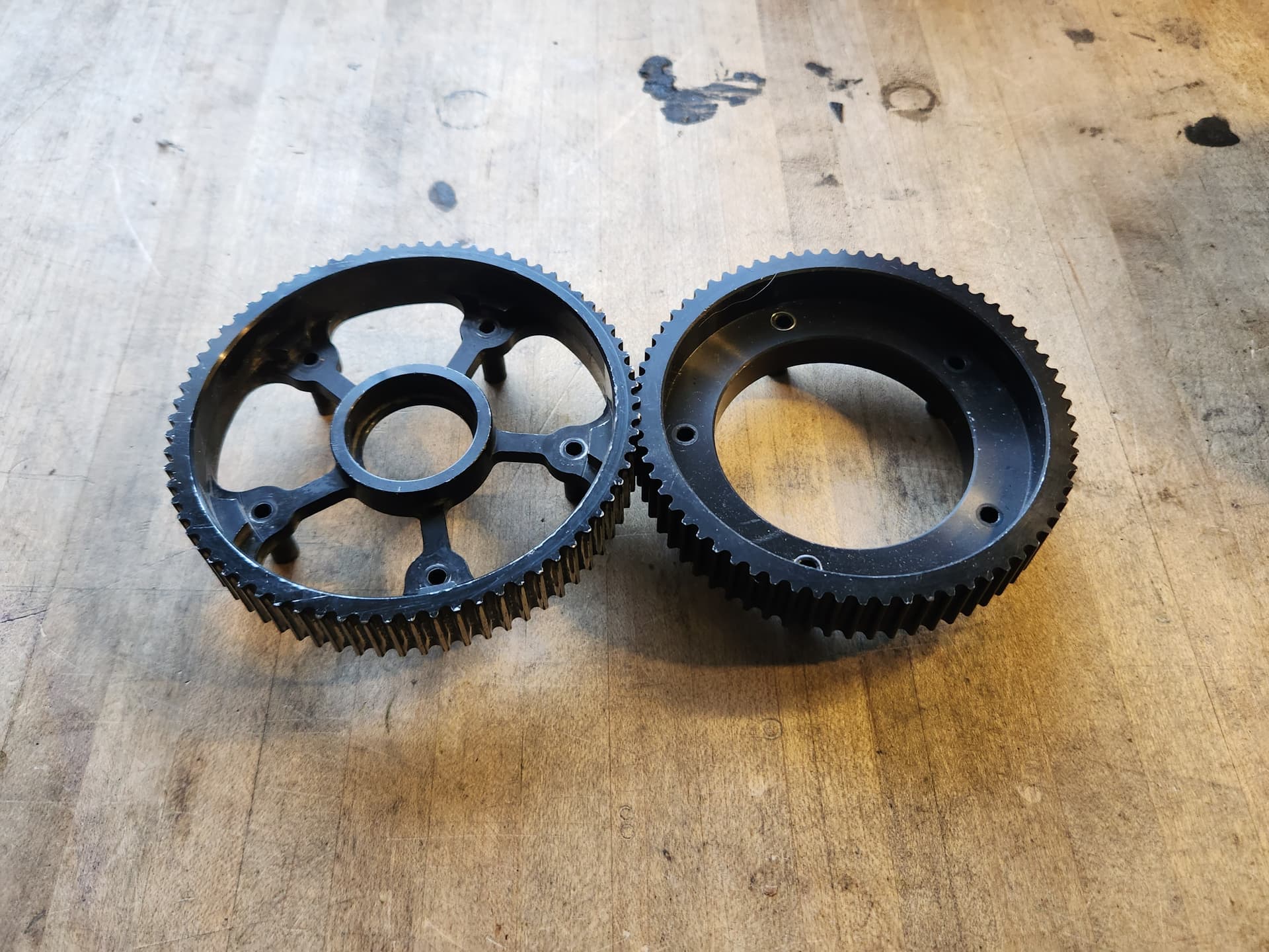

I wish the 4GS had a gear ratio in between 3.4 and 5. Im having issues with the BN drives before i can use them but im sure BN will send me a new motor gear to fix it. Im using 175mm tires for now and a 5:1 rqtio might be too high and 3.4 would probably make acceleration too slow im guessing.

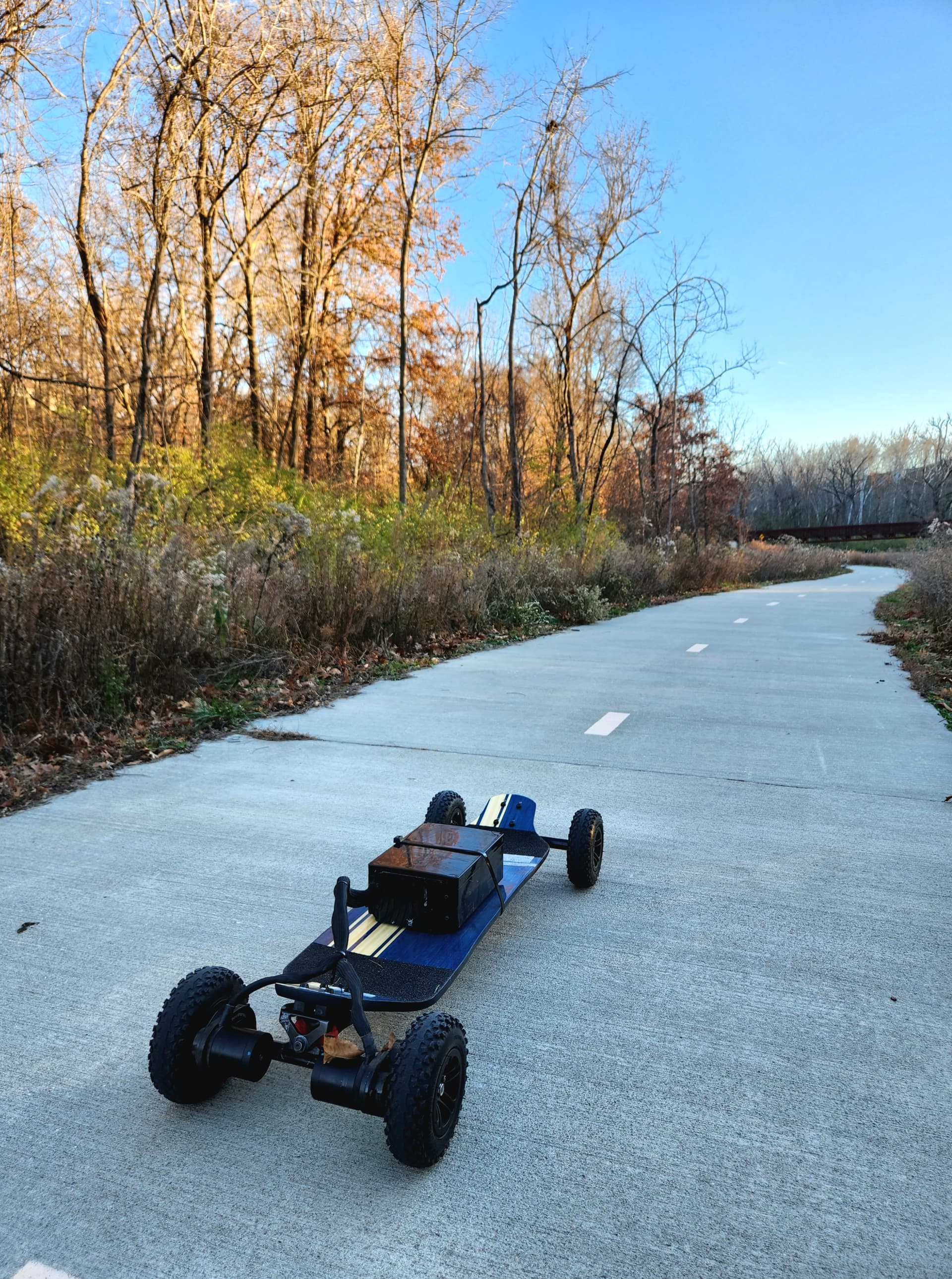

But I could not help myself and went out and did 6 miles on the Gravel Boi.
I even broke out the TSG pass to help with the cold. Cramped…
I think this set up will be a keeper.
The turning behavior seemed quite a bit different from both the Fluxes and the Khymera.
Makes me ponder trying the inner mounting holes.
Or more likely flipping the baseplates around.
I also have a set of Radium adapters coming for the Khymera but I might slap them on here first.
The tires felt good…and the drivetrain ran well.
This is definitely geared for torque And not top speed and that seemed good.

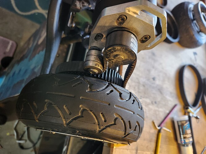

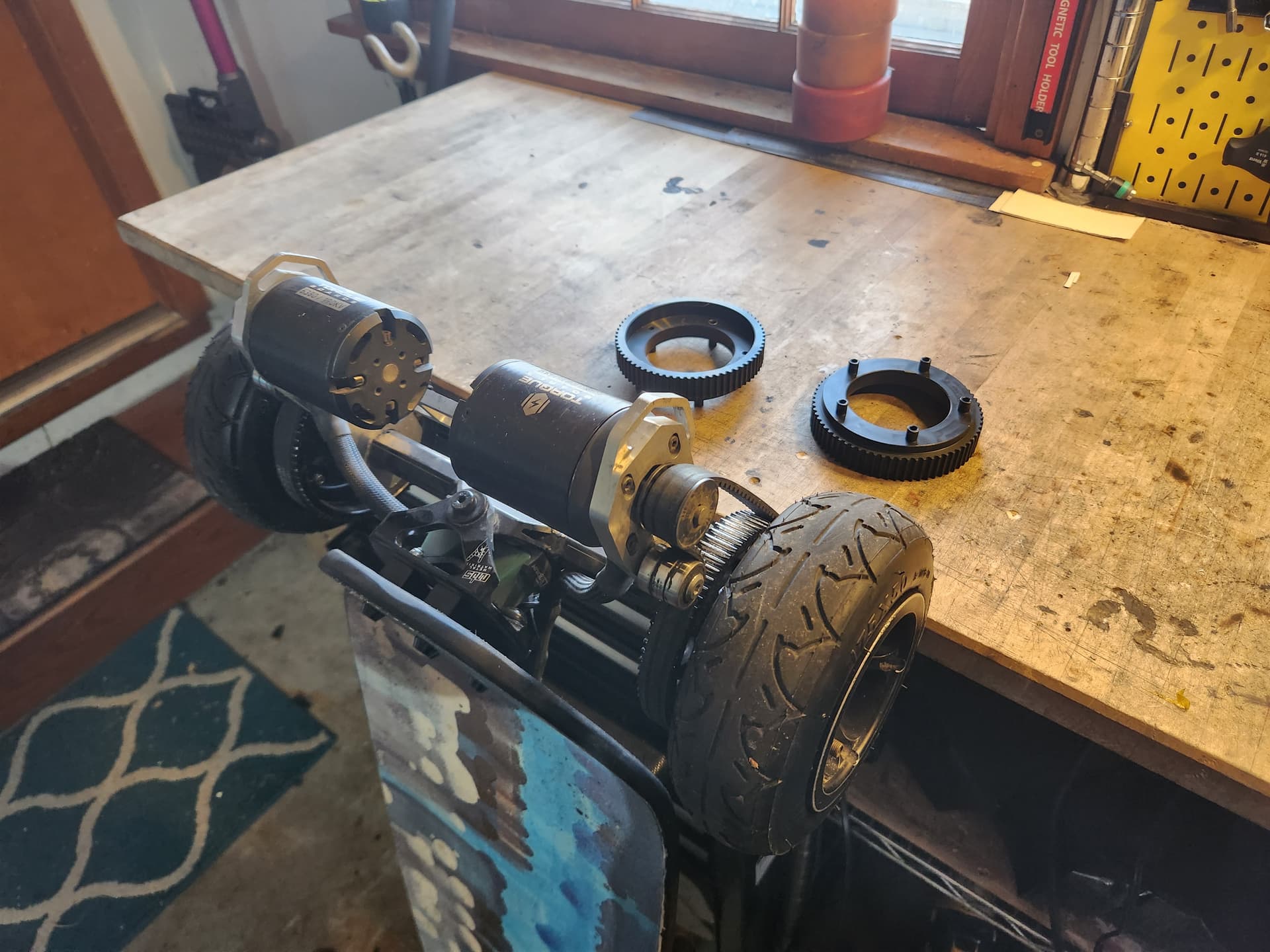

First I am changing the Flux from 16/72 to 16/68 with the EBS pulleys.
To slightly bump up speed with the 7s.
My pulley changing plans almost got derailed…
Because low and behold, I did not have the right length belts… Blows my mind.
But the IdeaTB mounts allow the idlers to me moved and I was able to make it work out.
This is a fairly small change.
But I wanted to do it anyways.
One thing that was cool is that the height away from the hub is about the same between the EBS and LaCroix mounts.
I got the LaCroix pulleys used. And the dude that had them must have ridden hella gravel because of how chewed up they are…

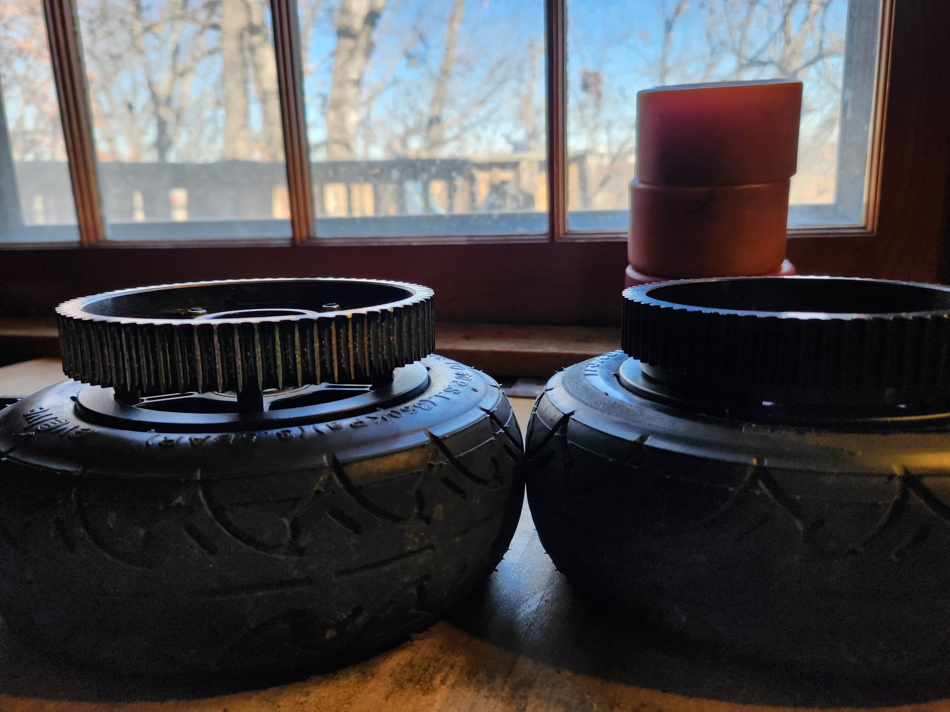

I am going low on the PSI for the evolve 7s.
Gonna do about 20 in the back and 15 up front.

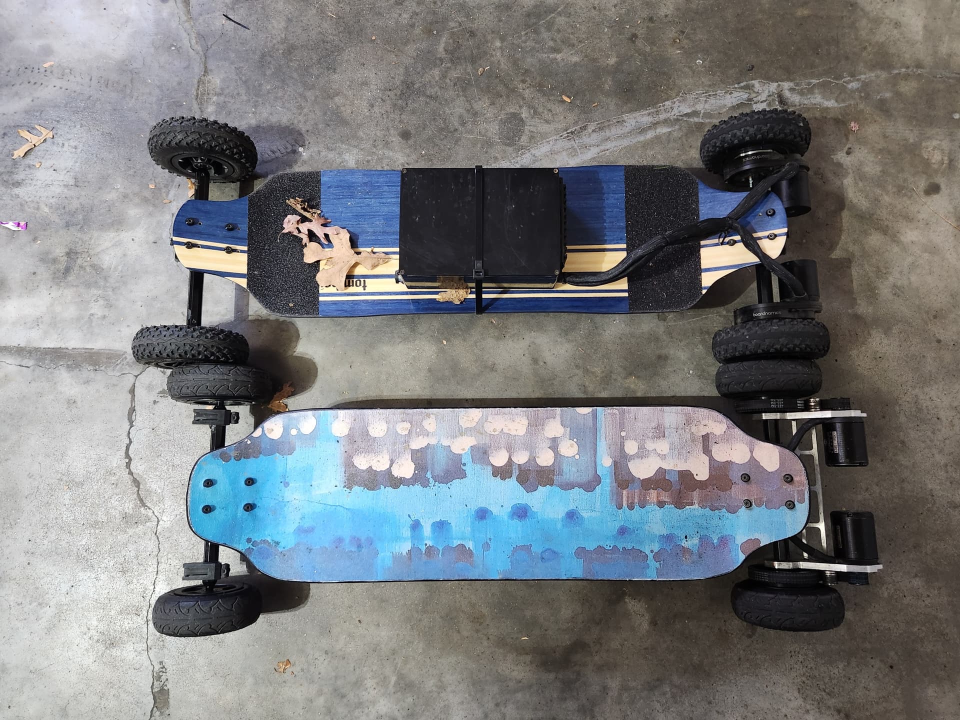

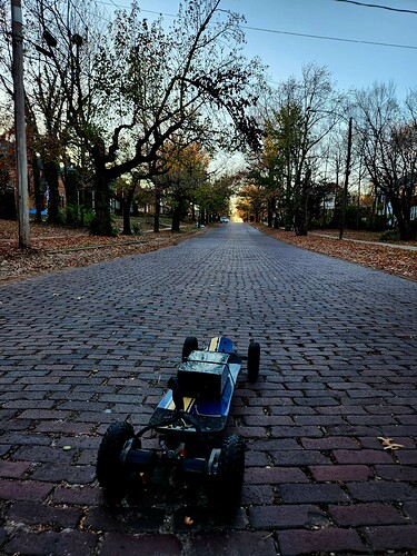

Then I went to get on the Gravel Boi.
And only did about 1.5 miles…
Definitely felt weird to turn

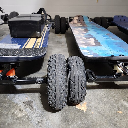

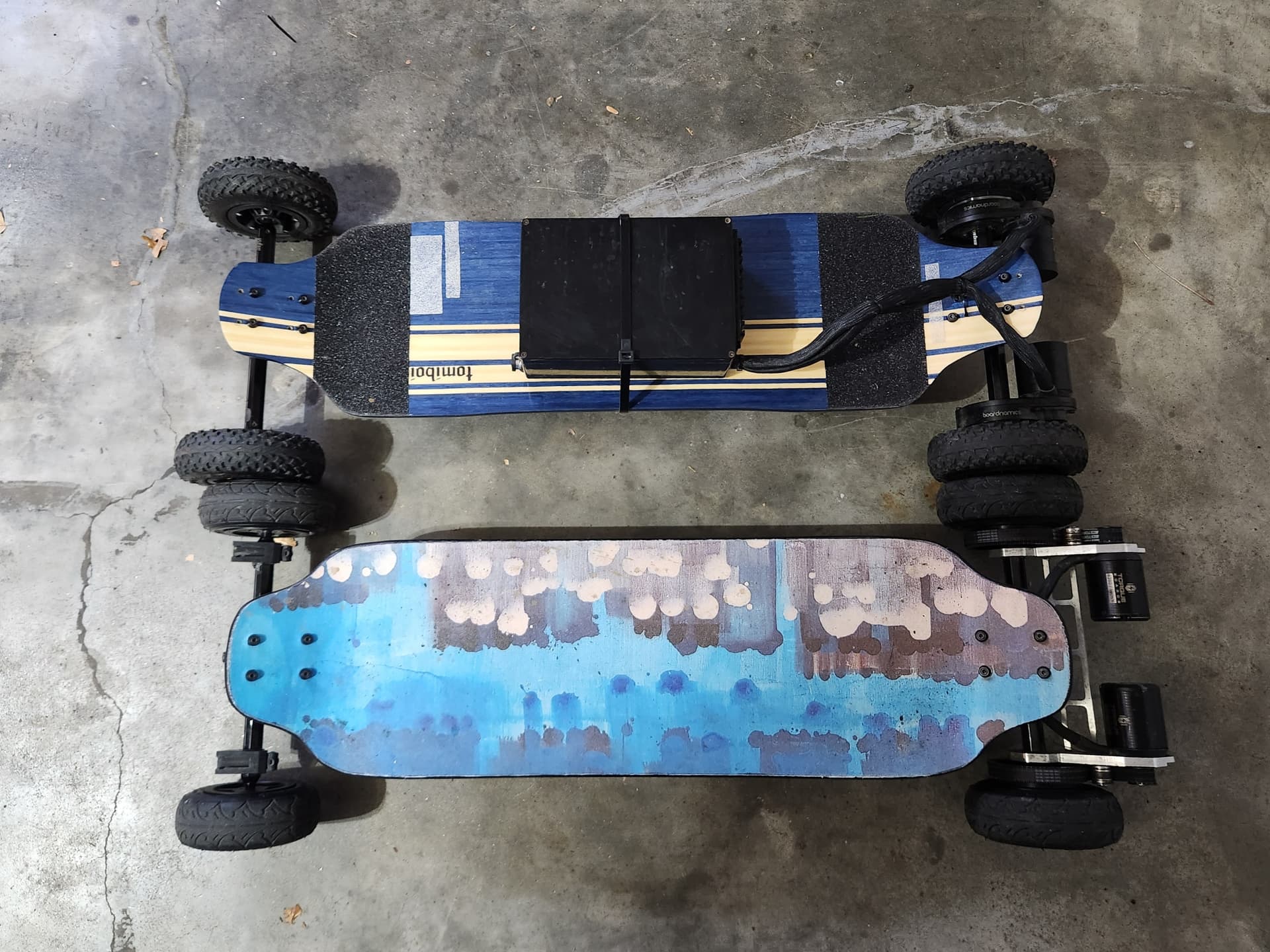

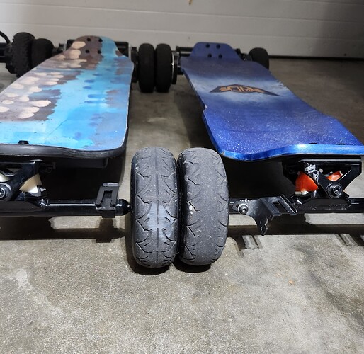

I brought it back to change the wheel base.
It’s quite a bit longer than the Flux on the outer holes.
That has to have a big impact on how it turns.
I do have different bushings on… But it was really different.
So onto the inner holes of the Tomiboi.
Much to my surprise. This is still a longer wheel base than the Flux.
Just barely now… But still.
So I am about to go try that out.

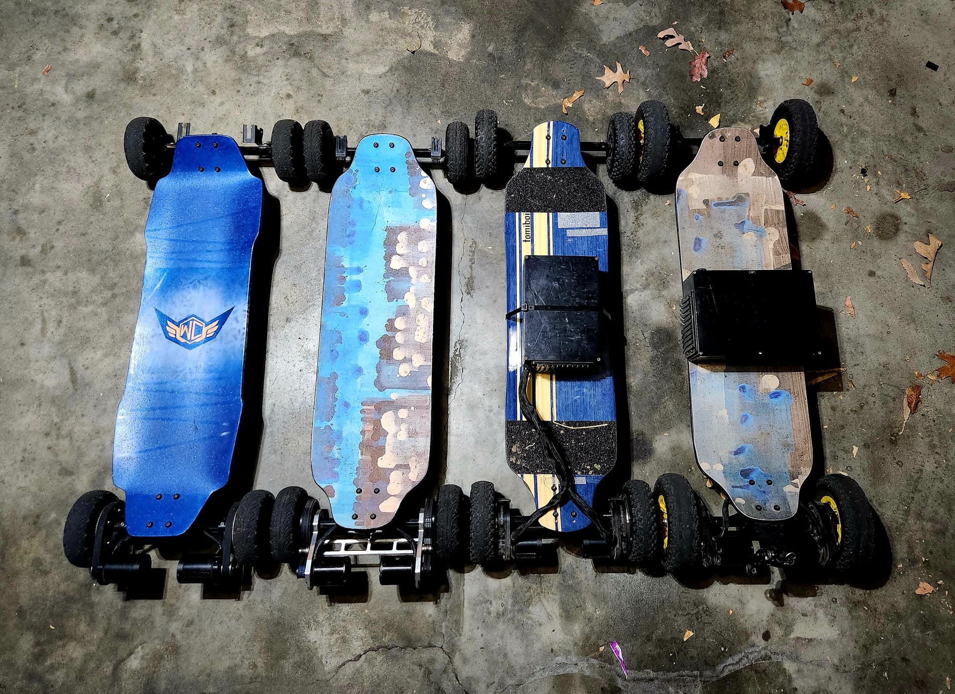

So I did ride all the 4 boards with tires and stacked up 40 miles yesterday.
I went back out on the Gravel Boi and the inner holes is definitely where it’s at for me.
It made it way more familiar and the turning was pretty good.
I bet it will be a bit better with the Riptide Bushings…
The power delivery is really good. The BN drives were running smoothly. The were turning well.
I did 9.7 miles on it
Next up was the Khymera.
It’s on Evolve 7s like the Flux… And on MBS bushings like the Gravel Boi…
But it runs awesome.
The acceleration and speed are really smooth.
The wheels feel really smooth.
If I keep the ride under 10 miles this board is pretty much perfect.
The turning is a different vibe than the Flux because of the wings. My feet are more in the center of the deck. They are pretty different to turn really…
But I am feeling good on both.
I think the split angles help.
I do expect the Khymera will be Even better with the riptide bushings.
I think I’ll put the 3rd set that will be here soon on the Gravel Boi first though… And when I get Matrix III for it I will take the Riptides over to the Khymera.
I did 9 glorious miles on the Khymera.

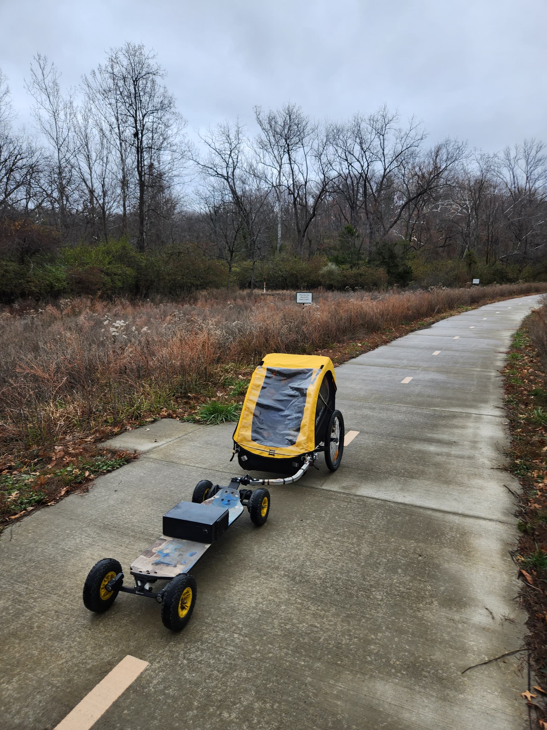

I took the boys out for a ride to mellow them out and ended up doing 10 miles.
The Gravel Flux is Crushing it as far as towing goes.
Great control with the NewBee 4GS gears.

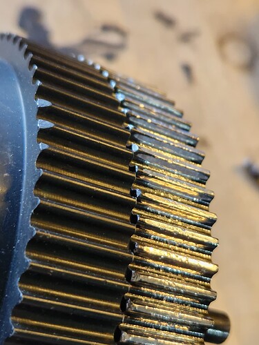

I only got a couple miles out because the BN drives had a new weird noise going on… So I had to turn around.
So I went back home and jumped on the GT that also does fine on wet roads.
I opened up the BN gears later and it’s not totally clear what the issue was. Maybe the keyway had gotten loose again and just started rubbing. But there were no metal shavings or anything.
Either way. I am over messing with them.
The few rides I had on the Gravel Boi they rolled and felt great. But I can’t seem to keep them together.
So I ordered a set of NewBee 4GS gears to go on here…

I made a small change to the Flux.
Now that I am running 7s and running 16/68 I thought I may be able to run the belt without the idlers.
I have used the idlers on the IdeaTB mounts on the Flux this whole time with no issues. Ran well with 14/72.
Had some issues with 15/72…weird right
And ran well with 16/72 and 16/68
But hey. idlers are extra parts. I have weird vibrations on the Flux.
I’d thought I’d take them out of the equation.
I went and did a 6 mile Sunset ride and the board felt good.
No issues with skipping.
Maybe it was a bit smoother… Not sure.
So I think I will keep it that way for now.

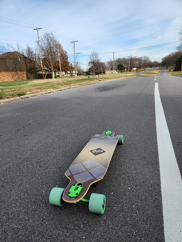

After that I tooled around in front of the house and rode a bunch of boards for short bursts around the neighborhood.
The Rayne Crush is super good.
The Rally Cat is super good too…
Holy Akashas batman!!! They transformed this set up into something so good.
And finally I ripped around on the Dinghy which is a real delight.
Digging the real skateboard vibes.
