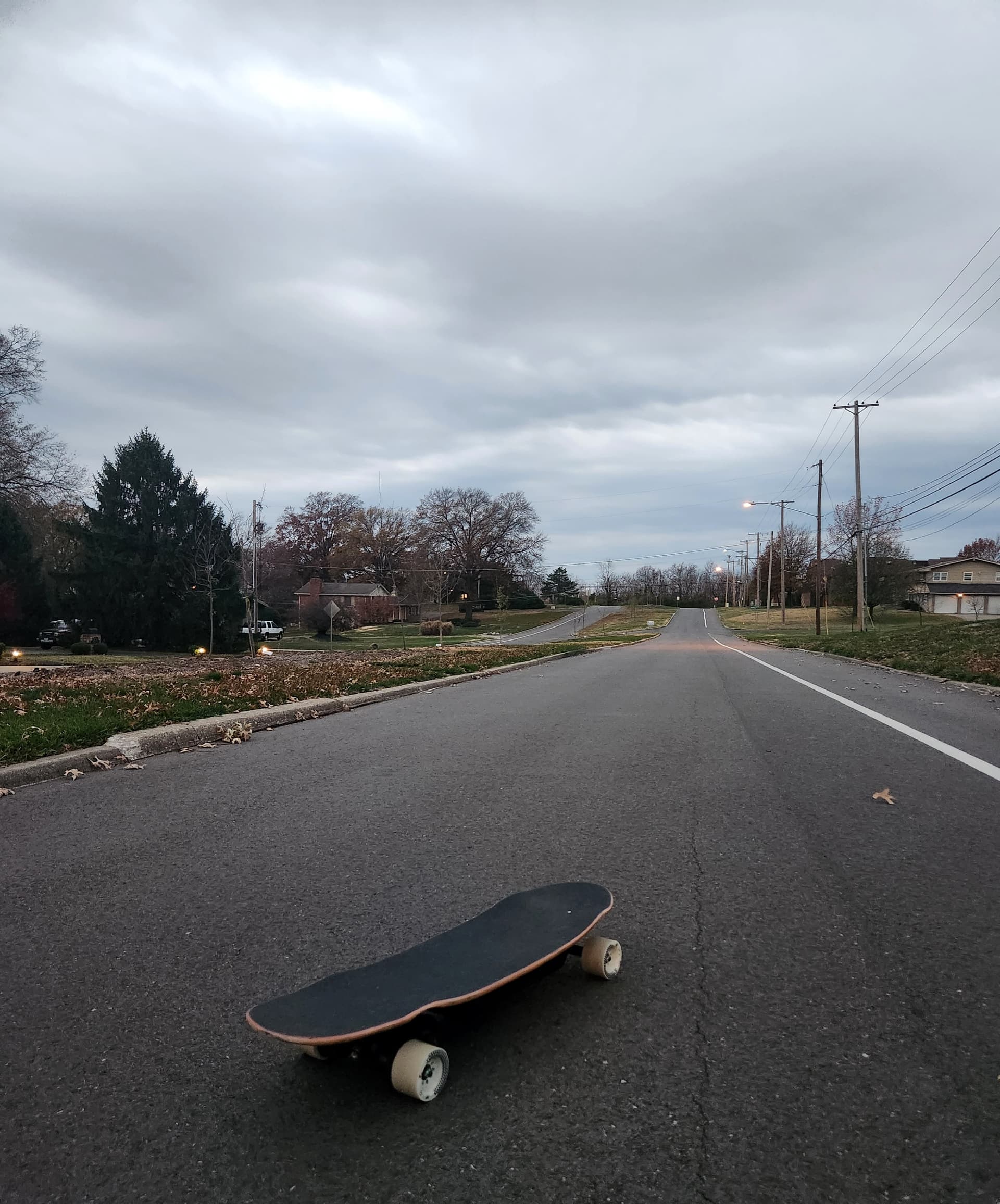

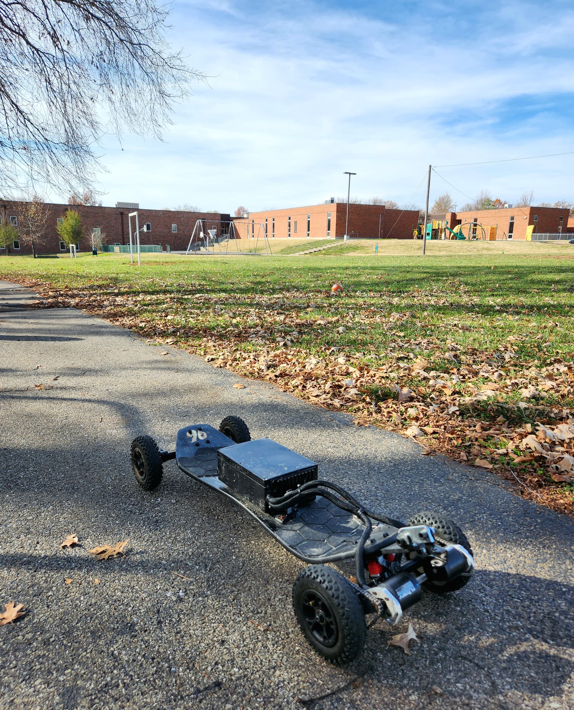

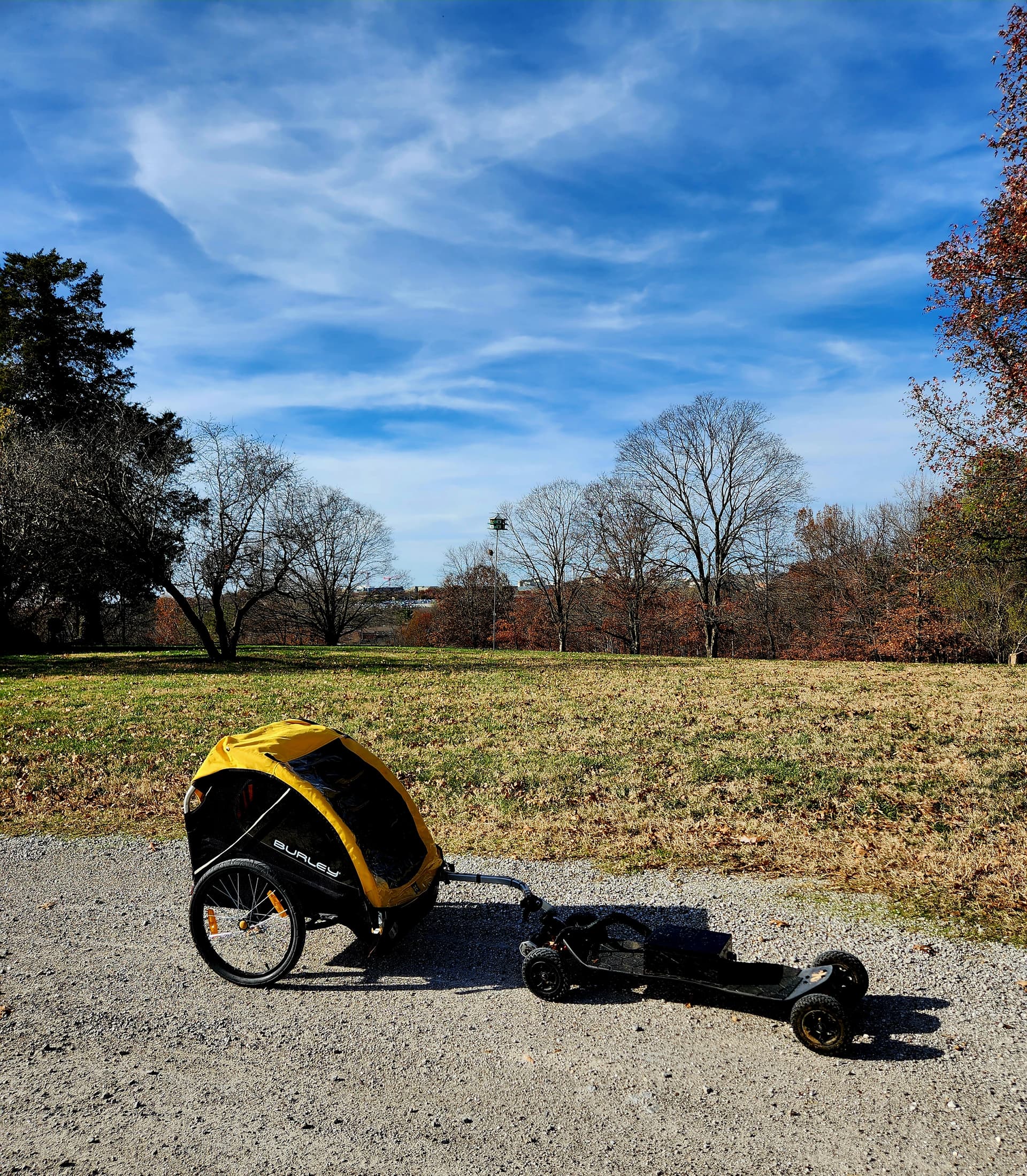

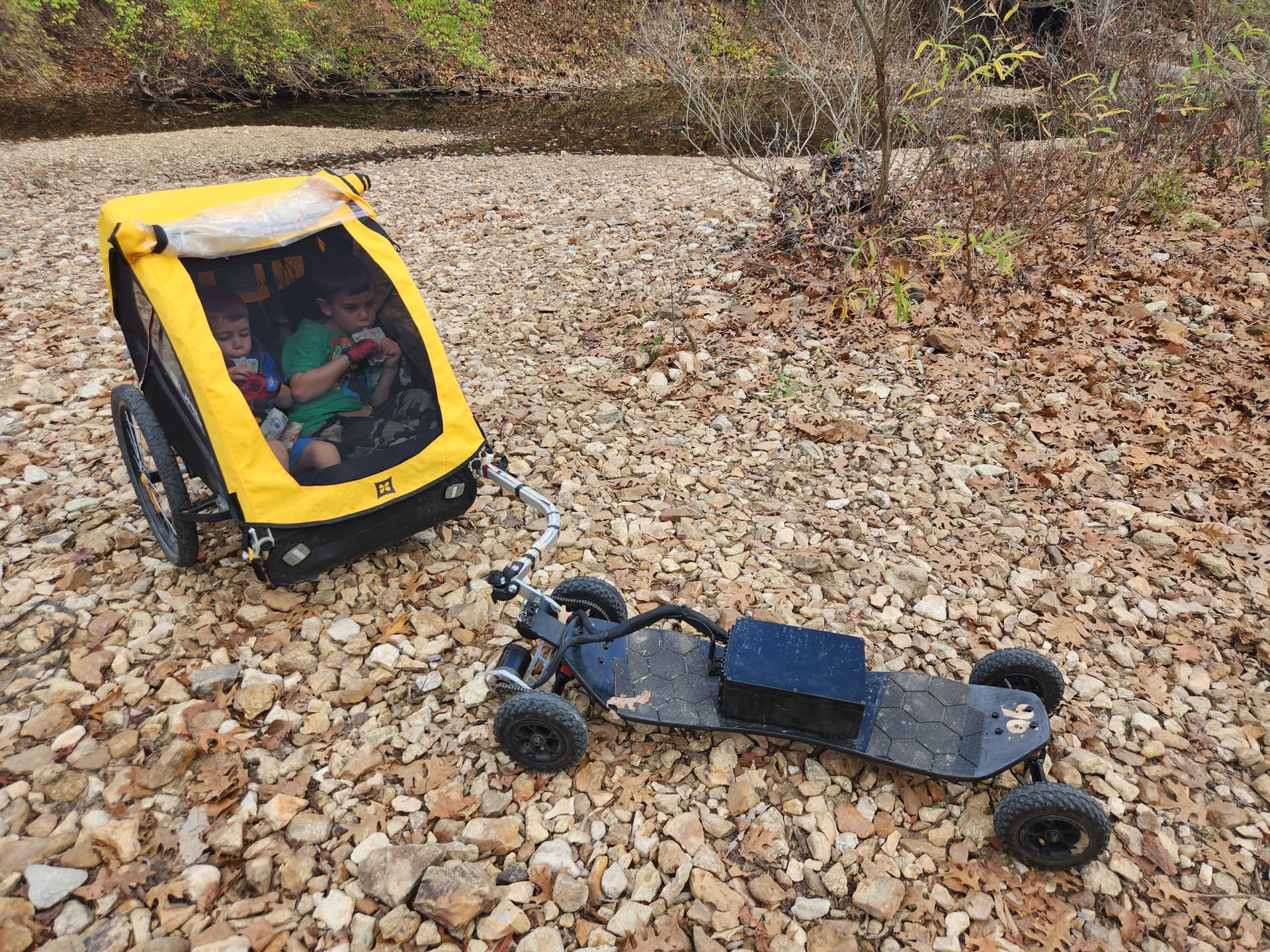

So the funny thing about me working on the Haero last night is that I wanted to get it ready to tow to be able to pick up the kids from school…
But they did not have school today.
I took the boys out on the trailer for the Mayden Voyage of the Tow-Haero.
And it worked.
And I tooled around on the playground riding on a bunch of bumpy grass and it did fine.
20221107_133750_1
I set the Haero up for torque and the chain mostly works.
So it towed fine.
Tooling around on the playground was fun.
I didn’t fall so that is always good.
The performance of the Haero is great.
I am just not happy with the trucks or the deck and truck combo…
Maybe don’t try to ride Mountain Board decks without bindings and hope for something magical.
But it breaks my heart.
It’s such a cool looking set up.
But I think I need to do something different.

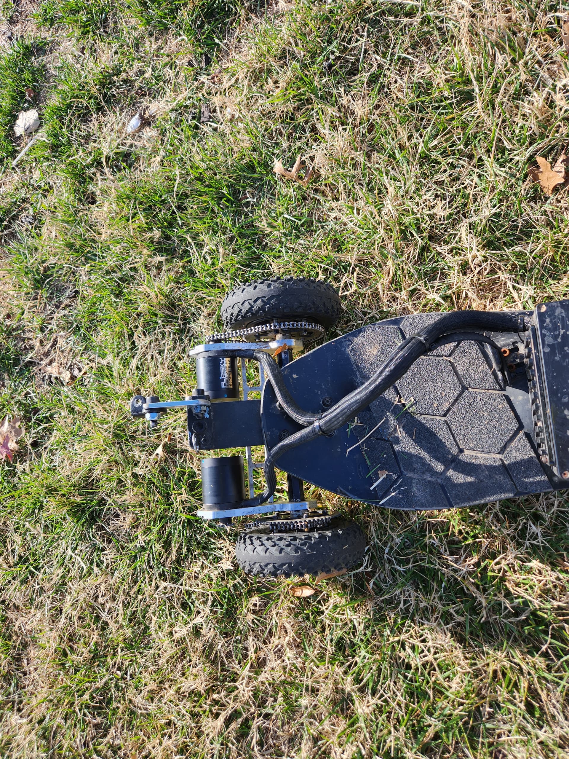

A couple of annoyances popped up as well.
Chain came off while riding on grass…

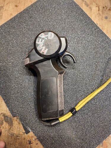

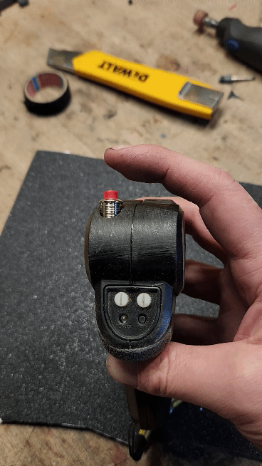

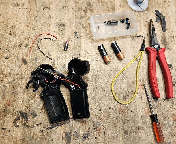

And the freaking power button on the mini broke… So I can’t turn it off…
So I need to crack that open. I was not planning on a Z.mote from the second wave for the Haero…

Would you like to try a wider version? Maybe 80mm?
Yeppers!!!
Well fuck!!!

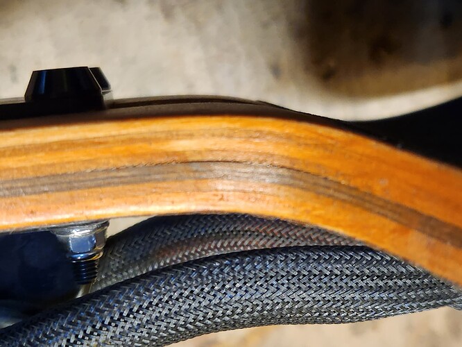

Is the deck delaminating?
Have you tried just a single binding?

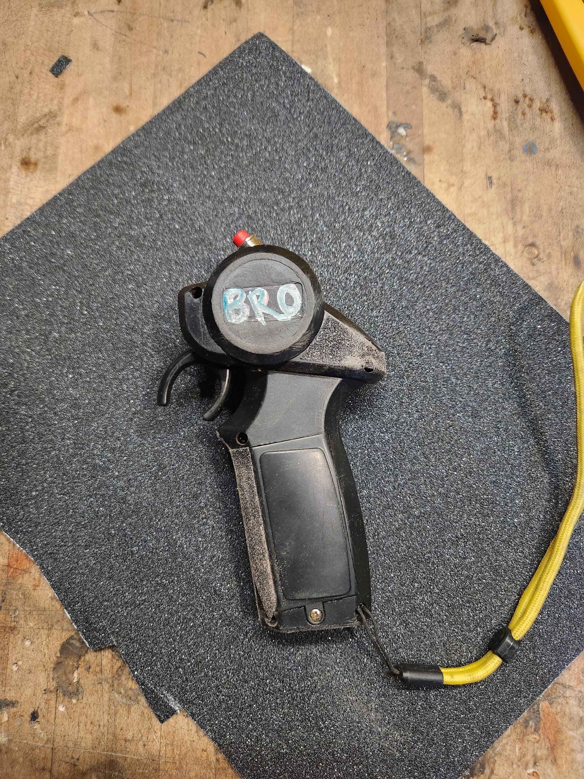

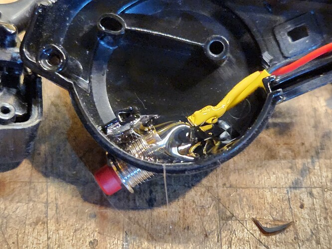

I did a tiny bit of tinkering and got the Haero remote going.
I Drop some solder to short the switch.
Drill a hole on the top and put the new little switch into it and hot glue.
Then hook the switch wires to one of the battery wires.
Easy breezy.
And I like to add Jessup grip tape for better hold.
The switch works really well.
It is easy to click with gloves on. And generally turning the remote on and off on the go is super easy.
It can. Be a little sketchy in a pocket and it’s possible to click it on by accident.

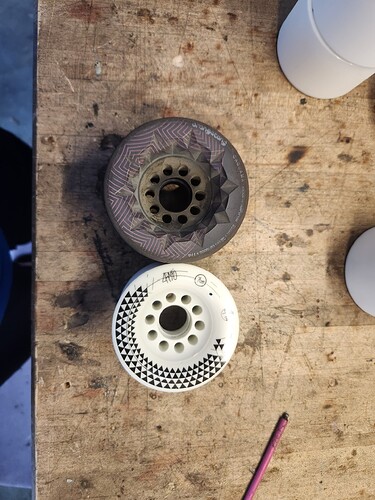

Something pretty special came together today.

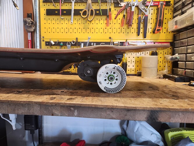

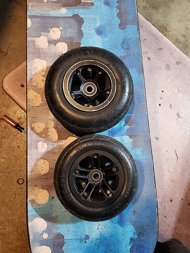

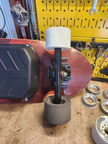

The 76mm Ahmyo Akashas FR went onto the Rally Cat.
Not too long ago I got the DH Akashas that you can still get direct from Ahmyo.
And I had them on the Omakase and then the Demonseed DKP.
And they are nothing short of magical.

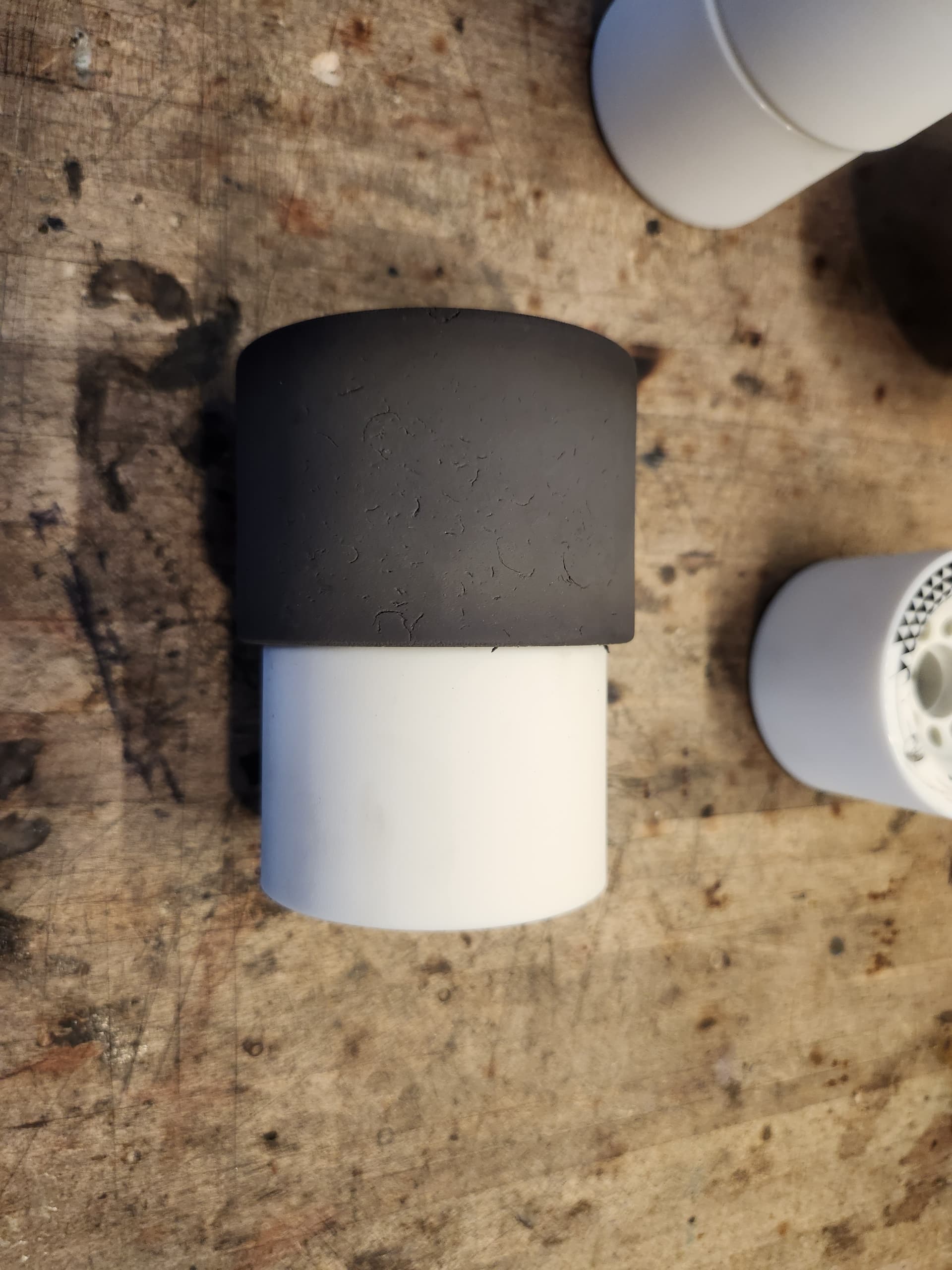

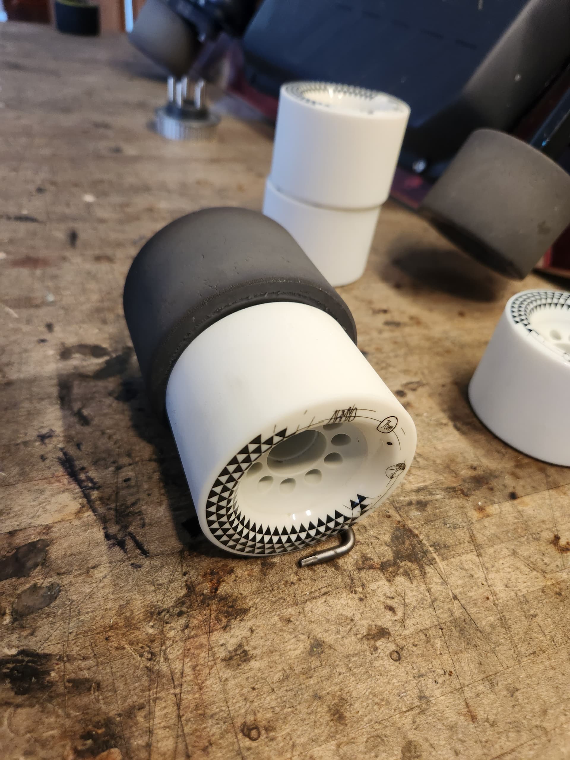

@Razillian hooked me up with the FR ones that are narrower and unobtanium.
And they are officially my smallest esk8 wheels.
Here they are next to the Caguamas.
That up until recently I thought were the most magical wheels.
I decided to slap these on the Rally Cat because it did not quite feel right.
I wanted a more plush ride with it and used Caguamas instead of Kegels… But that made it too clunky.
I also loosened up the bushing set up.
It looks amazing to me.
And I got to take it out after work.
And yeah.
This is what this board needed.
These tiny wheels were such a big change for this set up and it just turned out so good.
I didn’t leave the neighborhood and go on really rough routes…
But this is another set up to go and chase freshies with and for that it’s glorious.

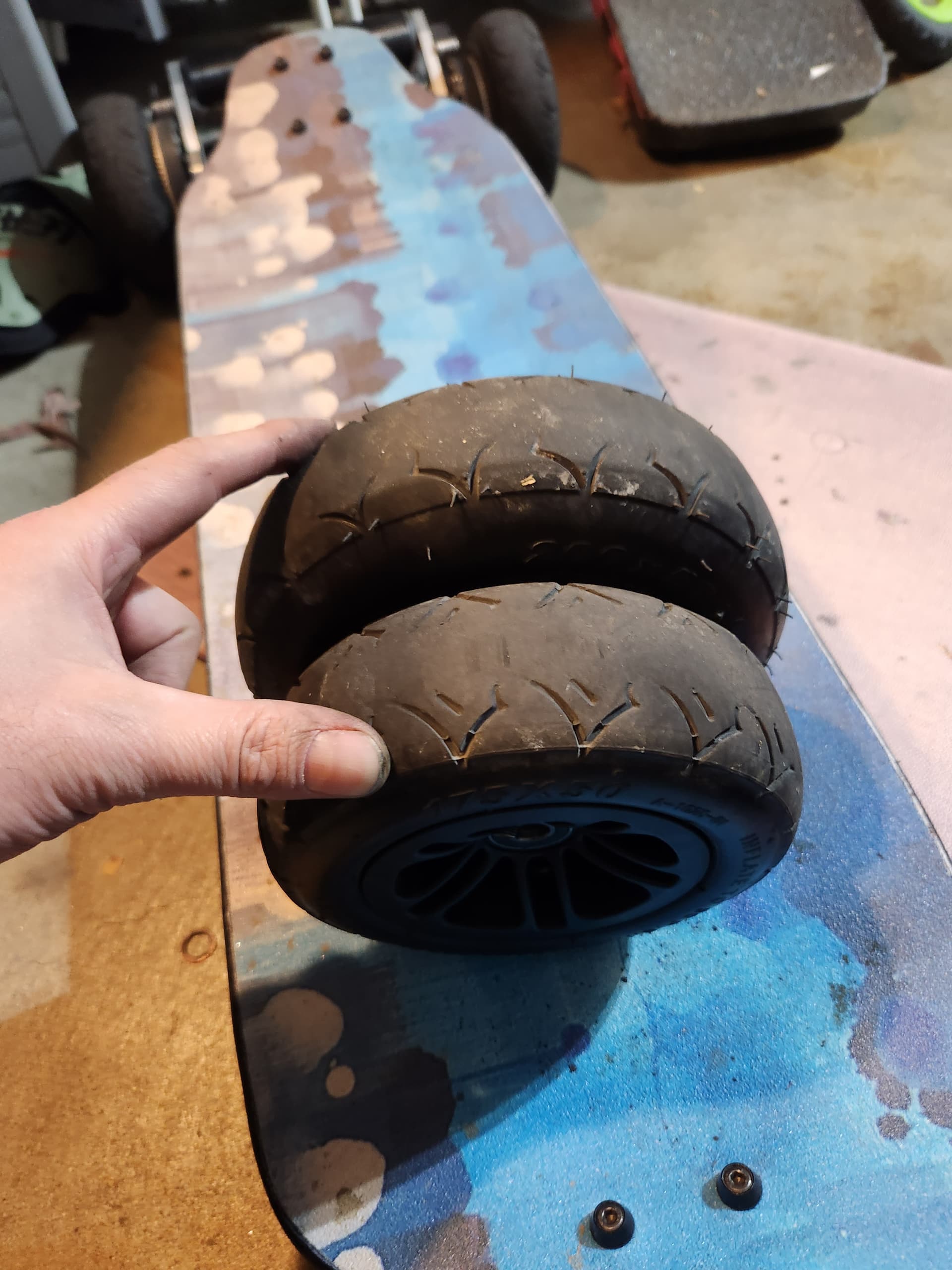

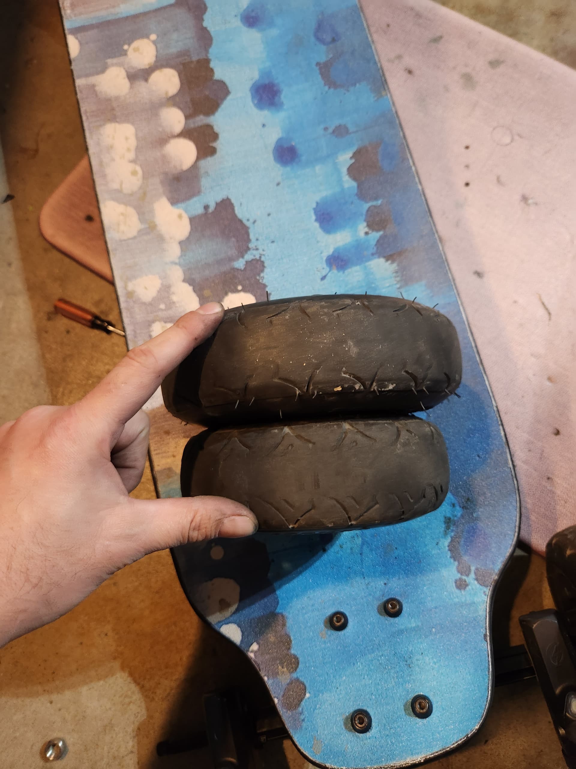

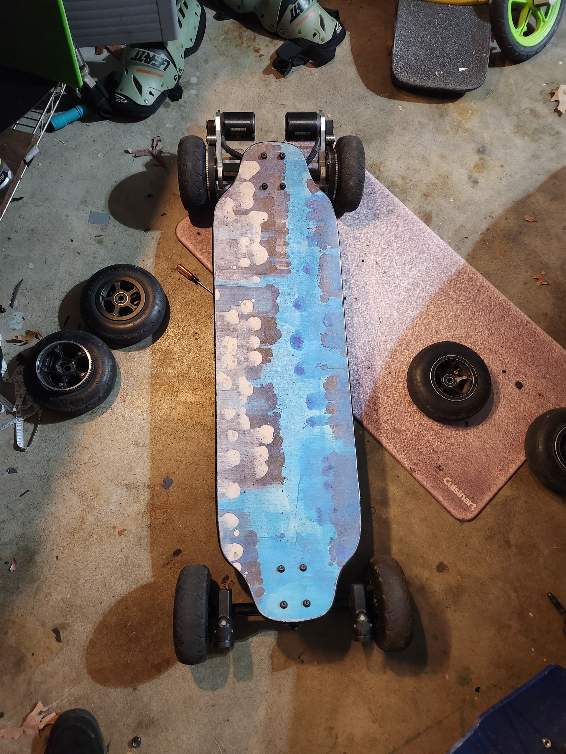

And I decided to slap the 7 inch tires from the Khymera on the Flux.
You guys know I love the Flux. And I have been quite happy with Kendas.
I have had some wobbly ones here and there, but the ones on here now are good.
But I have been wanting to try new tires.
I want to try the Trampa 9 inch roadies Skyart had on the board he was selling.
I love the 9inch mbs on the Gravel Flux…
But that is a bunch of money…
I have long pondered 7s. And today I just took them out of the Khymera and slapped them on.
Took only 6 minutes to get the 7s on the Flux.
And then I went out in the cold and did 8 miles.
And there was nothing I did not like.
I think the 7s ran smoother than the 8s.
I liked how the board behaved turning wise.
But what I liked the best was the added torque going from 200 to 175 takes off 4-5 miles of theoretical top speed, but it was a delightful added punch in torque.
And I think I will enjoy the torque more than the top end.
I gotta give this concept some more action and see if I stick with the 7s.
