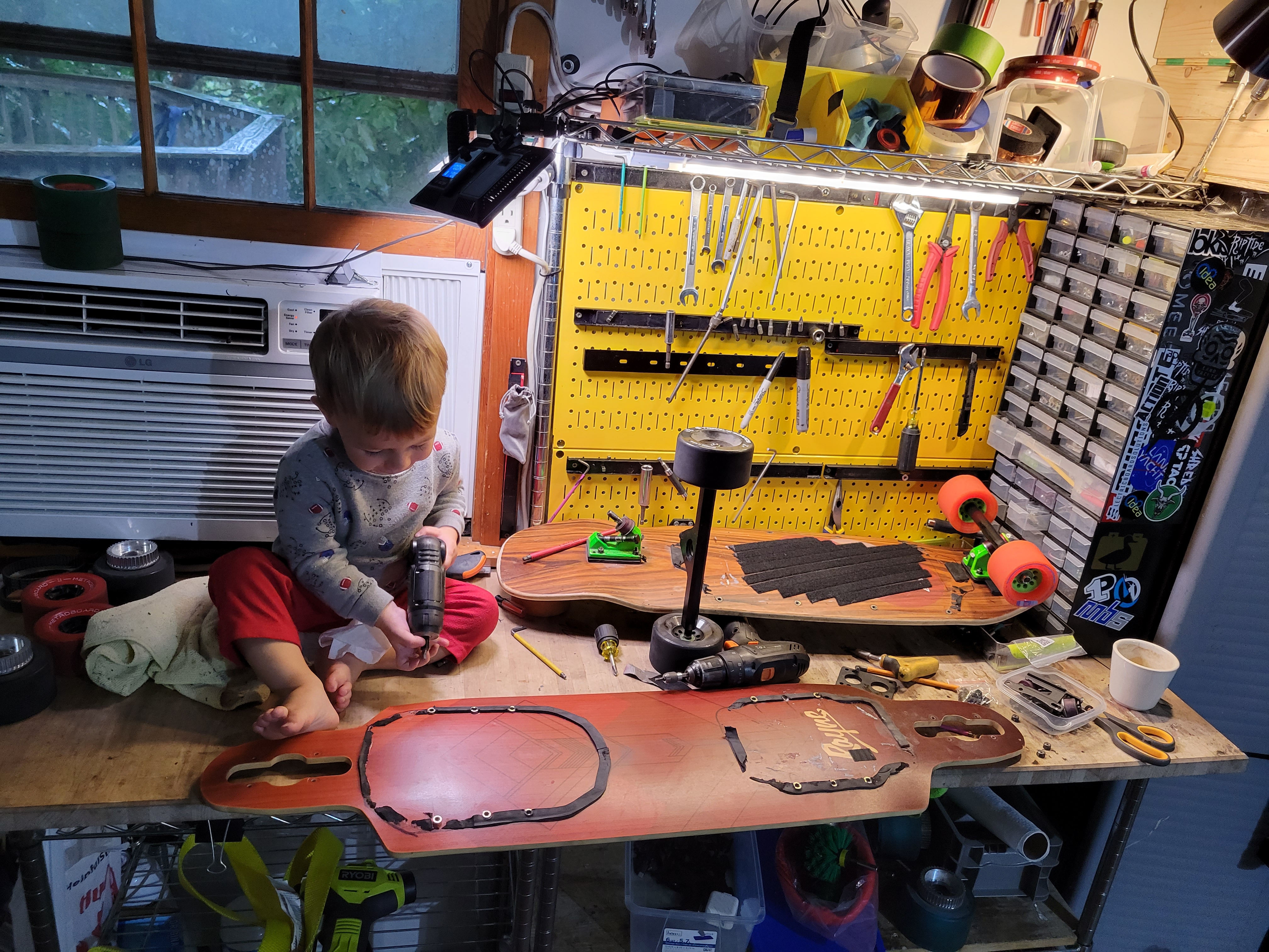

he spends a lot of time on the bench putting in work.
and demands to go up there every day…
reorganized the bench and cleaned up the garage wall a bit today.
going to all magnets and no more hanging hooks.

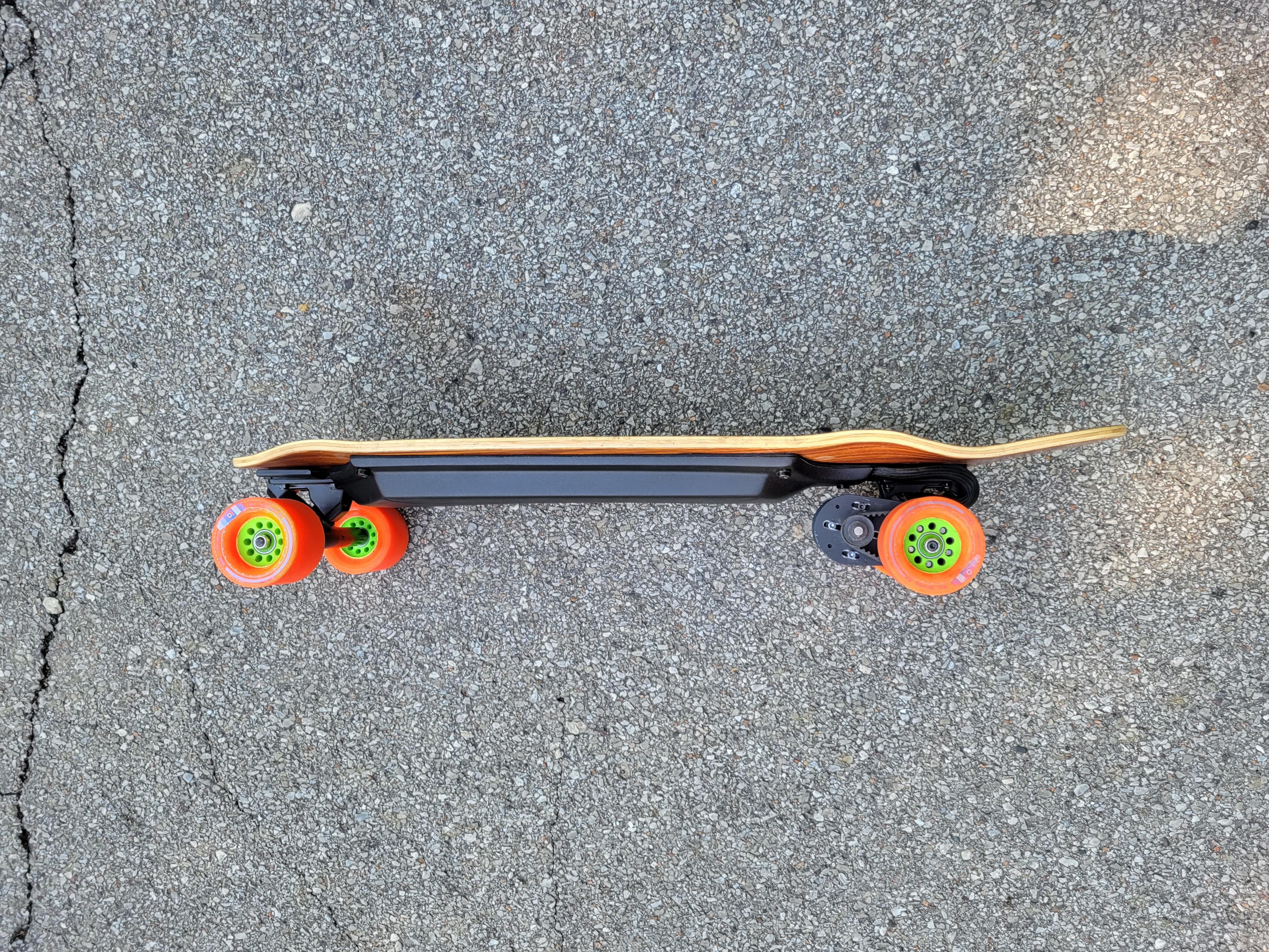

couple upgrades for the Omakase.
going from BN 184 to super special BN 170 in the back…
the space between the motors drove me bananas…
so got rid of that.
that part went super smoothly…
totally worth the time and money to go from the wheels being 29.5 cm wide to 28 cm wide.

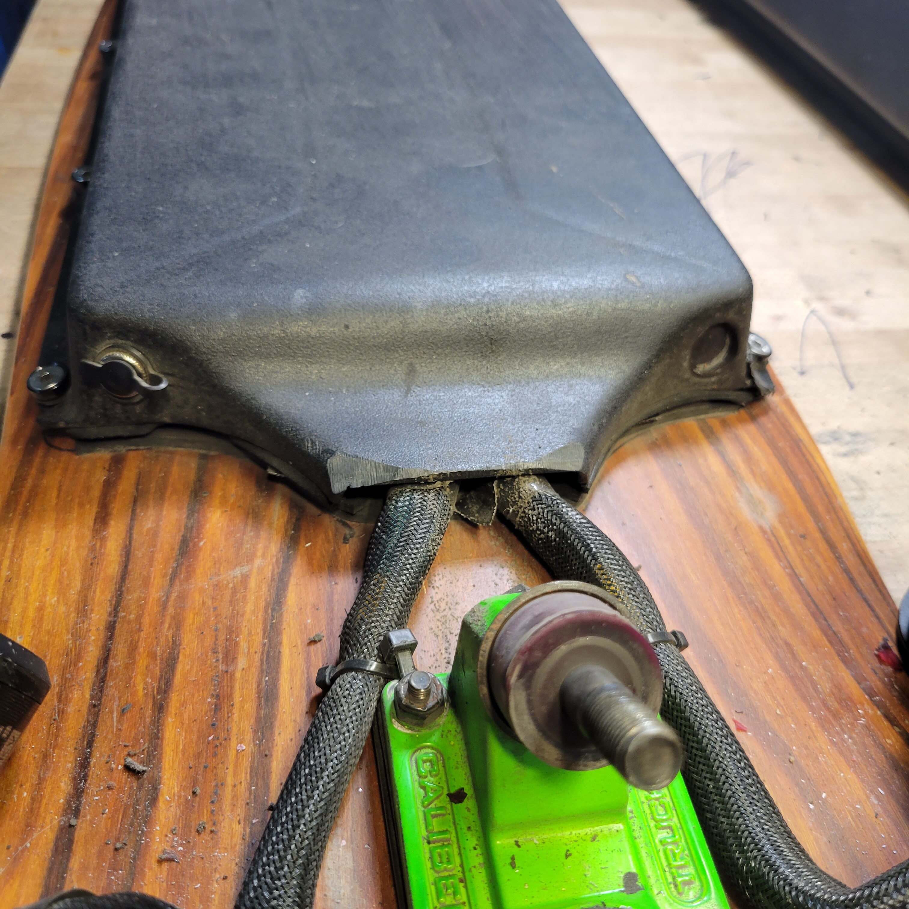

here it is interesting to see how much the motors were rubbing on the enclosure.
the main upgrade I am really hoping to accomplish is adding the Eboosted Tayto enclosure to replace the now broken BKB enclosure.

I WAS pretty happy with 29 cm on My Deadly Sin. Damn you and your tiny trucks!
Good luck with the new enclosure, hope it clears up the motor bite. I wound up moving my rear truck back rather than deal with a whole new enclosure

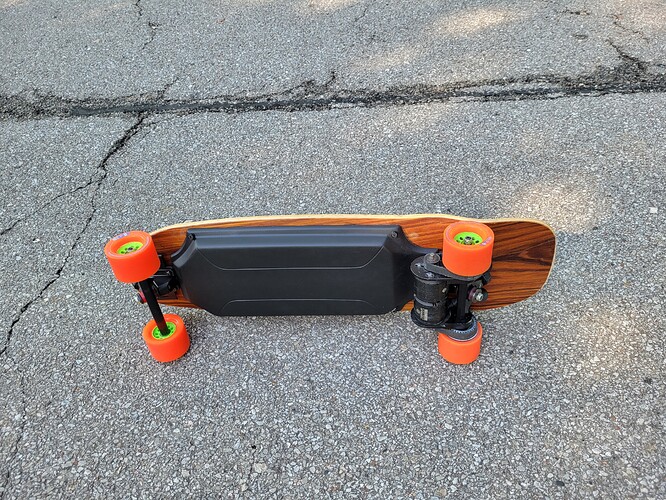

but the main goal was the Omakase.
and the Omakase is back and I am super happy with it.
recap on parts.
Omakase.
10S3P 40T
Unity running 23.64.
TB 6354 190kv motors.
old style Bkb mounts.
TB 218 baseplates.
caliber hanger in the front BN 170 hanger in the back.
14/36 on 80mm Orange Kegels.
and the Glorious new enclosure.

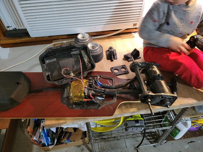

fist I took apart the Rayne Crush.
I am making a bunch of changes to it and I wanted to steal the baseplates for the Omakase.

I actually stripped the Omakase all the way down as well.

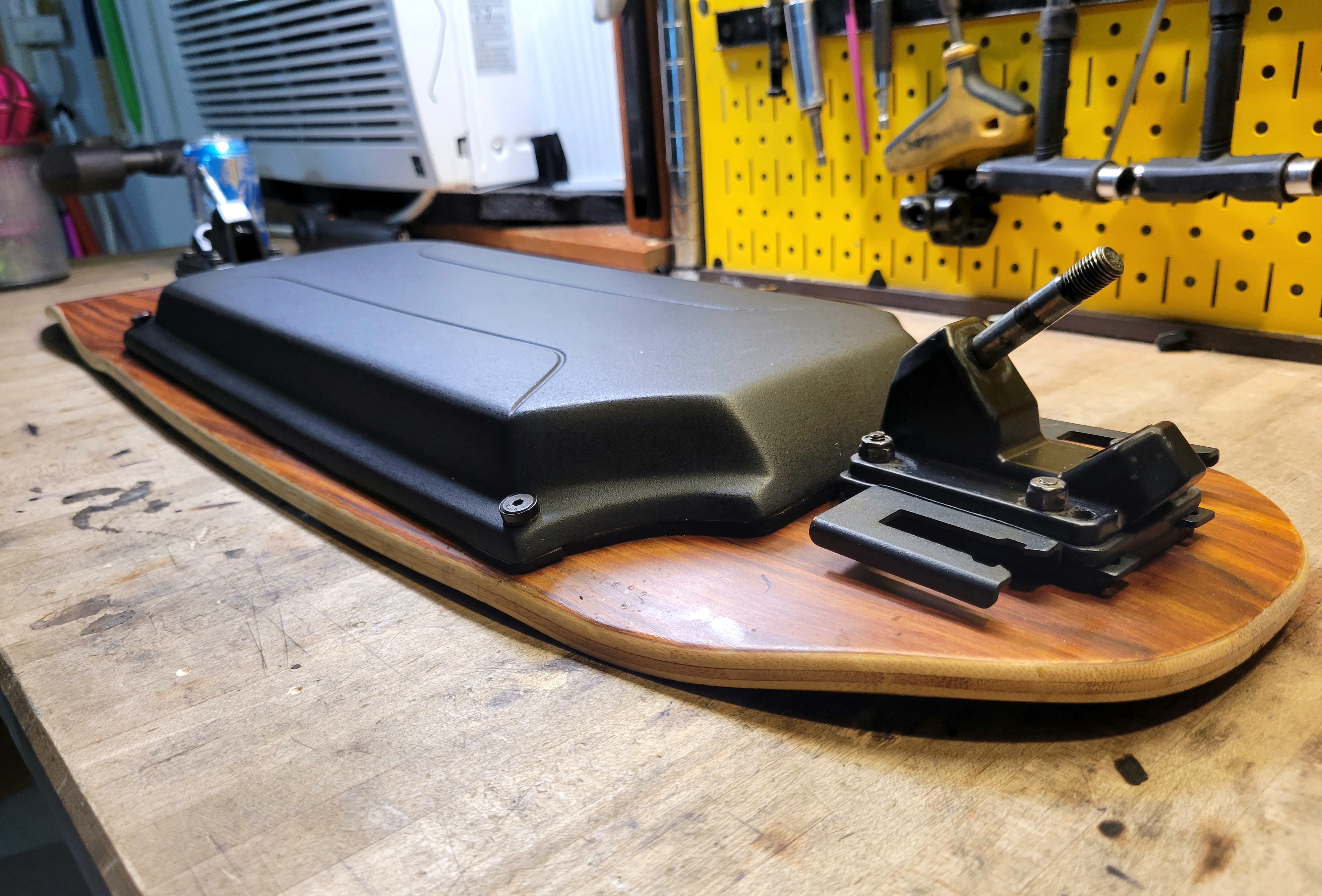

I love this enclosure from Eboosted.
it is such an incredibly nice part.
it is not meant for the Omakase… but to me it sure is close enough.
so new inserts go in…
only doing 5 bolts. I am sure it will be ok.
so the enclosure addition went well.
now I just needed to slap it all together.
flipped the battery around and tucked the Daly up front and did extensions for the battery wires and charge wires.
I have been doing this on the few recent set ups.
along with the usual foam strip on the edge of the enclosure I put a strip of butyl tape on the inner half of the foam.
it makes me feel good…
and hopefully does a bit of keeping crap out.
then it all went together beautifully
I am just so happy about how this looks.
I have not gone on a full ride. but did ride it around a bit this morning in front of the house and it is pure goodness.

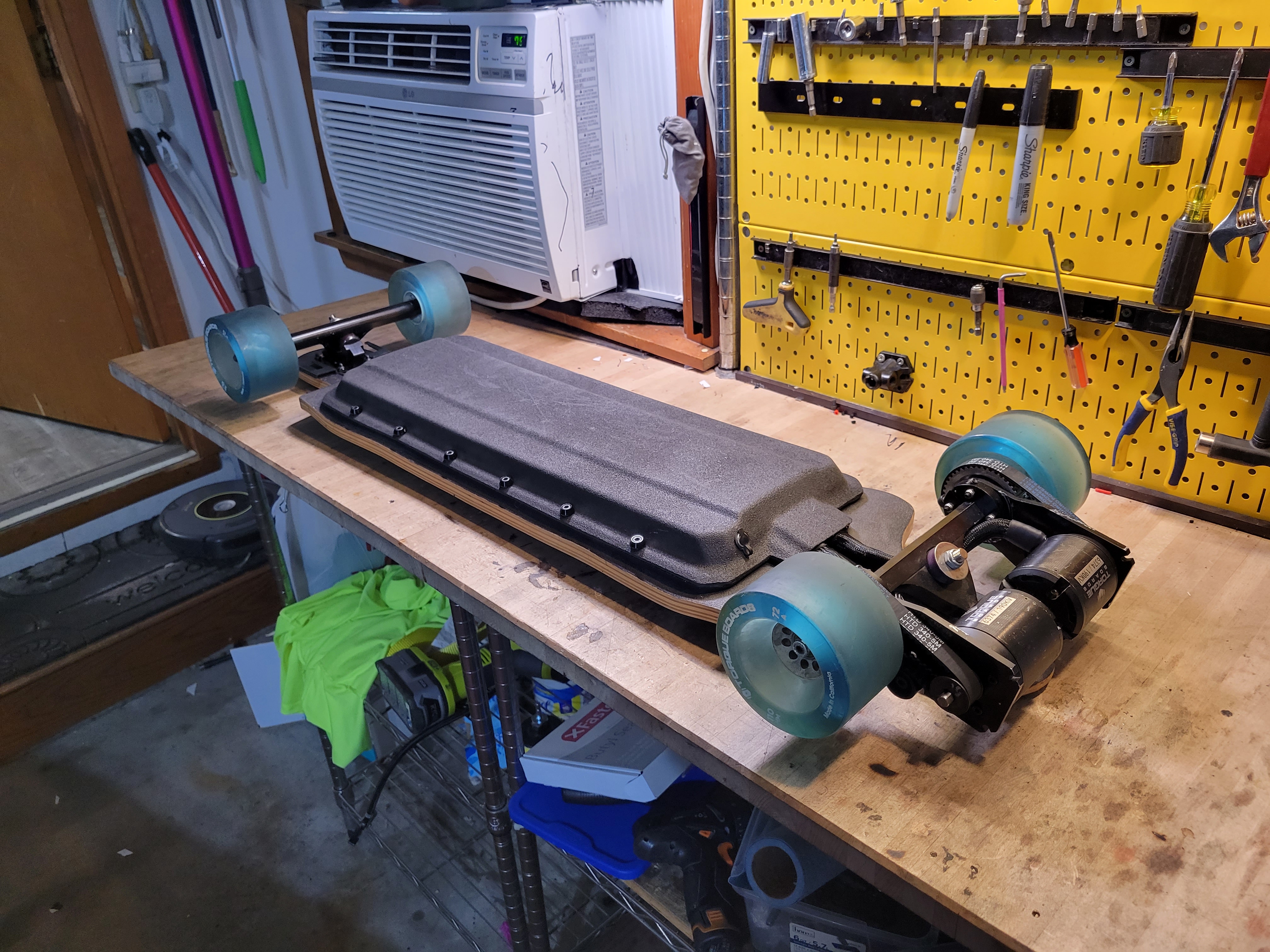

so off we went tonight and I worked on the Demonseed.
the drive train was done and the electronics had been hooked up…
so I just needed to tape down the sensor wires and put some gasketing on the enclosure.
going a bit thicker than I usually do with 3/8 foam strip… I think I had used a 1/4 before and it wasnt great with the step in the concave there.
did the thing with the butyl tape again.
and then 12 enclosure screws later it was good to go…
the gasket looks ok…
whatever … I just need to get the dang eboosted enclosure… quit fucking around…
so the Demonseed is back.

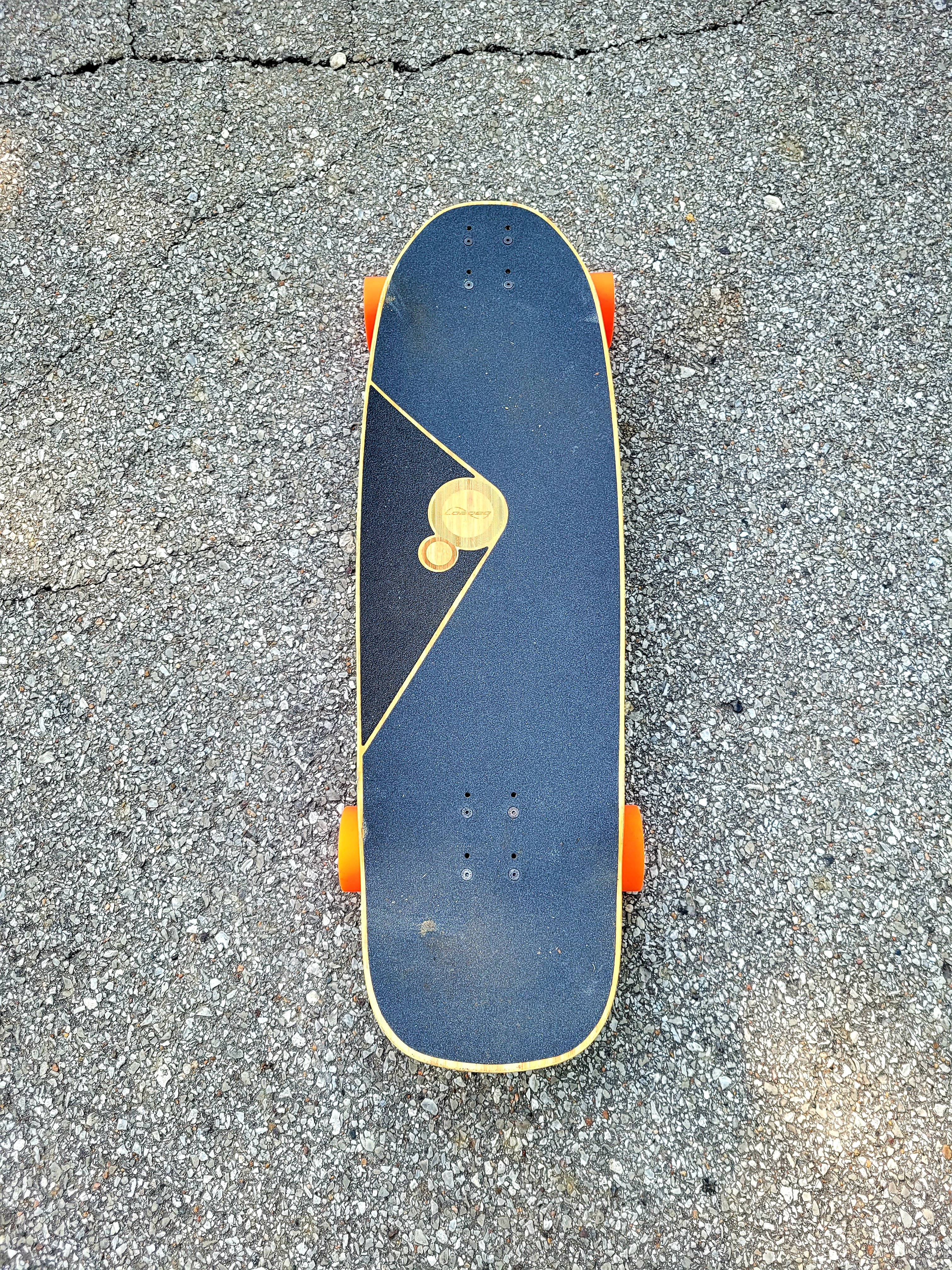

Got the Vision Old Ghost going.
it really looks a lot like the Ditch Life.
I think the Vision may be a tiny bit shorter and a tiny bit wider.
I think it has more concave.
the wheelbase on the vision is longer since I modified it
I just rode it around in front of the house.
but it felt good.
the concave is nice.
it is not as easy to pop up as the Ditch Life.
I think it is going to be a keeper.
