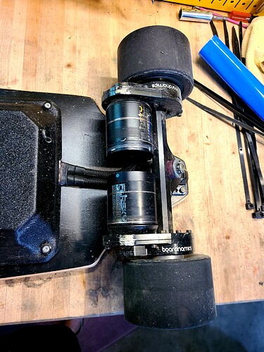

So in comes the BN adjustable baseplate.
Nice parts.
I checked it on a pair of Paris trucks and it adds 16 mm of height…
So adjustable baseplates = crap ton of risers…
It makes the trouble I went through to get a used pair of calibers to get a 44 degree baseplate to put back here seem like it was an especially big waste of time…
Oh well.
So crap ton of risers vibes. I can point the motors down…
But also I can put in the TB 6380 170kV motors.
I could not do that with the Caliber Baseplate.
So that is cool.

I hope the next version of the Llama will just work… And I will be super pleased with the slight bump in torque from these motors and everything will seem like it was worth it.
